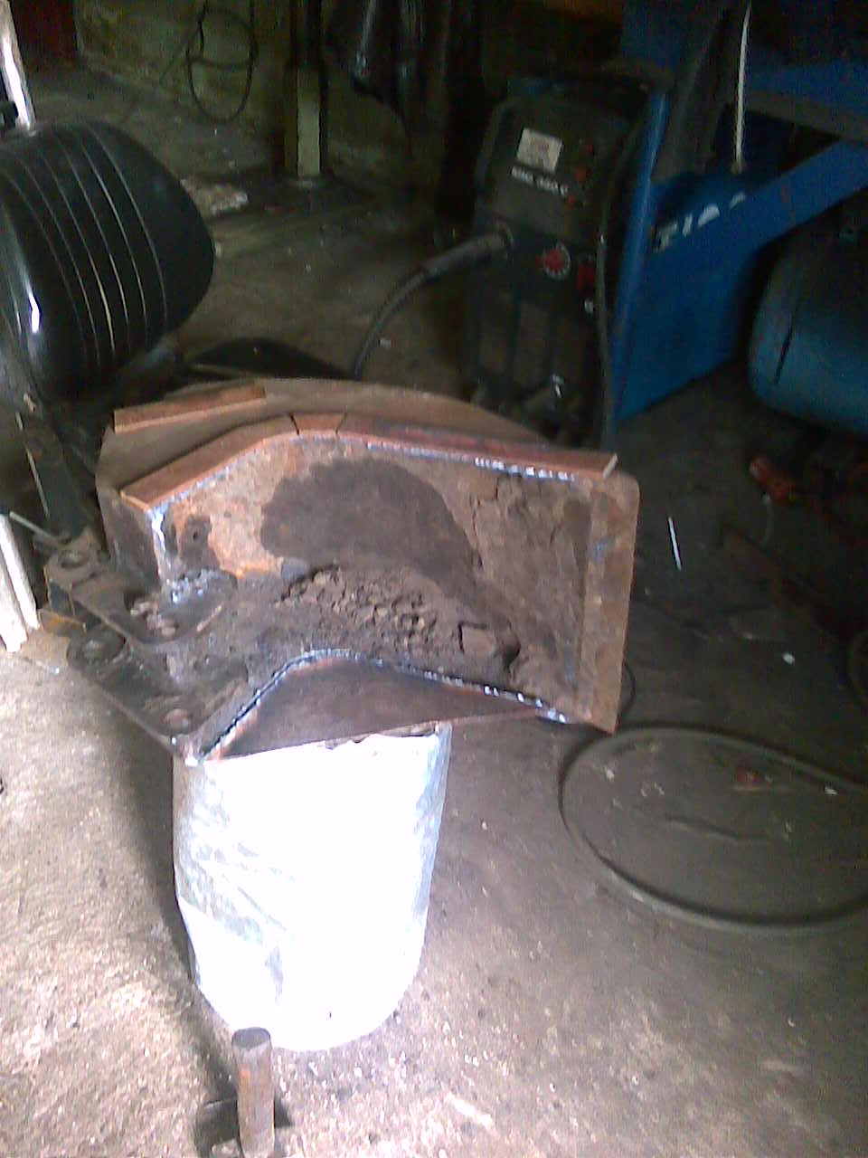

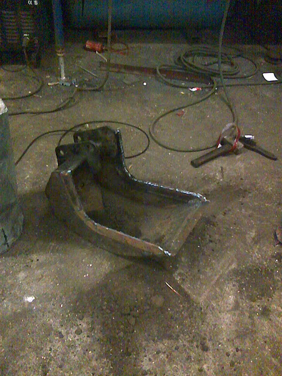

I made one of these small buckets few days ago. It's for a JCB mini excavator. Width is 22 cm and they will use it for trenching. I was worried that the wet clay could stick inside so I added a chain ejector, but it doesn't, it could work without it.
Because i now have a ditching bucket, which will be used for scooping loose dirt, i cut the sides out of my standard bucket to make a so-called banana bucket, its the standard trenching bucket in Holland. When the dirt is pulled out of a trench and the bucket is enclosed in the sides of the trench, you can scoop just as much on it as if it still had sides, but it empties a lot easier. (only when digging a big hole, the dirt boils around the bucket, but thats where the wide ditching bucket comes in) It also makes it easier to wedge it under tree stumps or concrete slabs, so you can use it as a prybar.
I brought back some meat by welding a strip of 40x5mm over the edge of the bucket. Still have to bevel it with the angle grinder to make it cut roots better, but i dont have any stump digging to do yet :)
