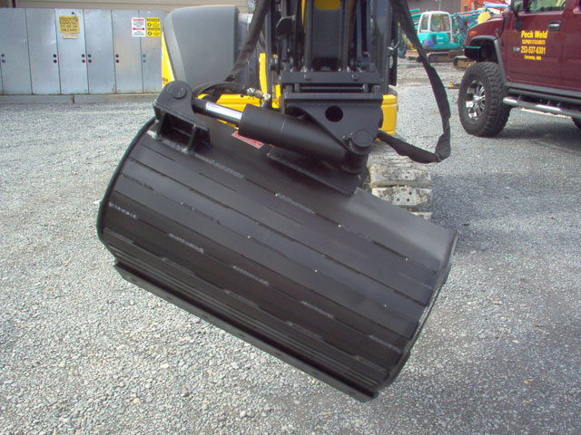

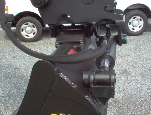

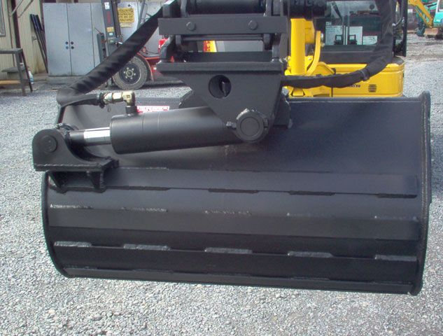

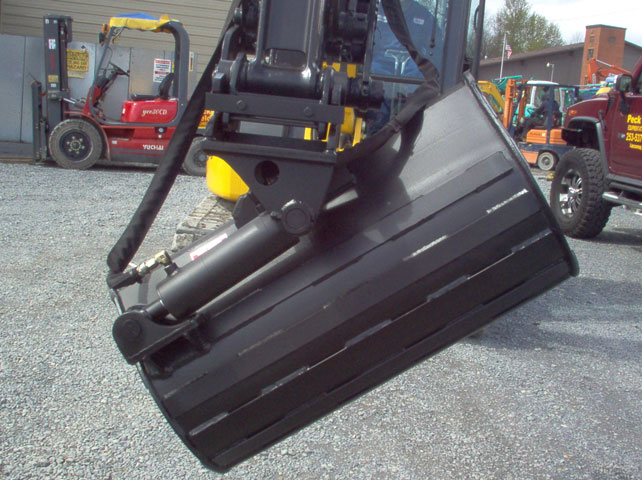

Yep, ideas. I have had these pictures in my Projects File for a long time, waiting for a Roundtuit! :D
View attachment 318582 View attachment 318583 View attachment 318584 View attachment 318585

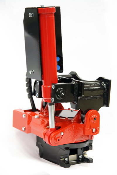

That was my original plan as well but then I seen the Rototilt design and the idea of being able to use any attachment seemed like the better way to go. Guess I am going to have to pickup some more material this afternoon for another build. The plan is to keep the current quick coupler on the tractor and have the tilt function as something I can take on and off easily so I can still use the thumb.

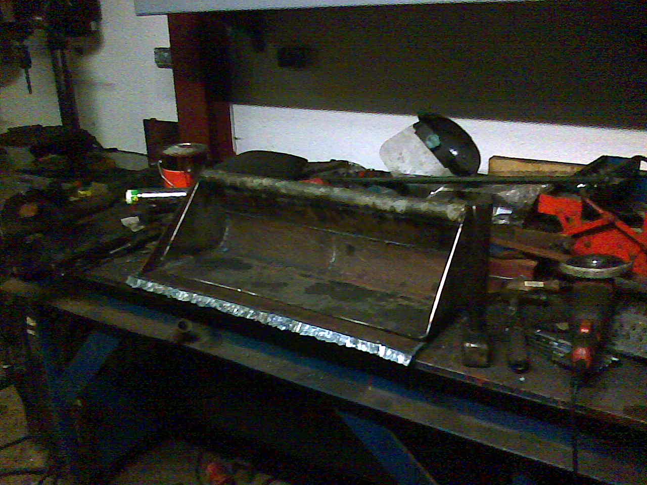

Very nice job. I'm just curious how difficult and what did you use for bending the 1/8" plate to conform to the curves.

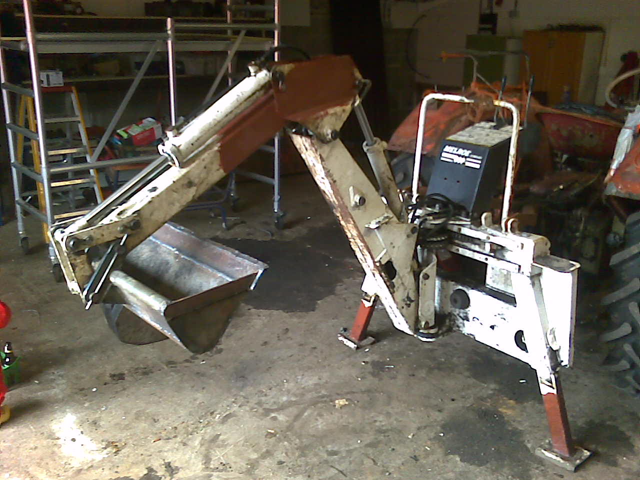

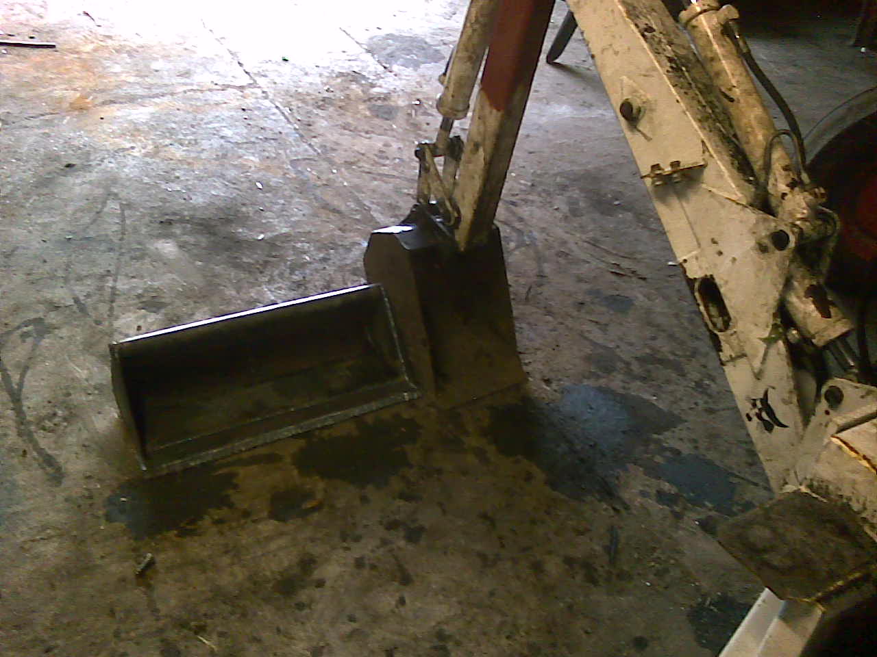

These are pictures of the ditching bucket i made for my Bobcat backhoe (converted for tractor use)
If you look at the first picture in this thread you can see the 2" ratchet strap that I used to bend the 1/8" plate. I would bend it some and then tack it in place. Then reposition the strap and repeat. Took three repositions to complete it.

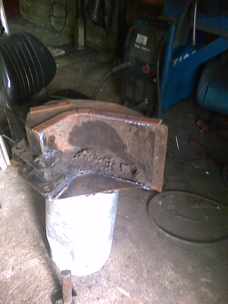

My bucket was slightly thicker steel (1/8" is 3mm and i used 4mm) but i cheated by cutting 35cm of 5" pipe open over its length, welded the two halves against each other to get 70cm of curved bucket back ;) I wanted a small radius (would prefer 8" but didnt have any pipe) so i could better get in narrow drainage ditches. With a deep and high bucket you cant scoop on the bottom of the ditch, but have to pull the dirt out over the side before the back of the bucket has clearance to curl.
I actually did some ditching and can see what your saying. I may build another similar to what you have for just that reason.

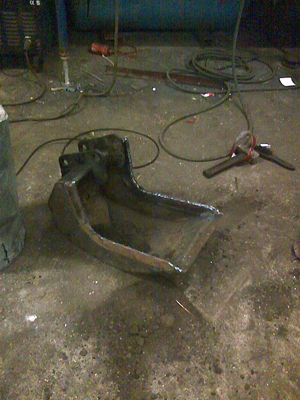

I made one of these small buckets few days ago. It's for a JCB mini excavator. Width is 22 cm and they will use it for trenching. I was worried that the wet clay could stick inside so I added a chain ejector, but it doesn't, it could work without it.

Very nice! I'm just curious to know the cost of the materials involved. Here in Florida, I could purchase a good used 24" bucket for US$200 (no teeth) to $400 (welded teeth).
Of course, the satisfaction of building it is priceless...

Made a quick attach for the backhoe bucket. It should be ready tomorrow once the paint is dried. Need to pick up a few extra 1" pins so I can leave them in the buckets.
How thick was the steel you used on the quick attach? I would like to make one of these.

I used 1/2 plate for couplers and 1/4 plate to weld the couplers to. I went 1/2 to make the the couplers as strong as possible to ensure they didn稚 get beat up hitting off the bucket when trying to connect. Been using it for 6 years now and everything still works perfect. I have since bought an excavator so I don稚 use the backhoe nearly as much but it does see use.
