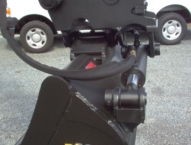

Yep, ideas. I have had these pictures in my Projects File for a long time, waiting for a Roundtuit! :D
View attachment 318582 View attachment 318583 View attachment 318584 View attachment 318585
That was my original plan as well but then I seen the Rototilt design and the idea of being able to use any attachment seemed like the better way to go. Guess I am going to have to pickup some more material this afternoon for another build. The plan is to keep the current quick coupler on the tractor and have the tilt function as something I can take on and off easily so I can still use the thumb.

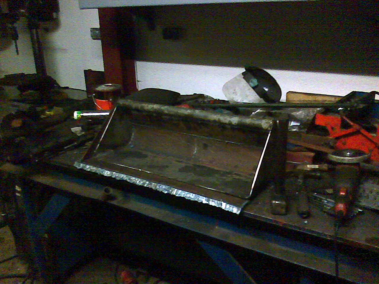

I have used it grub off a 1/4 acre of lawn, level out 4 tandem loads of fill and straighten out a bank along the edge of a driveway. For the lawn and fill it worked better than I hoped. It would be nicer to have a wider bucket for final grading but the 24" width is the perfect size for my tractor. When I get into the hard packed ground it struggles because of the lack of teeth. It does an alright job but the regular bucket is a lot faster. With the quick coupler I built it takes a few seconds to switch them out so I end up losing up the ground with the teeth and doing the clean up with the ditching bucket.

Very nice job. I'm just curious how difficult and what did you use for bending the 1/8" plate to conform to the curves.

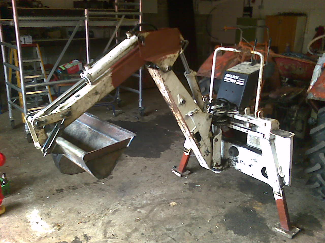

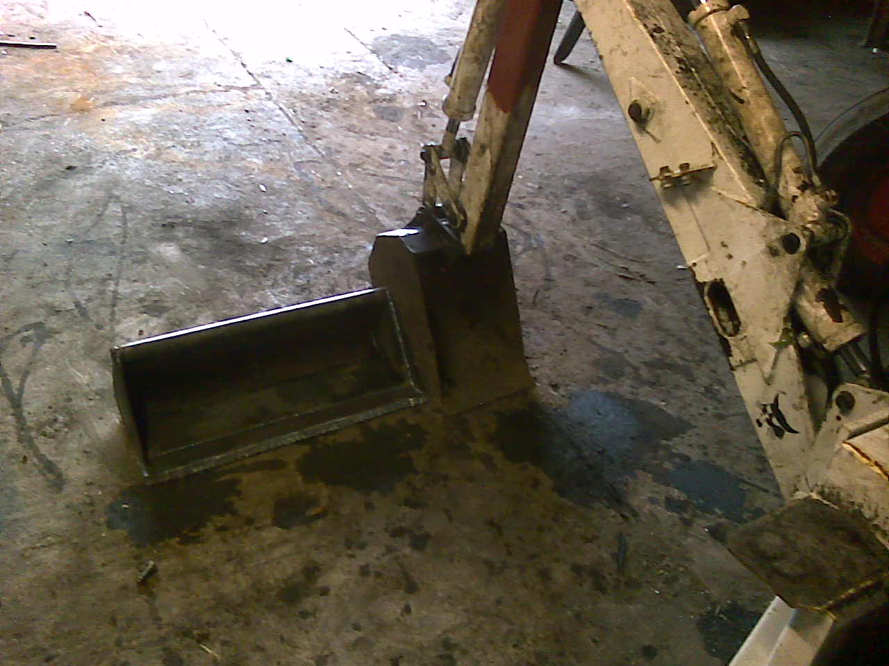

These are pictures of the ditching bucket i made for my Bobcat backhoe (converted for tractor use)
If you look at the first picture in this thread you can see the 2" ratchet strap that I used to bend the 1/8" plate. I would bend it some and then tack it in place. Then reposition the strap and repeat. Took three repositions to complete it.
/ Ditching Bucket #28
My bucket was slightly thicker steel (1/8" is 3mm and i used 4mm) but i cheated by cutting 35cm of 5" pipe open over its length, welded the two halves against each other to get 70cm of curved bucket back ;) I wanted a small radius (would prefer 8" but didnt have any pipe) so i could better get in narrow drainage ditches. With a deep and high bucket you cant scoop on the bottom of the ditch, but have to pull the dirt out over the side before the back of the bucket has clearance to curl.
