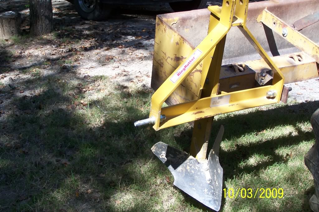

What attachment do you use to create and maintain roadside ditches?
I found this modified box blade with a middle buster bolted on to the side. I知 not sure if it is offset enough from the tractor tire. Otherwise the tire would just mash down the edge of the ditch and then the middle buster has more to clear out.
Do you know of any tools, tips, techniques for digging and maintaining roadside ditches?

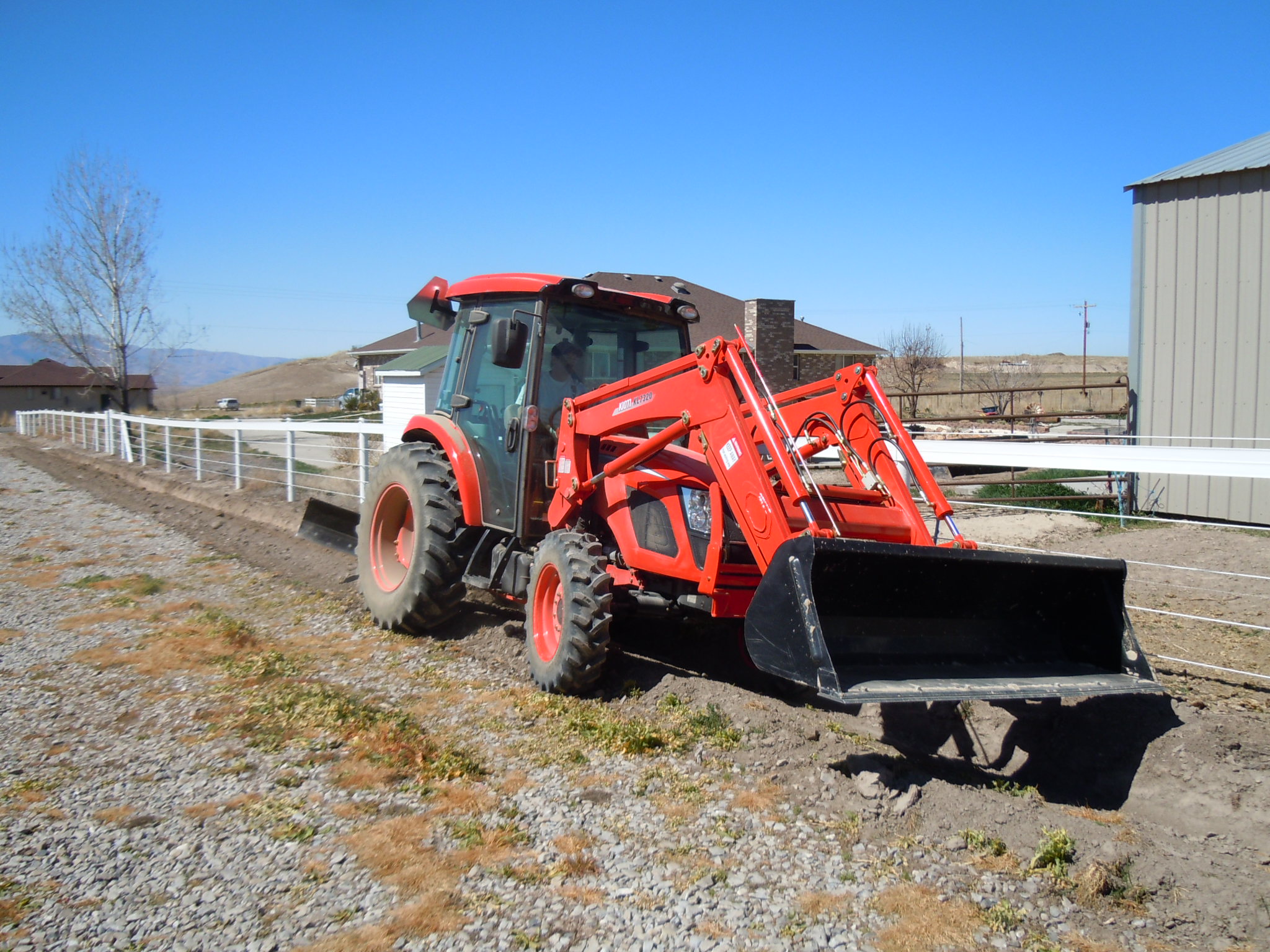

A rear blade tilted and angled will cut a ditch and keep it cleared.

I've given a lot of thought to doing something like in the picture...but I do have good success using my rear blade to clean out 6' of ditch at a time/pass...

I suspect the attachment combination pictured was cobbled together for something other than cleaning road side ditches but haven't a clue what it's purpose is....

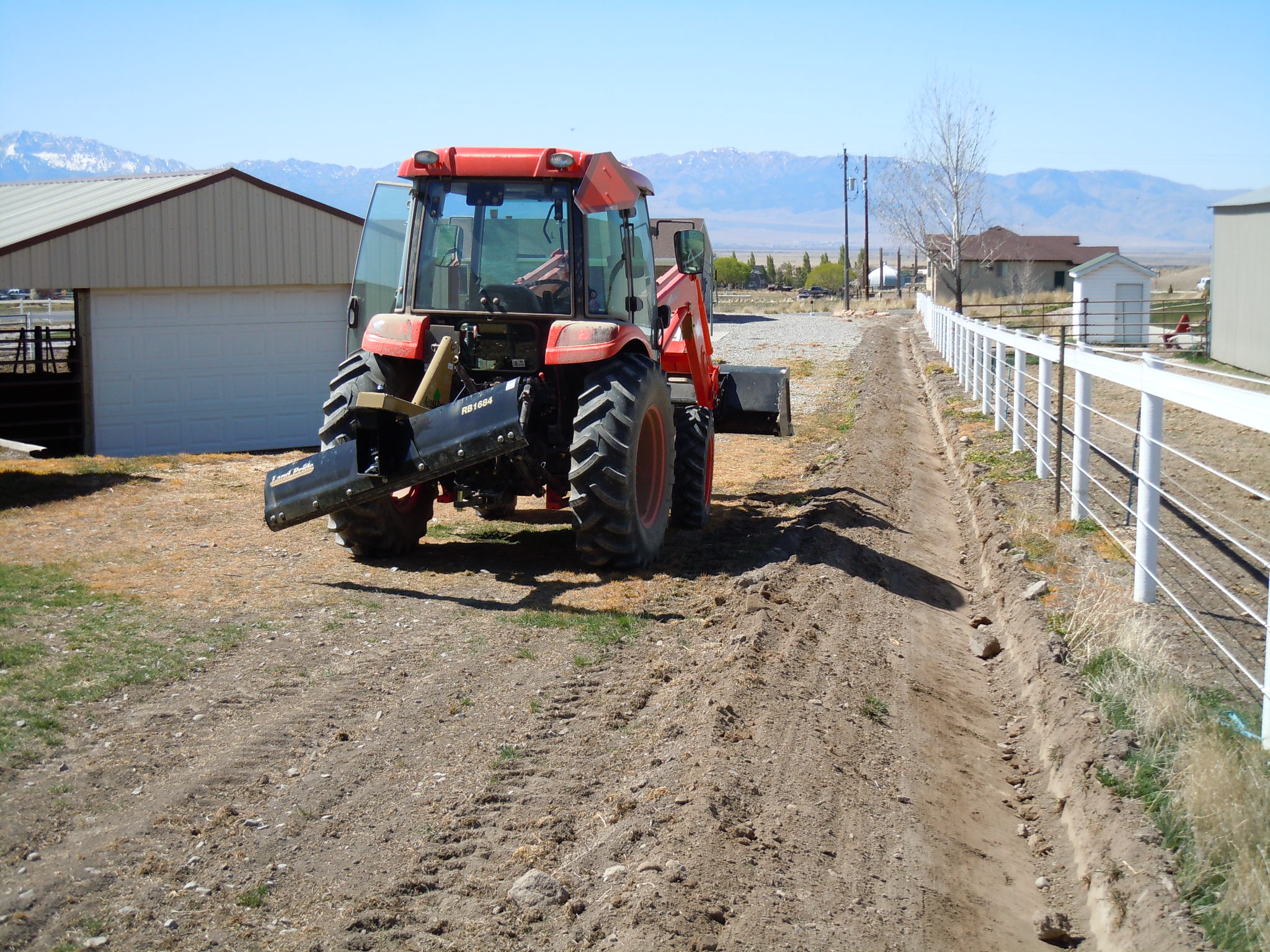

This,
and I lock my lower links all the way to the side.
In the picture above see how the blade is all the way to the left.
