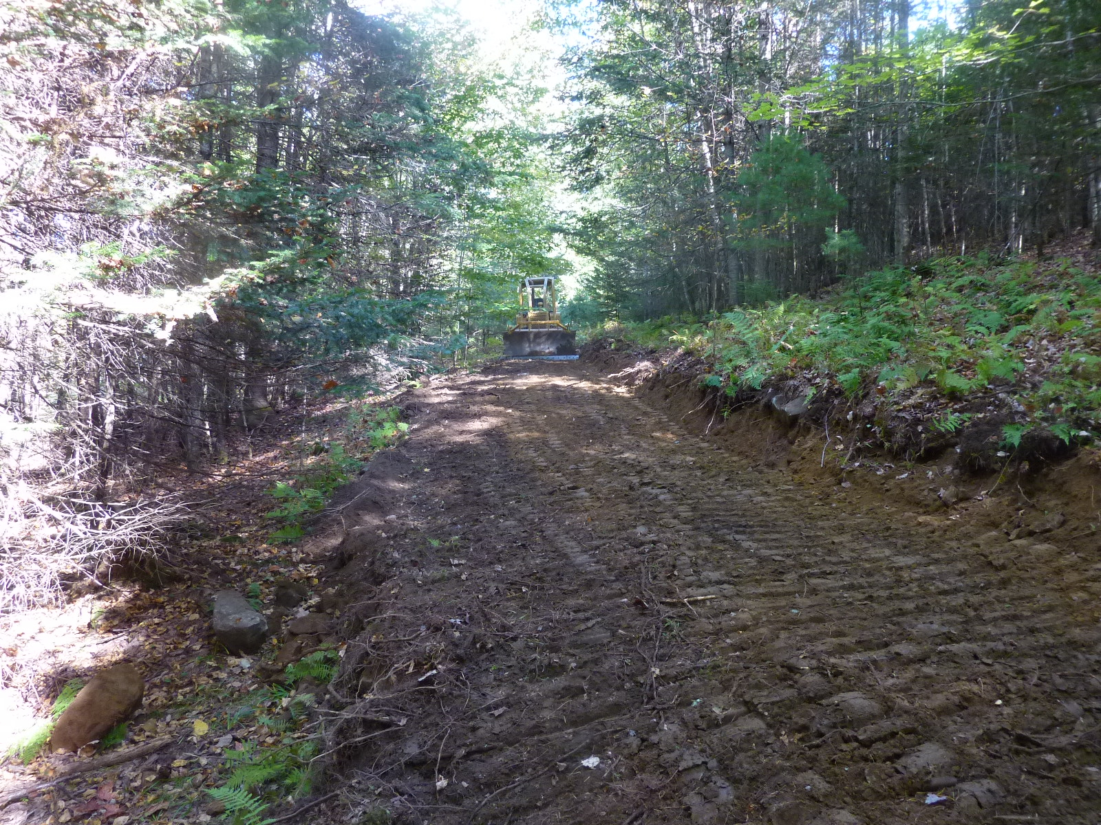

Improved many trails using a back blade on a small tractor on our hillside farm. Going from a standard back blade to one that offsets made a big difference. Weight, quality and adjustability all improved with a premium blade. Gear leveling box on a 3pt hitch saves considerable time. TopNtilt would be sweet. Time of year makes a different too. Spring is a good time to break ground. I have to deal with a lot of trees. Some paths took many years effort to get established. Backhoe helps with tough spots. With 60” rain per year always have to consider where water is going to run.

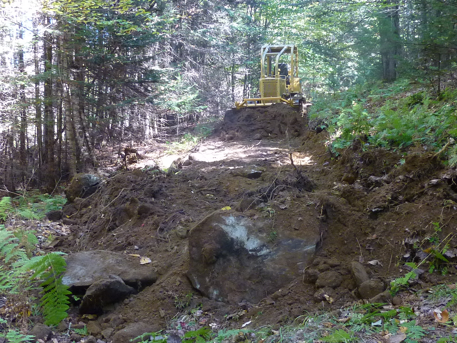

Wow. Missed the entire page 2 of comments here. Thanks all. The soil is indeed pretty rocky. So it looks like a back blade is not going to be feasible, and a mini excavator would be our best bet. Aka, we should probably just stick with the slow going of the backhoe.
