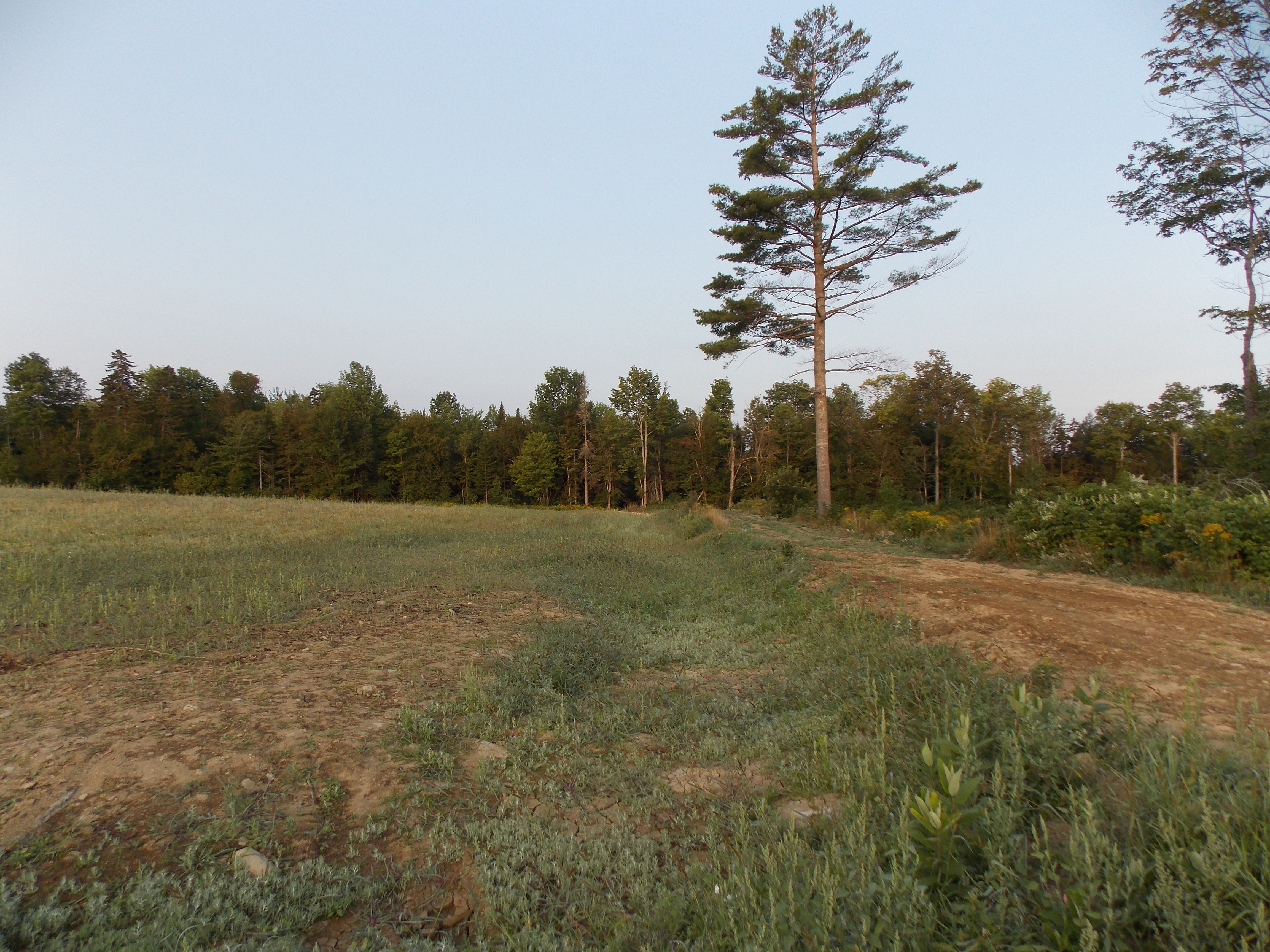

I think you got some pretty good answers already.

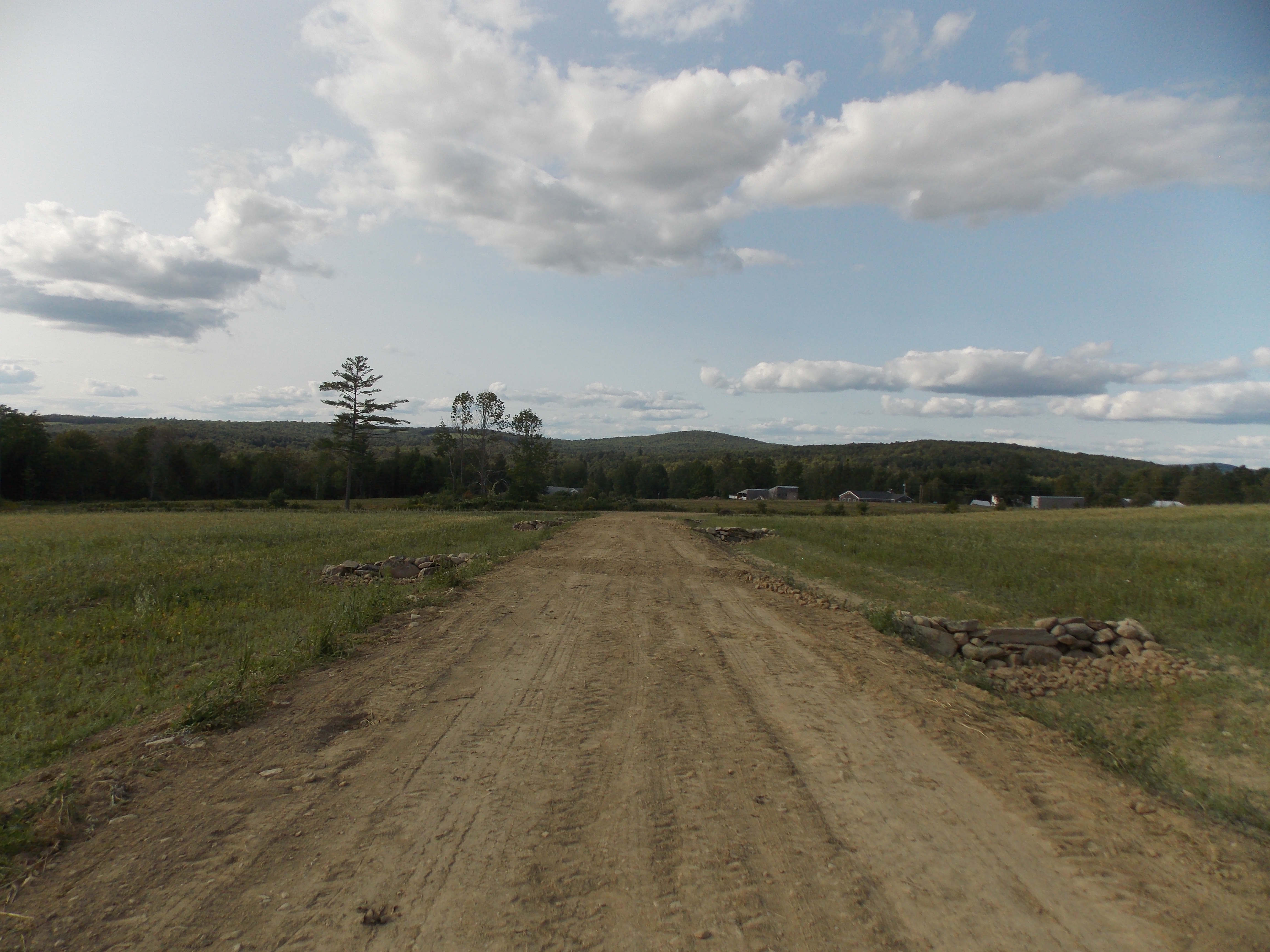

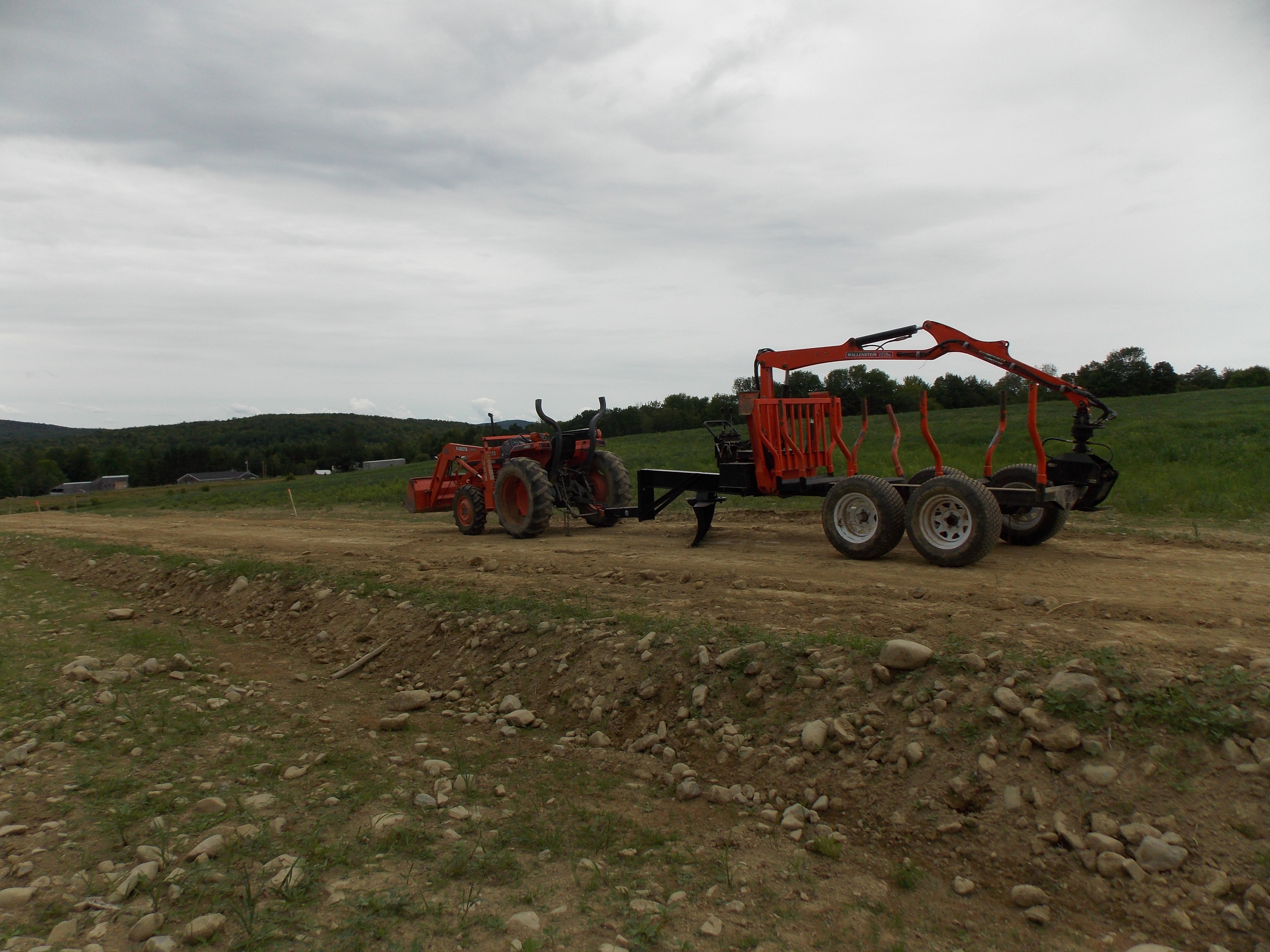

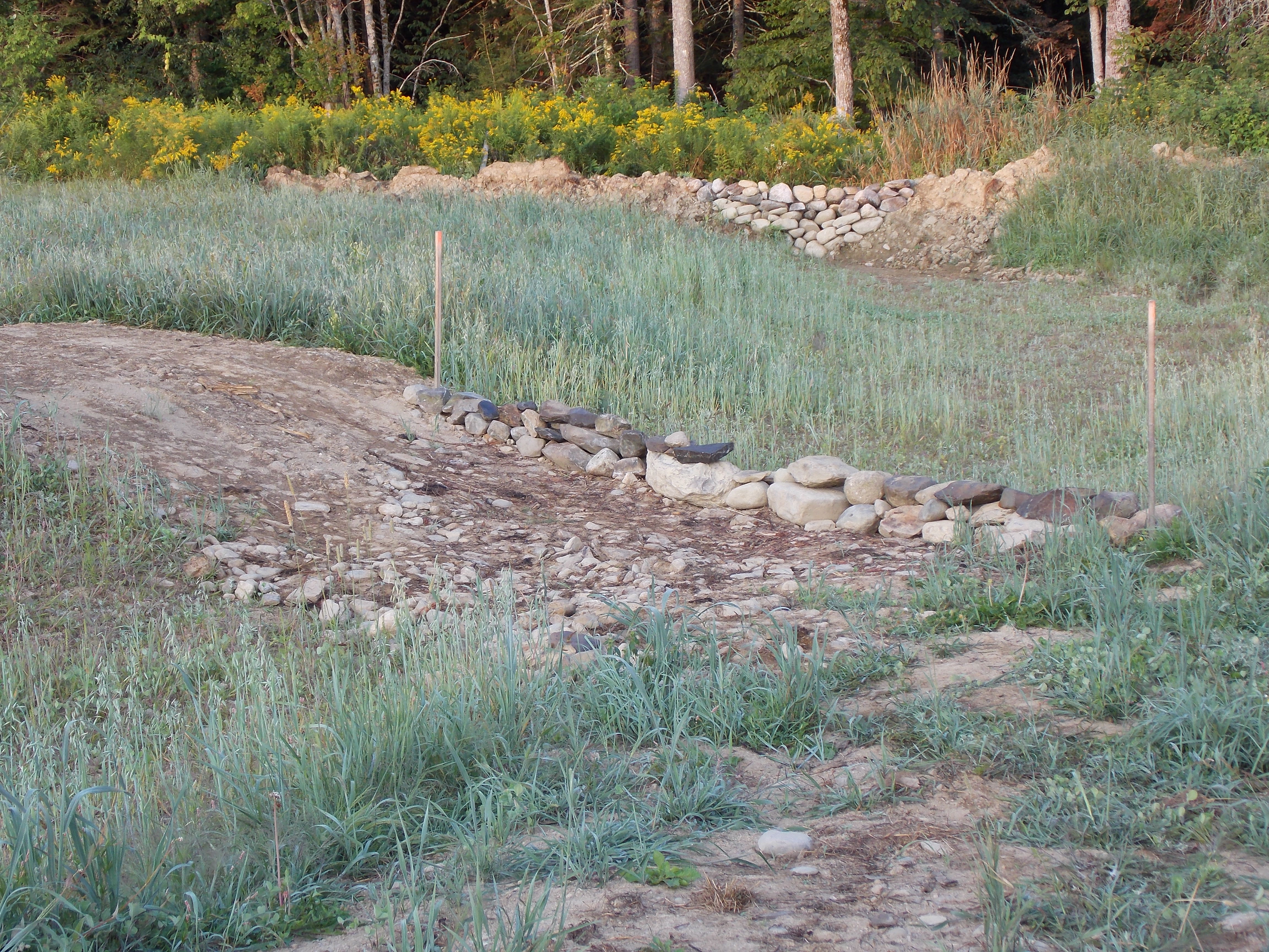

I do not have a box blade so I cannot recommend one, but when I extended a heavy haul road last year, and did a lot of swale construction in the same area, I used my Kubota (same sized as yours) with the front end loader and a grader blade. I also used a turning plow to loosen the soil, sometimes a few times to get the deep cuts in. It worked well.
You will be surprised what you can do with your tractor with a little time and skill. Here are a few pictures of the ditching, rock dams, swale building, etc work that I did last year.

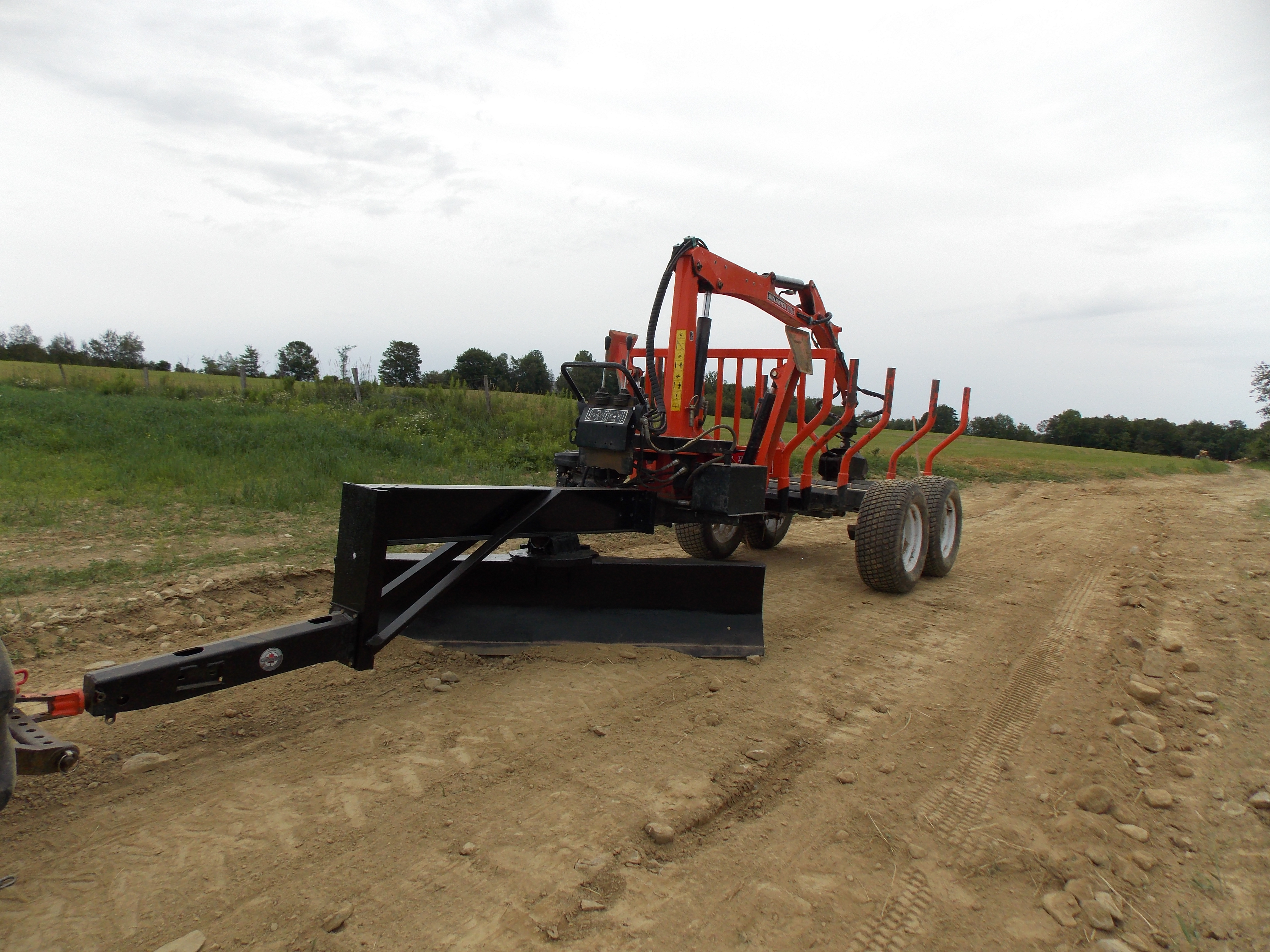

I had a grader blade, but it did not work well at grading my road at all. The problem was, when the tractor goes into a hole, the grader blade did too, and when it comes up, so does the grader blade. With a lot of work on the 3 point control lever, some of this can be worked out, but it was hardly ideal, and took a lot of passes to get something that was nowhere near as smooth as I wanted.
I had my log trailer though, and it has a walking beam suspension with 4 wheels (the same as a real grader). So I cut apart my useless grader, and instead fabricated up a grader that bolted onto my log trailer. Now whenever my grader blade kicks up a rock, the axle wheels pivot over it, and keeps the blade flat on the ground at all times. At the same time, it is now 18 feet long with the grader blade centered between the tractors rear tire, and the center point on the walking beam suspension. This means I get a really flat roadway because the blade only travels half the distance between the rise and fall of those two points.
In practice, it takes two passes to grade my road now. The first might cut in deeply in places, and skip over other places altogether, but it is a cut and fill sort of operation. The next pass just skims over the entire surface and smooths the roadway right up. It really has to be seen to be appreciated. I am strange that way, if I do not like the results I am getting, I figure out what i have and turn it into something that works.

Ya, that is the drawback of a box & grader blade. A LPGS has really long skids to counteract the attitude of the tractor. But that comes at the expense of being able to move rather than just smooth material. Wheels behind a back blade or landscape rake whelp on a similar manner. So I assume sticking your blade under an appropriate trailer would work out as well. Back in the day they put them under the tractor. Then stretched the tractor for, then they became road graders.
Going really slow along with skill/experience makes the 3pt blades work better at least for a smoother more even finish. At least compared to the finish you can get with a LPGS on rough ground moving fast.

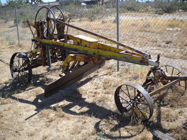

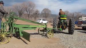

Oooo, I LIKE that. Reminds me of the old horse drawn graders they used to build and maintain roads in the old days. I almost bought one several years ago, simply because it was very cool. These babies can be converted to tractor wor as well.
