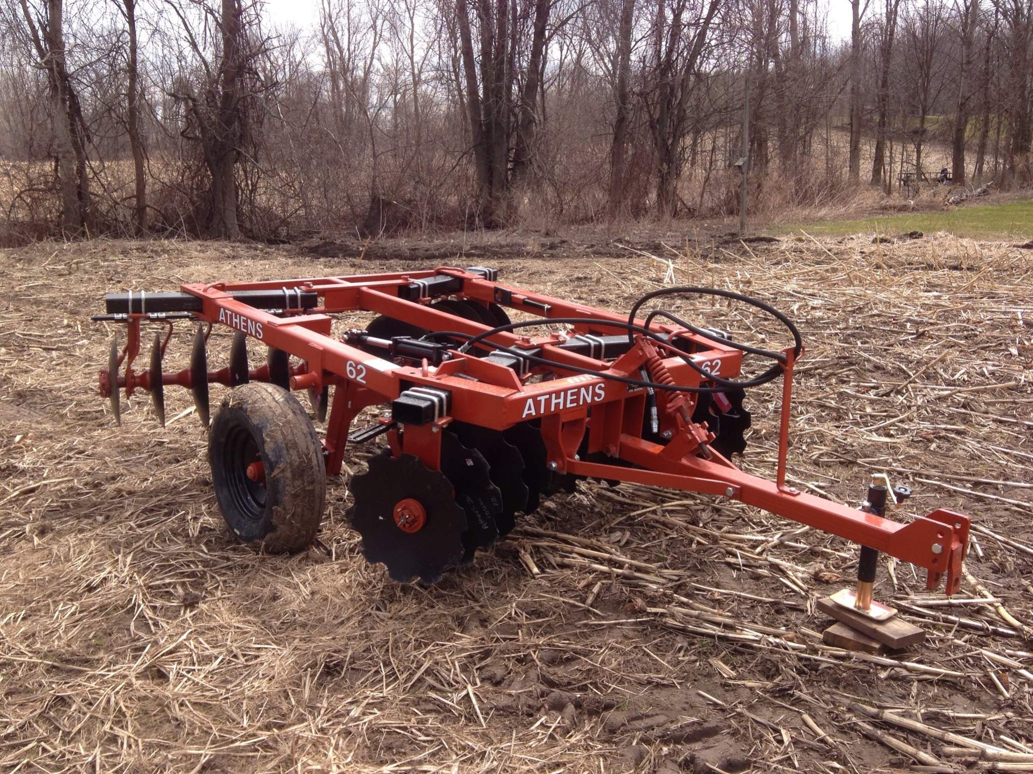

Its basically open fields and large 5+ acre clearings. The land is flat and sandy loam. Easy to till. I would think the added weight of the pull behind frame would be enough to disk better
Yes, a pull behind disc does a better job overall than a 3PH disc. Both have their uses but for the type of discing you describe the pull behind would need fewer passes and the results would be more even.
Now, if you dragged it and used a cultipacker you would really have an impressive result.

I attach my drag harrow to the back of my disc with a chain and it works very well. It does bring up the large rocks to the top, but makes them easy pickin for the grand kids! If you get a good heavy cultipacker you can set all but the largest ones back flush.
I agree with the others on the pull type, just make sure you can get scrapers for the one you decide to buy. I plant for the ducks also and they like the wet areas and nothing worse than constantly clearing mud. The combo of notched discs in the front with smooth on the rear works best for my soil type, that's something you may want to consider.

That's a beautiful field! Cultipacker eh? I'll have to look into getting one of those...
As for the original question, I have the Armstrong Ag 8' Disc on my M7040 - also pulling in sandy loam. The disc pulls fine, but I have no idea if a 10' disc would.
