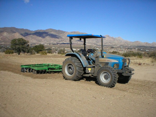

I will give you my experience. I have all old Kilfer pull disks. (John Deere bought them out looooong ago) 6', 8', & 12', all had smooth blades when purchased. Now understand that the ground that I was disking for the first time was burned in 2002 from The Pines Fire. All of our land was covered in 6' - 10' tall brush, sage, and scrub oak. Lots of branches and limbs between 1" & 4". When I started on the disking I was using the 8' disk with smooth blades. One of the biggest problems was that the disks would get hung up on the branches and stop turning, thus becoming a 20 bottom plow.:eek: Have you ever tried to pull a 20 bottom plow,:D you don't go very far.:( Anyway constantly had to stop to get the disk unjammed, or get it to hop over a 4" branch. Ended up re-building the disk and used 3/16" notched blades 22" tall. Now the disk hops over branches almost all the time and you can tell at a glance that the disk is turning. Before with the smooth disks, sometimes when they were jambed up, you couldn't really tell until you were stopped from that 20 bottom plow.:)
I think that the smooth disks work good in ground that has been disked before and does not have all that much vegetation to be turned over. The notched disks work better for hard dirt and ground that has a lot of vegetation that you want turned under. Myself, I would only get notched disks. When I rebuilt my 12' disk, I used all notched disk blades. If you are disking bigger vegetation, notched blades are the only way to go.
Just my opinion, based on my experience, others will vary.;) Here's a picture of my tractor and 8' disk, before I quit for the day.

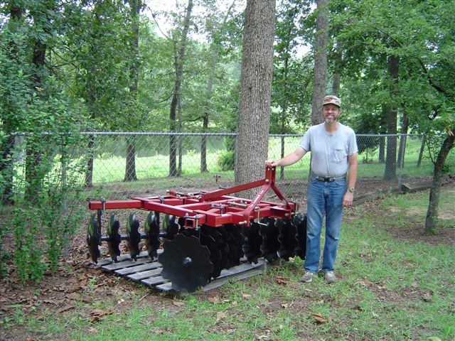

Howdy George,
I got the Leinbach 20" x 20 notched disk. I am very happy with it. When researching disk harrows, I looked on Leinbach's web site and they can be ordered with the smooth disks. I suppose you could do that, but you would have to wait until it comes in at your dealer with his trailer load order...which may take a while.
Just knowing you from your past posts and property, (planting wildlife food plots, and such), I would go ahead and get the notched disks. It would work better on rougher ground. I bought the Leinbach because it is handcrank adjustable and good value for the money.
Pic is when I first got mine and the paint is not worn off the disks. Won't mention who the good lookin' fellow is.......(and no comments from the peanut gallery)....

Looks like you have an easily adjustable disc there, does it work?
/ Disk blades. #12
Hi BTDT,
Before I bought a disk, I talked to a couple farming friends who both recommended getting the crank type adjustment if at all possible, instead of the the other adjustment types.
Bottom line, Yes...it is easily adjustable, and fairly quick. I am very satisified. A hand crank on the front gang, and a hand crank on the rear gang. Just lift off the ground and crank away. No pounding with a hammer or prying with a pipe to adjust.
