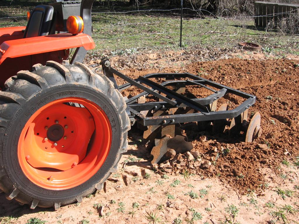

That's a little 17hp L. I wouldn't go more that 4-5'. and a light duty model. The problem you will run into is traction as the soil loosens up.

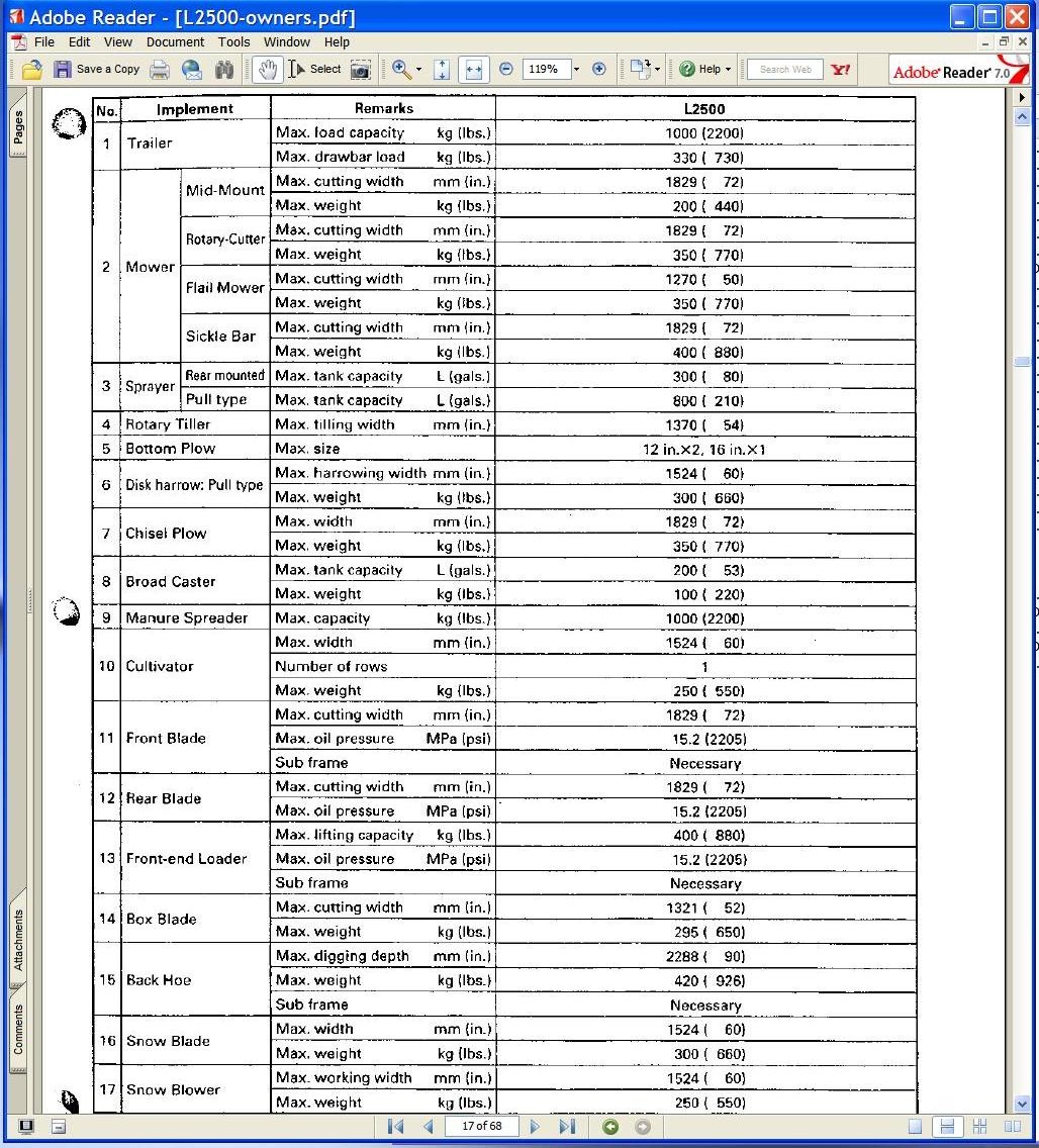

My newer L2500 does have some recomendations on the implements. This probably more to do with the weight than anything else.
This is my L pulling a 5' light duty. That loam will bury my tractor in no time.
