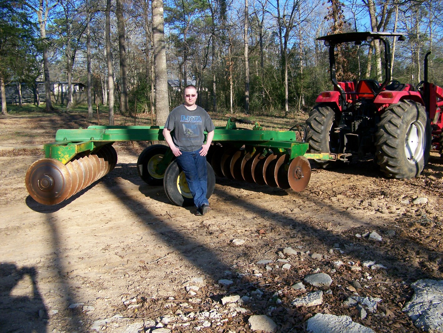

bindian That's a very nice looking disc. I just can't afford to spend that kind of money on something I'll rarely use after this project so I'm stuck trying to find something to make work.
My brother-in-law has a 10' pull behind but with the amount of money I think I'd have to put in it to get it transportable then I'd rather just buy my own even if it's much smaller. He estimates it is in the 6000 lb range. He pulled it with a Ford 9000 (110hp/12k lbs) and said it's all the tractor wanted. I've got partially hilly land so I'm not even sure I could pull it even with the tires partially down. Plus I'd have to pull it 5 miles just to get it to my land.
Then I'd would look for just a drag disc harrow and leave it on your land. No wheels, no 3PH. Just the draw bar pulling dead weight. My Uncle had one. He pulled it with his Farmall. My disc would be too much for hills with our Mahindras. Their are folks on here waiting to find a 6 foot disc like mine. The disc you seek is out there. It just takes some time and looking.
hugs, Brandi

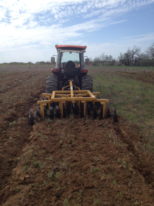

1,250# 1st pass. Handles no prob with my smaller tractor.
