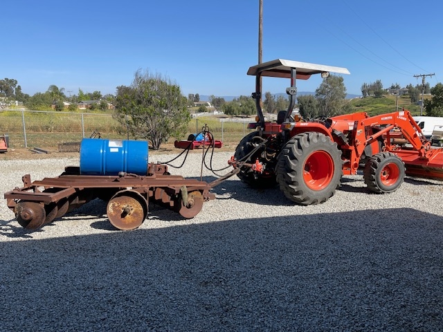

A 2 row pull disc is better generally. I pull a 6 ft wide 8 ft long towner with articulating wheels. It's old and heavy but I added weight to cut the hard rocky soil here. My tractor has 52 hp so not much different than your tractor. It can be all I can pull or even stop me when it sinks but I have those wheels which can push down lifting the disc out of the soil when it gets buried. This disc set is made by Towner, nearly as old as me. In this picture the wheels are raising the disc off the ground for transport. I hope this helps
First time i seen an old timer with those big wheels. Nice
Thanks
The disc is quite old. The wheels had a screw crank on it when it came to me. I put a hydraulic cylinder on it, much better plus I control the depth, like when it gets too deep or when making a sharp turn around. It's a solid old rig.

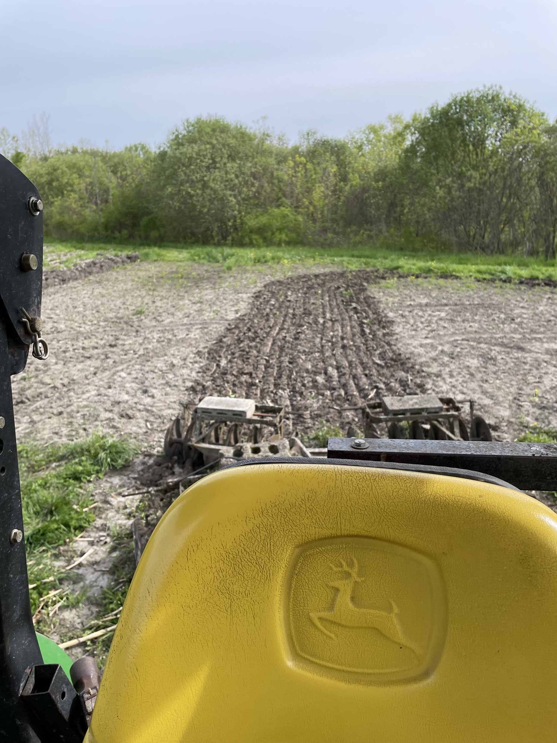

Your tractor would handle a 12 foot pull-type or an 8 ft 3-point. I certainly would recommend the pull-type as I’ve yet to see any 3 point disk that I thought was worth more than its weight in scrap metal. It takes many more passes with those, to get the ground sufficiently worked, wasting lots of fuel.
A 12 footer would be ok in ideal soil conditions. A 10 footer would let you get out there in less than ideal conditions, and that’s what I’d go for. I use a 8 foot pull type on my 43 hp 4wd and can pull that thru mud if I want to, without even knowing it’s behind me, at the most aggressive angle setting.
