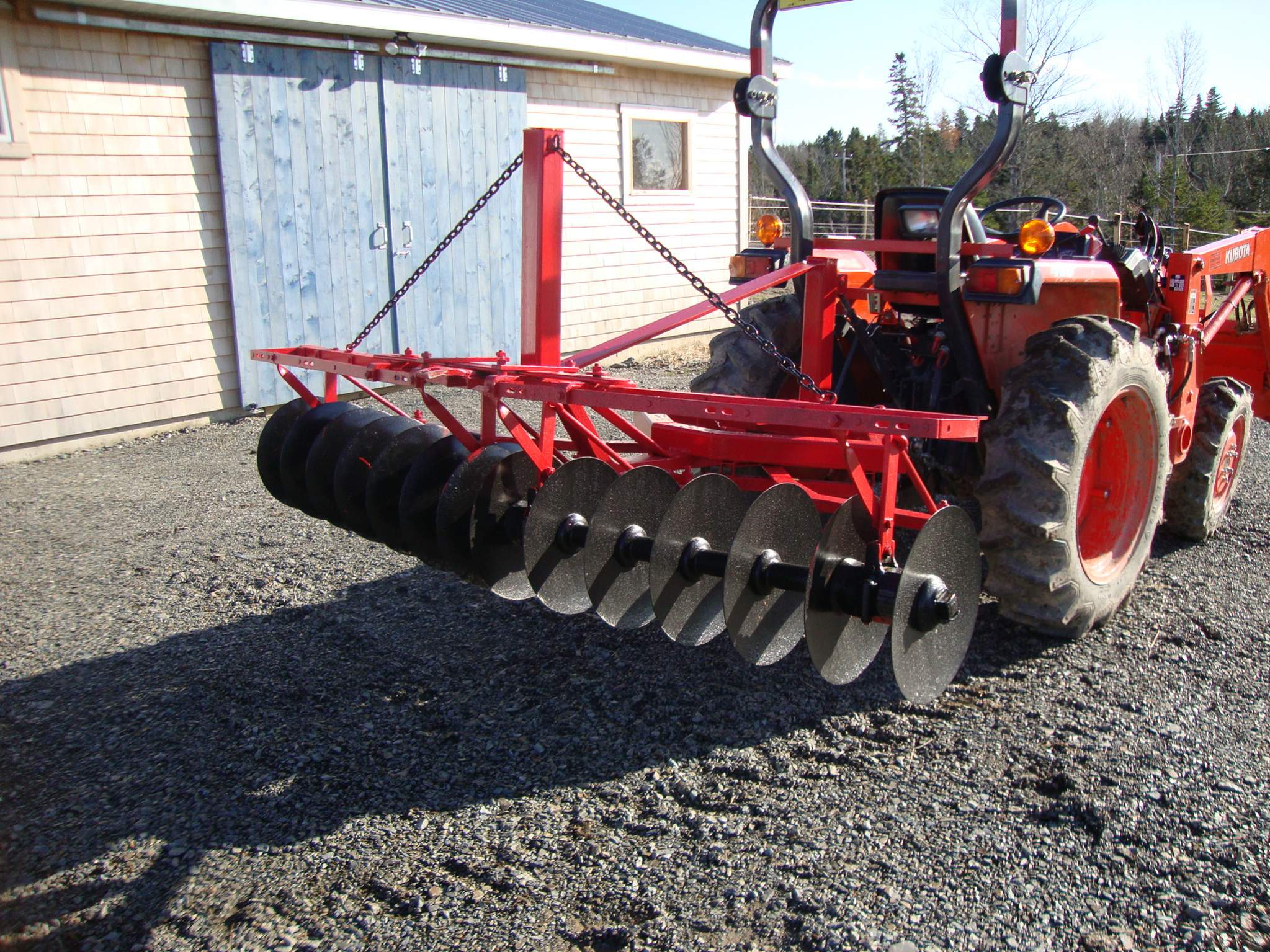

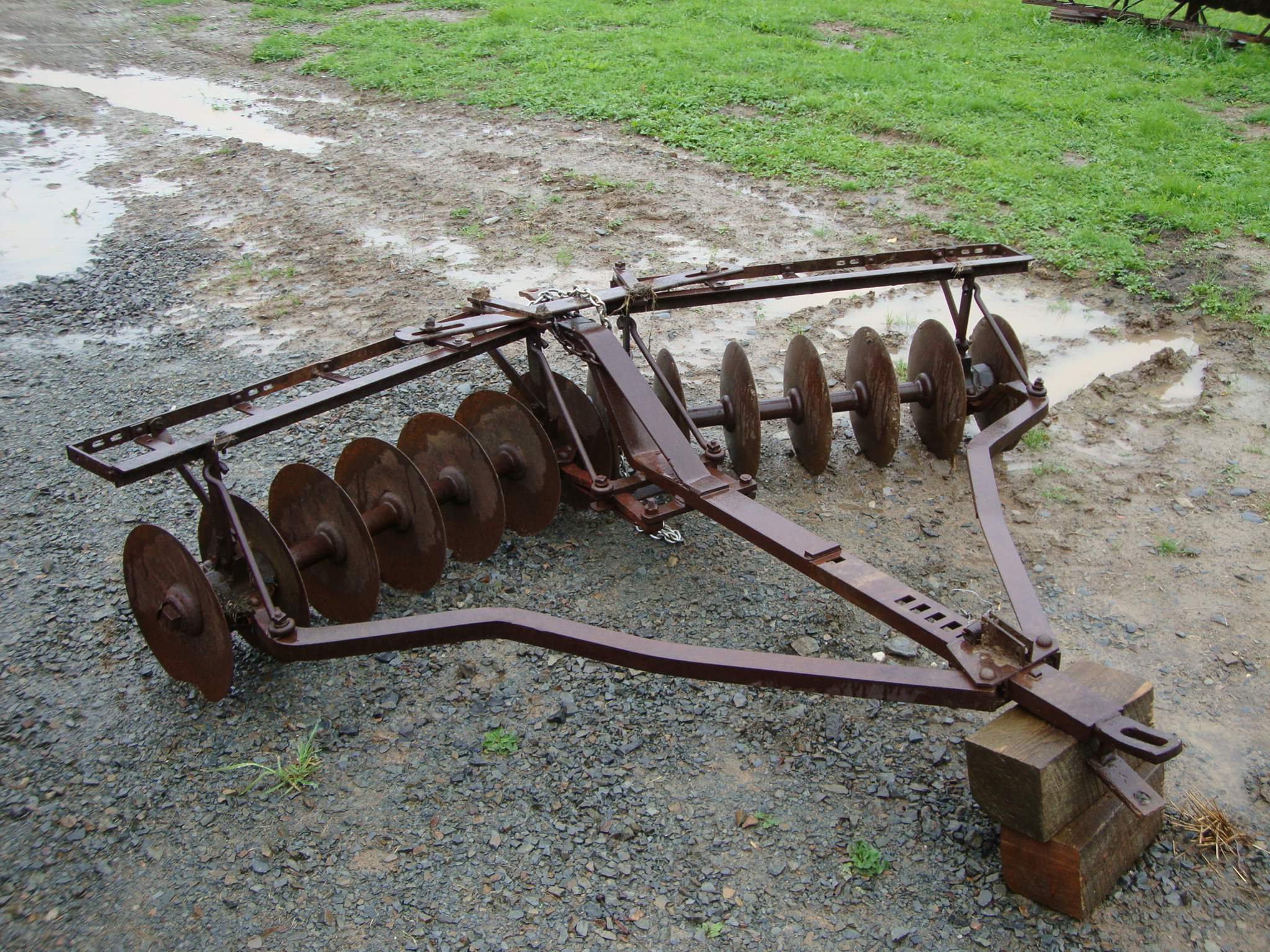

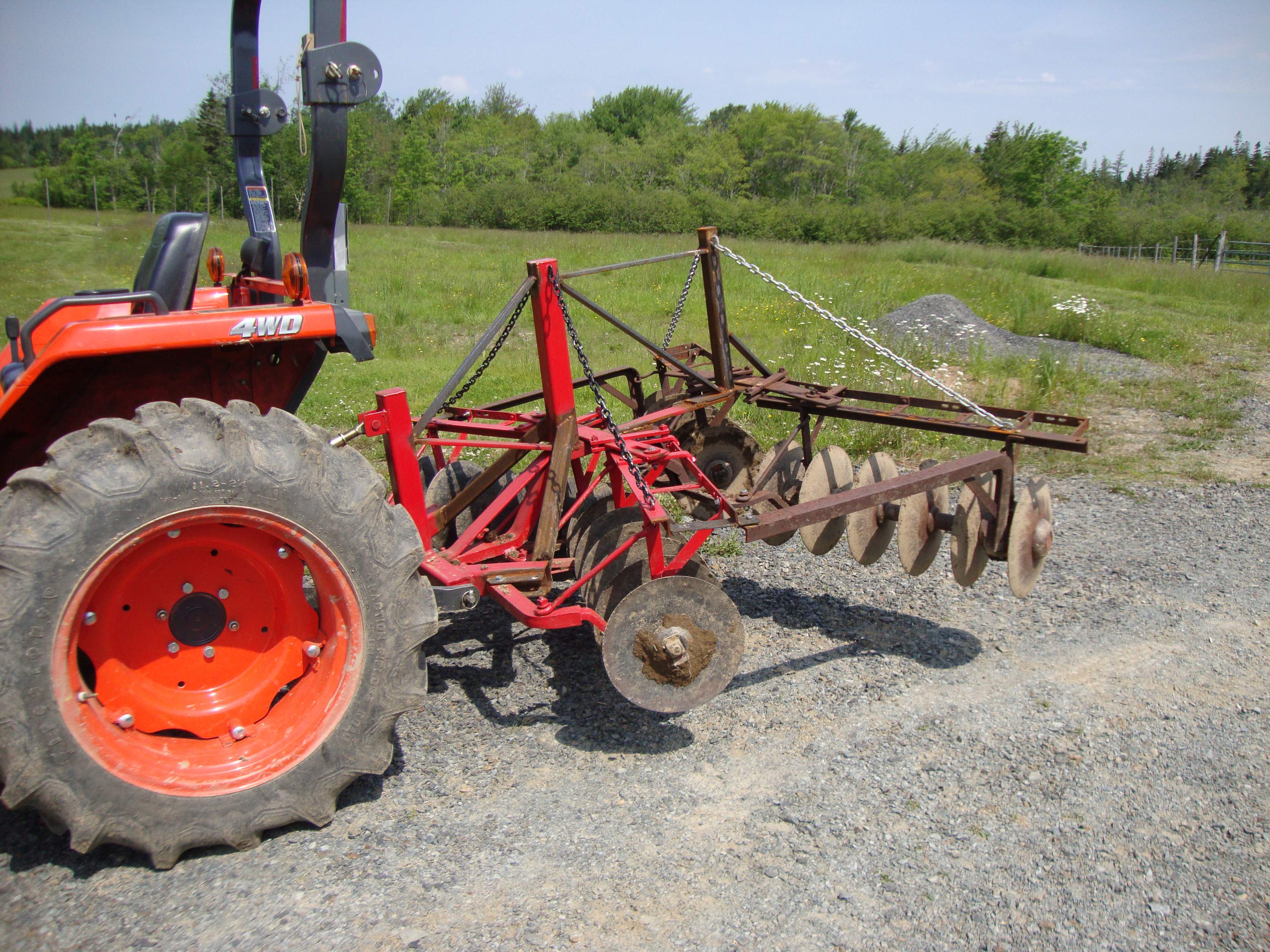

Back in the summer I came by this set of disc harrows. They were originally designed for pull-behind use, which was fine by me except that there was no easy way to transport them.

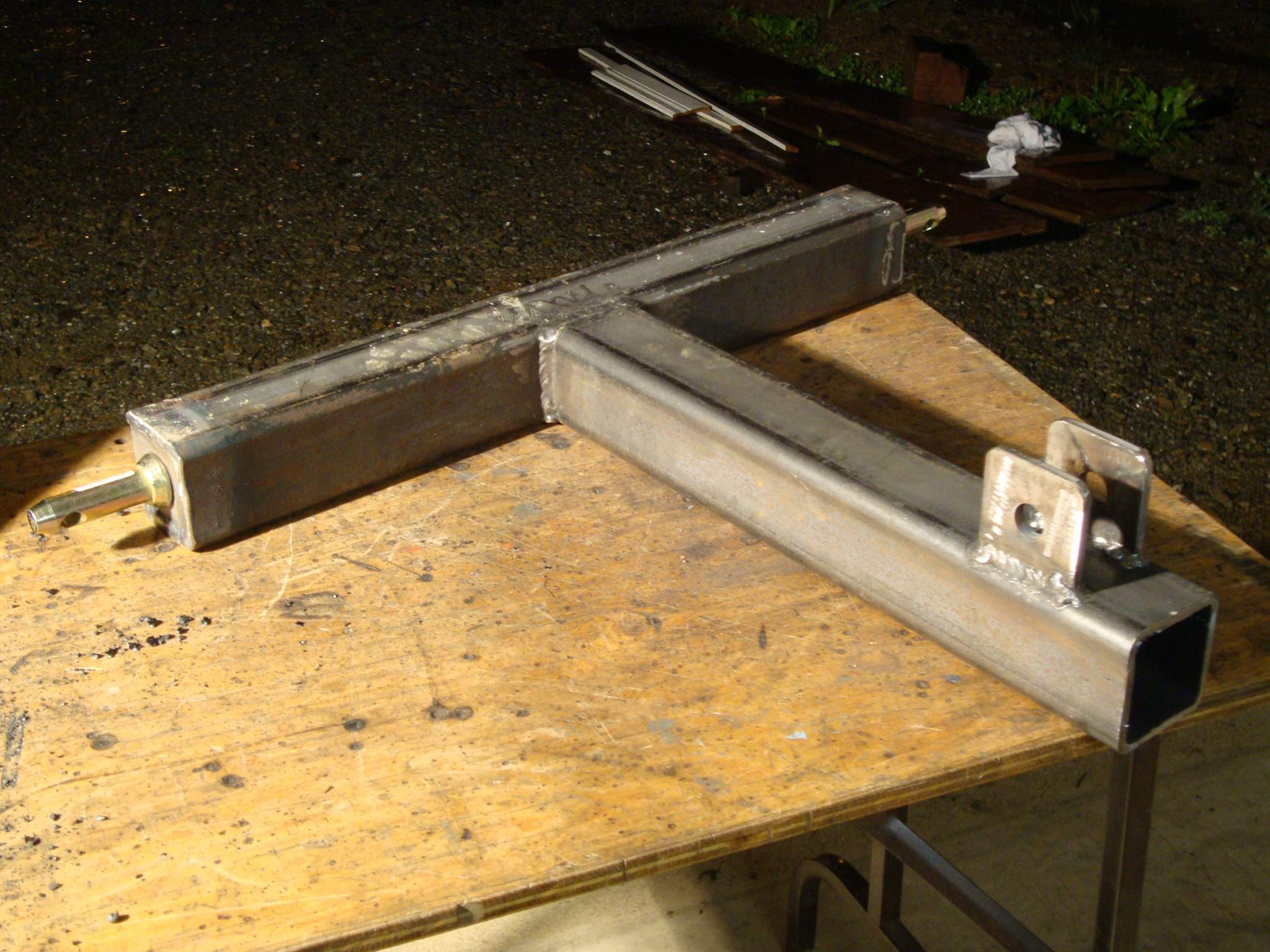

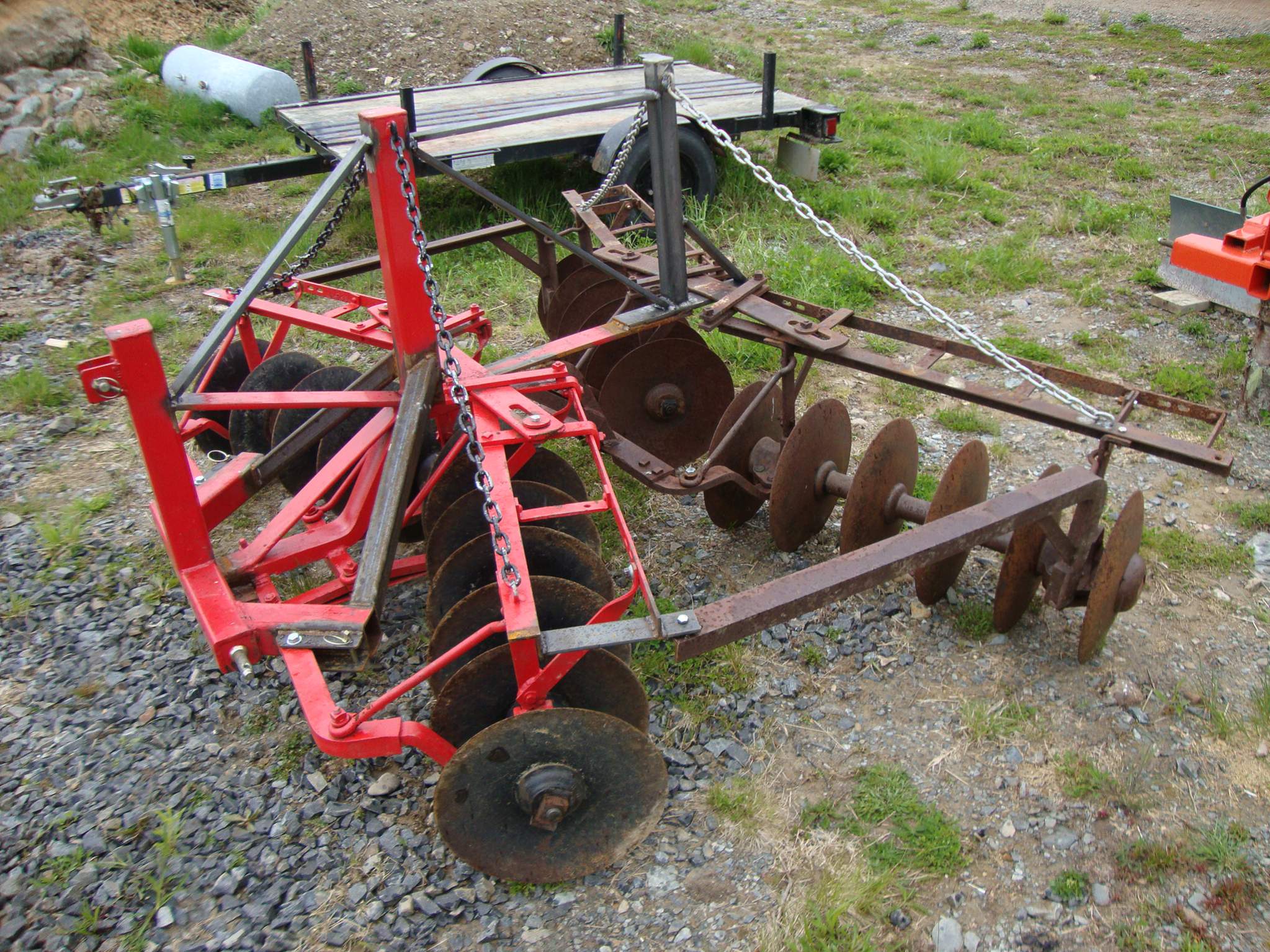

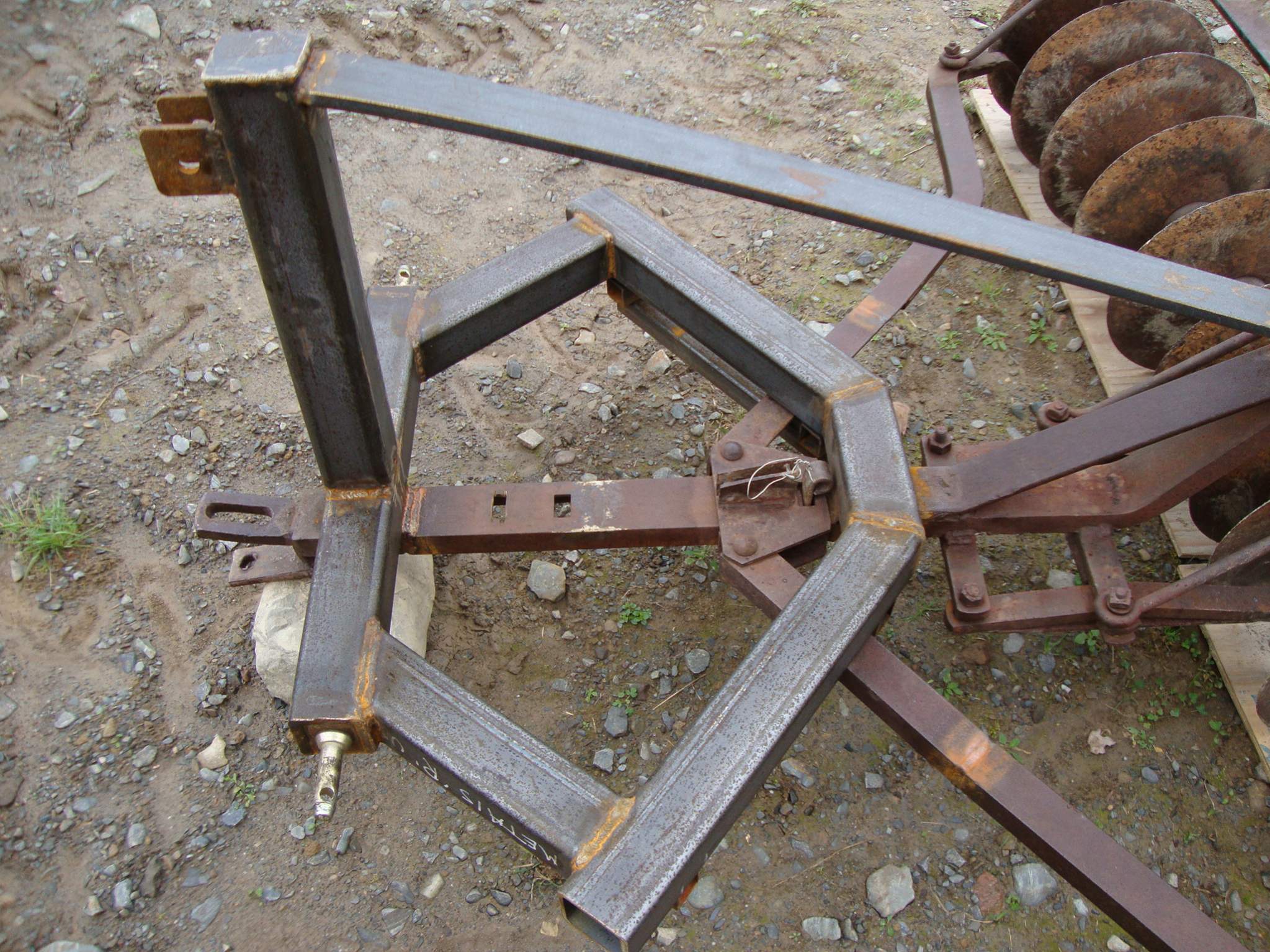

They're about 8 feet wide, the front set is designed to push the soil out, and the rear pulls it back in. The L3400 doesn't have the power to pull both sets, let alone lift them, so I decided to convert the front set to a 3 point lift style and keep the rear set for spare parts. They were built by Massey Harris from what I can see, I would imagine spare parts are right up there with hen's teeth.
The angle adjusts by moving the side rails fore and aft, the collar that slides on the center rail has slots and a locking pin.

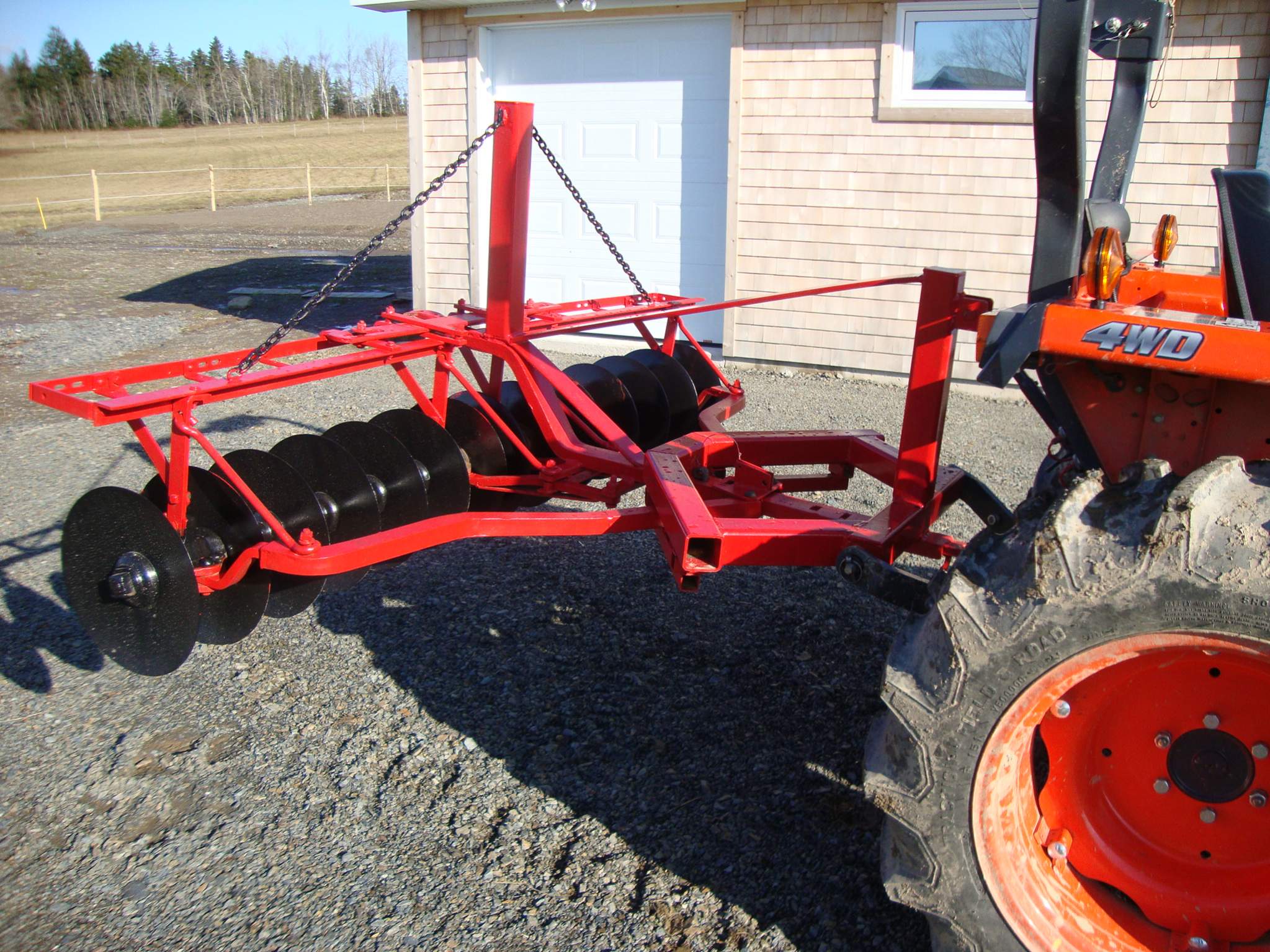

The front frame is designed to give support to the side rails and stiffen everything up.
I decided to shorten the whole thing by about 15 inches, the Kubota wasn't happy about lifting it with all the weight so far back behind the 3 point hitch. It has no problem handling it now.
The rear post and chain stays are designed to take any serious bounce loading while it's being transported. I don't foresee any long trips at high speeds, but even a small bump puts a lot of strain on the center section.
The job was delayed a couple of times, testing it will have to wait until next spring when the ground dries a bit.

That ridged link from the top link down will give you trouble on rolling terrain. A chain to let the gang float will let it follow the ground will work better or you could make a sliding or folding link like rotary cutters have. You can carry concrete blocks in the bucket between fields to lighten the transport load on the 3PH or just add on pet rocks as you find them going around the field and add them to the pick pile when you are done.

Some good ideas there guys. My rotary cutter has the folding link, I never really thought about it much for a disc but it wouldn't be hard to make one. There'll be another addition to the thread when I start to narrow the gangs this spring. Should be interesting, I don't think the nuts have been off those shafts in 50 years..

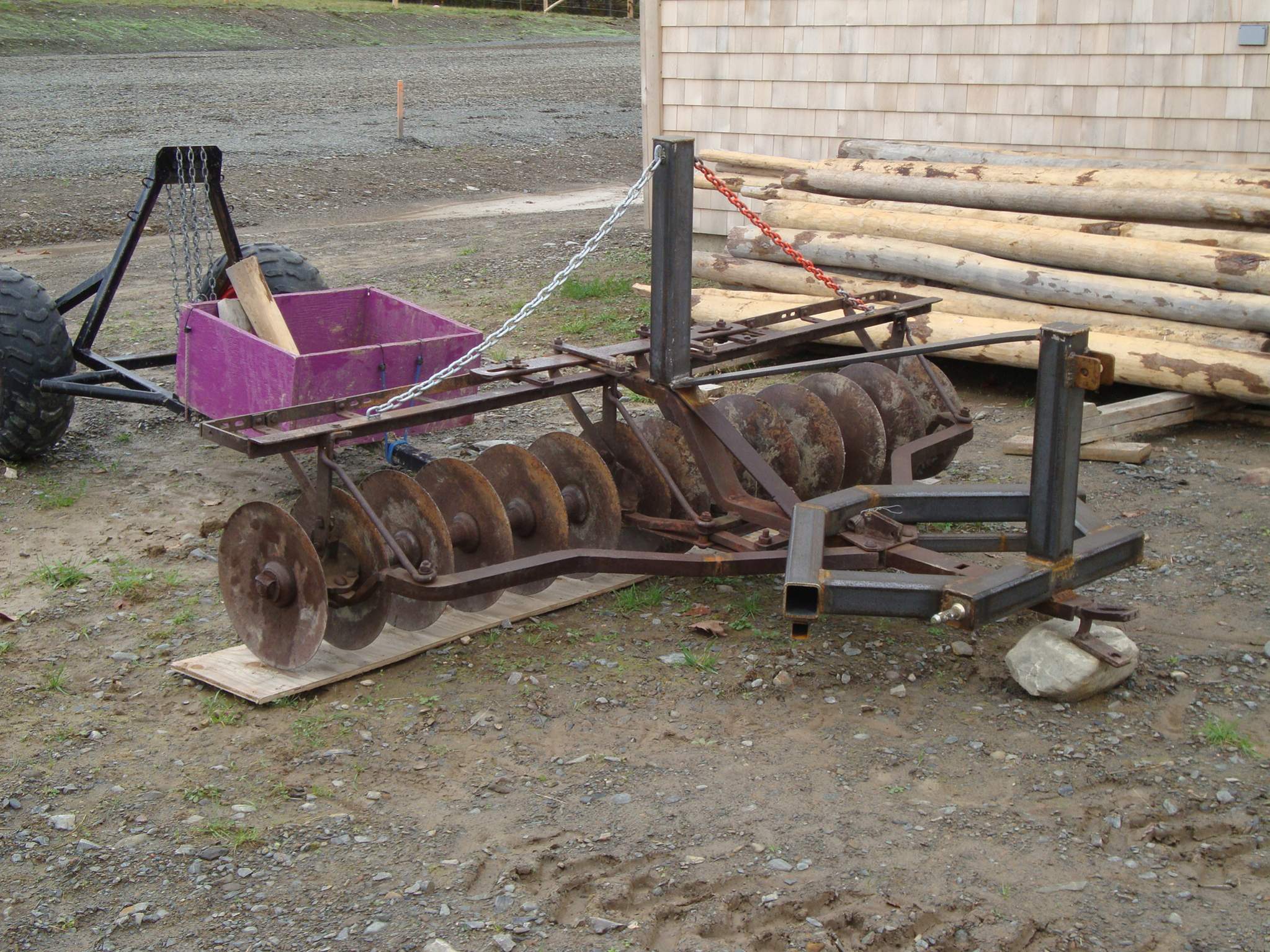

Okay, after a month of re-design, cutting, and welding including a two-week diversion which I'll explain later, the harrows are finished.. again! The pics with yellow lines show where I cut the frames, axles and other parts (including myself!), the ones with green arrows show which parts were added.
I shortened the tongue again by about 18-20 inches, cut 7 inches off both axles, and narrowed the frame that hangs the bearing housings in the initial phase of the project. That also required cutting and redesigning the angle adjusters for the front gangs.
It just about choked me to cut that 3 inch square tube, after all the time I spent getting the angles just right a year and a half ago.
The frames that sandwiched the angle adjusters were lost as part of the process, which gave me some concerns about the stiffness of the whole thing. All that would have held it from twisting were the welds holding the tongue to the 3-point frame. I don't do too bad a job at welding by amateur standards, but everything has it's limits. More on that in the next post.
The bearing assemblies are pretty simple, just a piece of hex stock with an inner rotating sleeve that gets grease from the back. The hex stock is held in place by a semi-hexagonal shape in the bearing holder halves which are then bolted together. The only grease seals are short lengths of rope held by grooves in the bearing holders. I doubt they're very effective at keeping grease in, but that was the fashion when these were built.

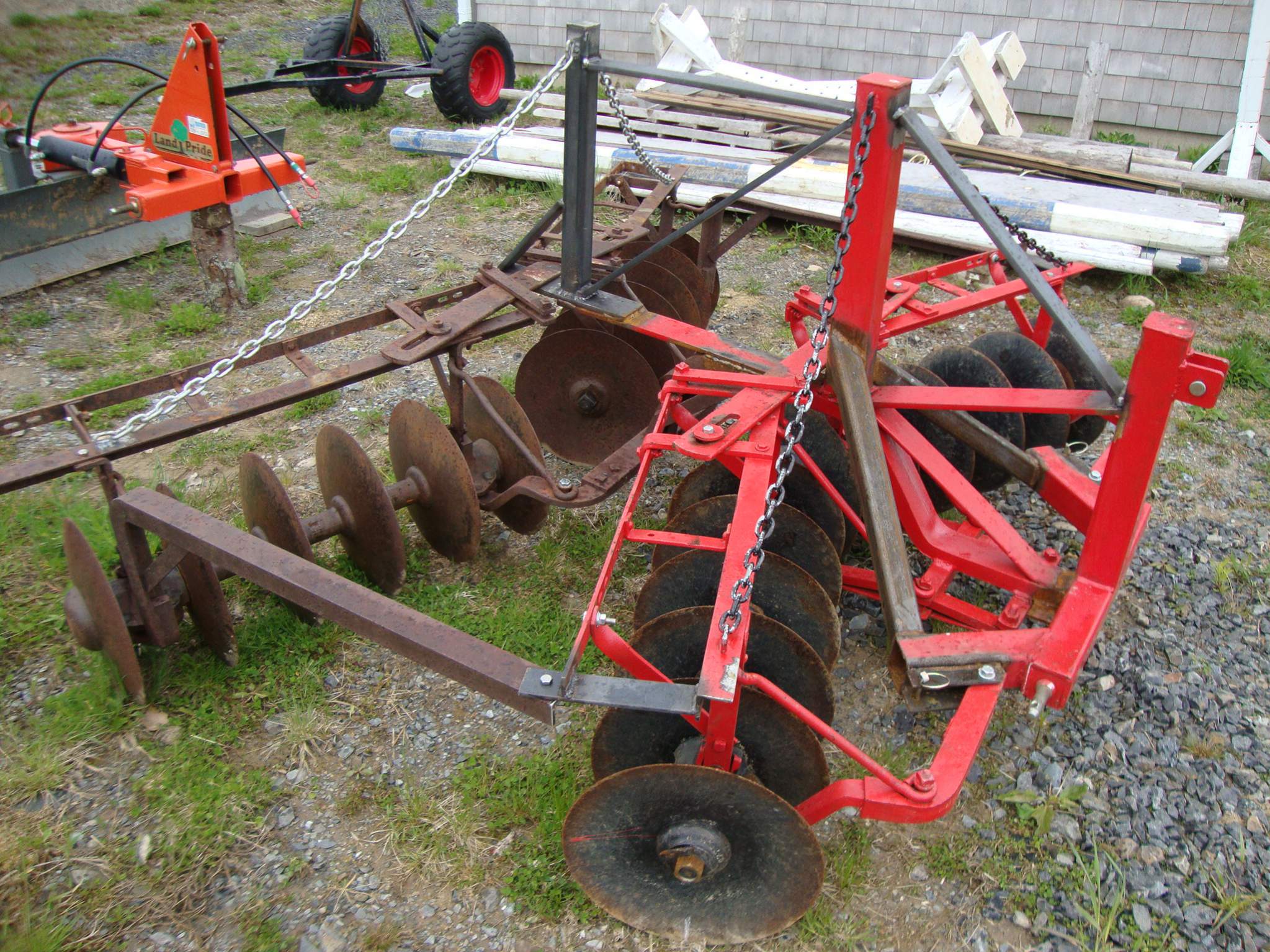

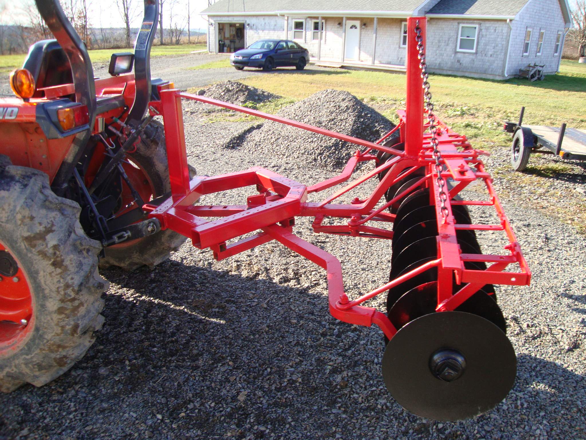

Green arrows are new additions in this picture. I added the angled braces from the old frame up to the first upright post to reduce any twisting motion where the tongue attaches to the 3-point frame, one of the more complicated compound angles I've ever cut. I used a piece of 2x2 wood and a compound miter saw to get a dummy piece to fit, then copied it in steel tube with the cutting wheel on a grinder. If it doesn't fit perfectly, a welder really IS your friend!
Now I need some warm dry weather to get the whole thing painted again, and by that time we'll be ready to give it a try before we plant our vegetable garden. The rake angle on the gangs is roughly 20 degrees fore and aft of 90, I doubt I'll have much use for it in a 90 degree configuration. If I do I'll need to devise a way to adjust the rear gangs. The front ones are adjustable by moving the ends of the adjuster arms to a different set of holes.
I got the weight just about right.. the Kubota will pick it up, it acts about the same as it does picking up my rotary cutter, which weighs about 650 pounds. They're both about the same length, which tells me the disc is between 600 and 700 pounds, give or take.
The front set of discs is about a foot behind the rear wheels of the tractor with them raked fully ahead, so I can't get much closer than that.

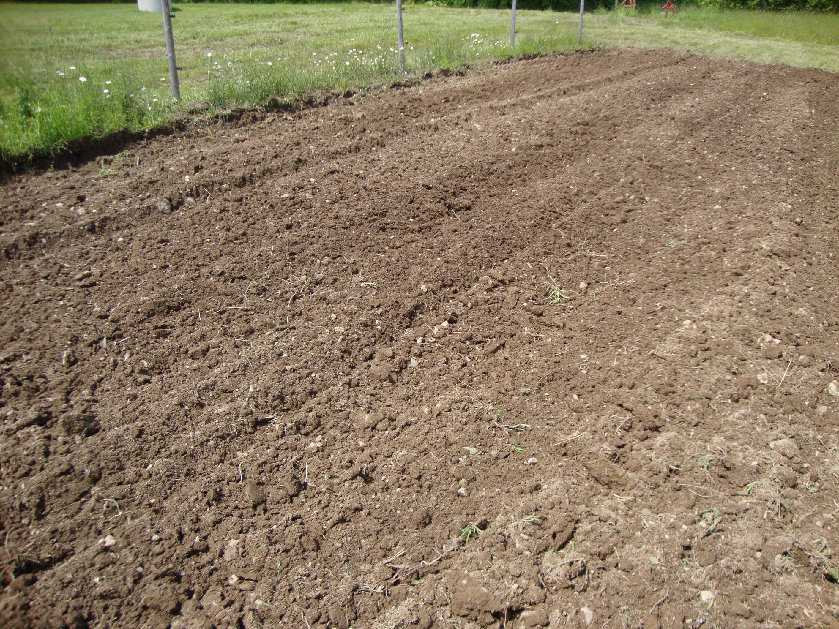

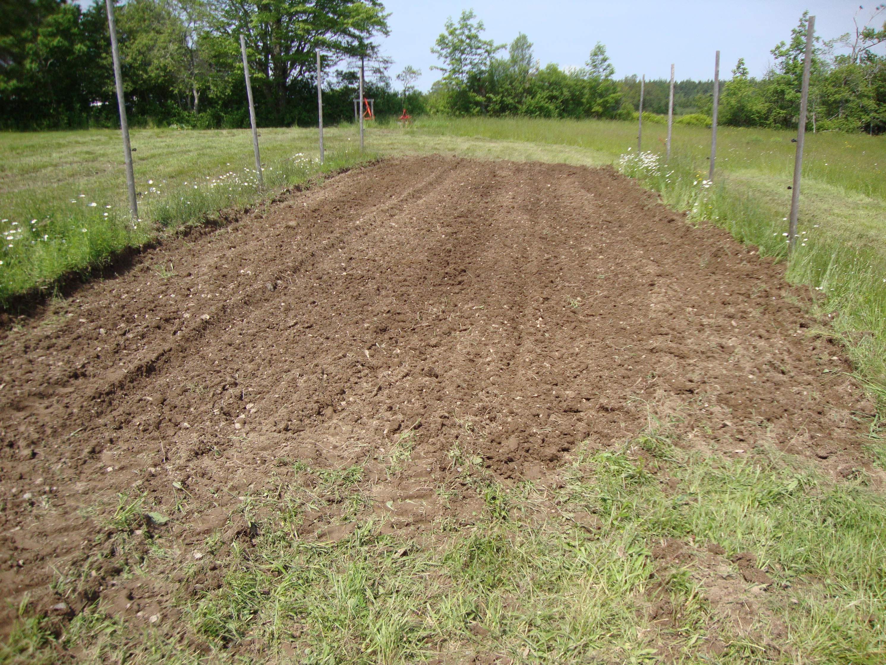

Today was harrow-the-garden day! It's been so wet that it was my first chance to get in the garden and do some final prep for planting. It's a late start, but there's no help for it.
First impressions are really good, much better results than last year with a single row of discs. The added weight of the second row holds the first set in the ground much deeper than before, and they break up the soil better too. I'd say I'm getting 100% depth (to the axle) on the first row, and maybe 75% on the second as well. The soil is still predominantly clay, although we're adding composted manure and peat moss every year to improve it.
I adjusted the top link to allow the front set to touch slightly before the rear to help it dig better, and it works.
Now it's time for paint and some final finish welds and trimming and we're done.. incidentally, the 8 bearing housings took almost 2 full tubes of grease before it started squeezing out!
As luck would have it, it rained this afternoon, so planting will have to wait for another day.
