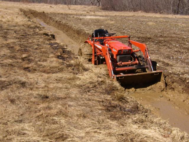

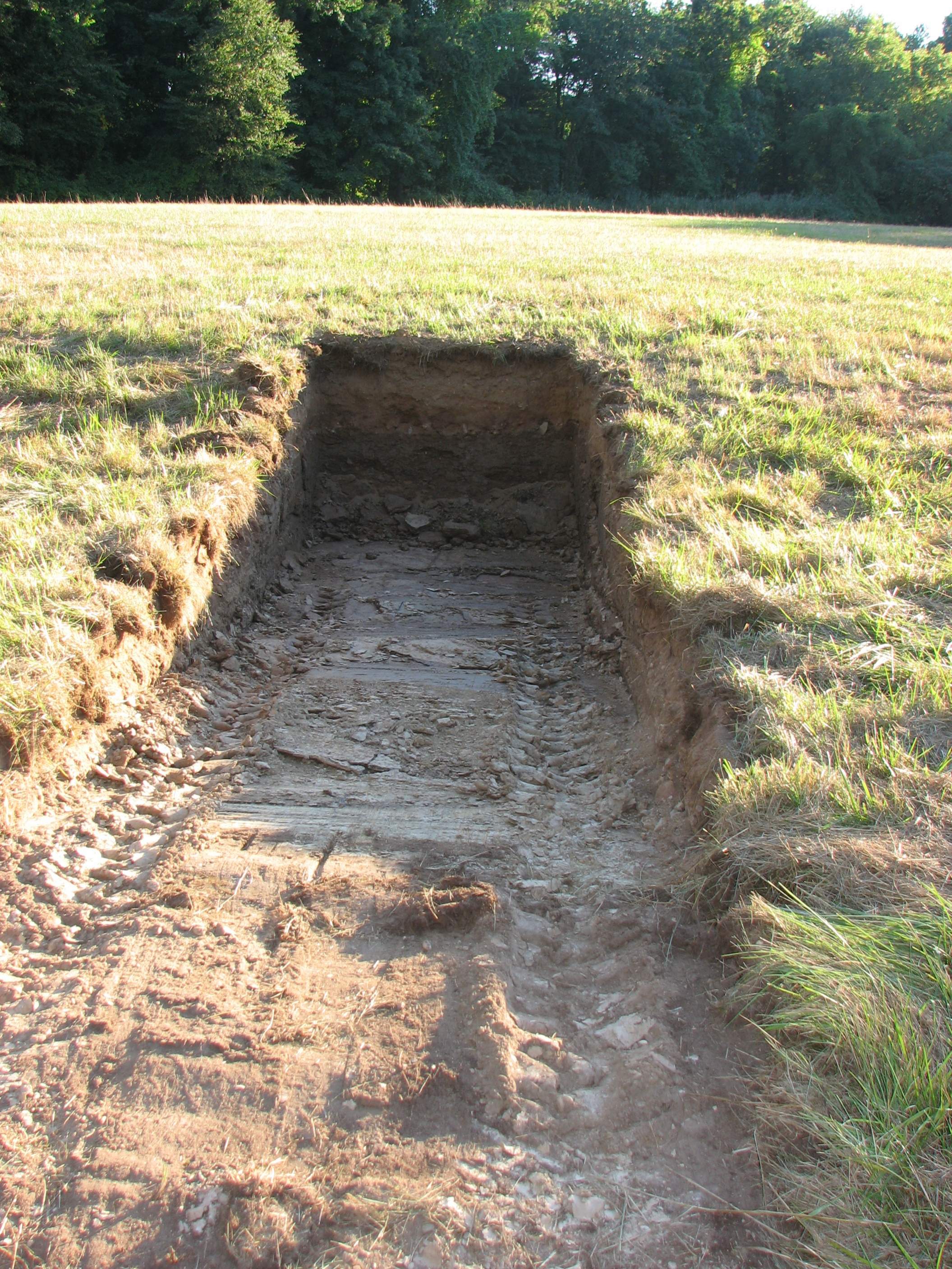

The first job I did with my tractor after it was delivered was to dig a trench to find out what the soil under my field looks like (and to learn how to use the loader):
The Plant Manager inspects the work:
Varved clay profile:
Shaved about an inch with each pass. Getting the sod off the top was the most difficult, as it was the first task & I had 0 FEL experience.
-Jim
