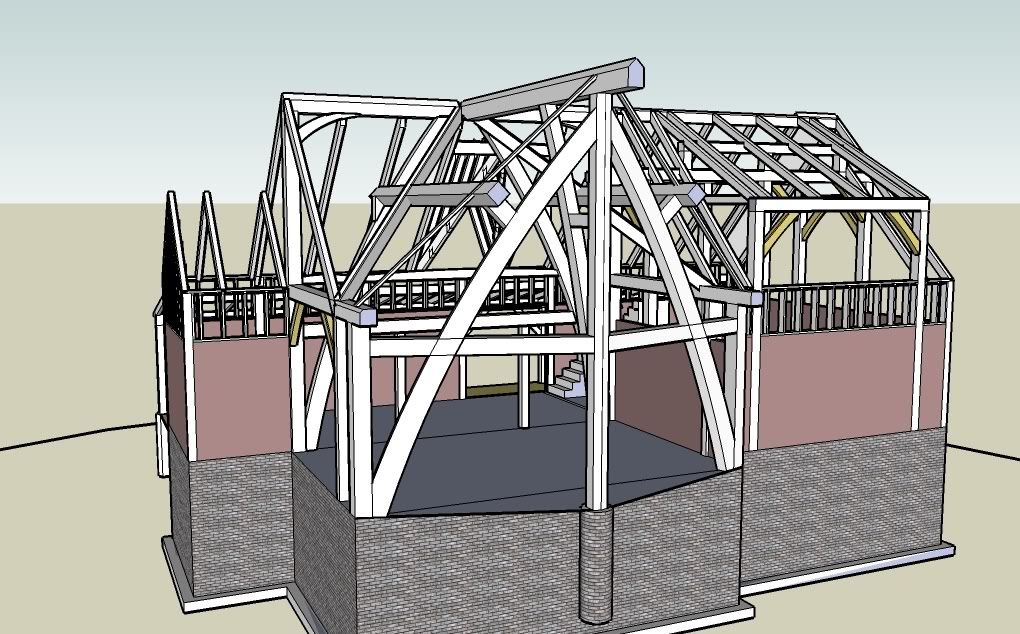

next on the list is dig all around the house to replace the weeping tile and under pin four corners of the house for point loads for the addition. Hopefully one day we'll have something that looks like this or something with a roof/windows/walls and such:D:D:D (this is just a SU model to show the framework) :D
