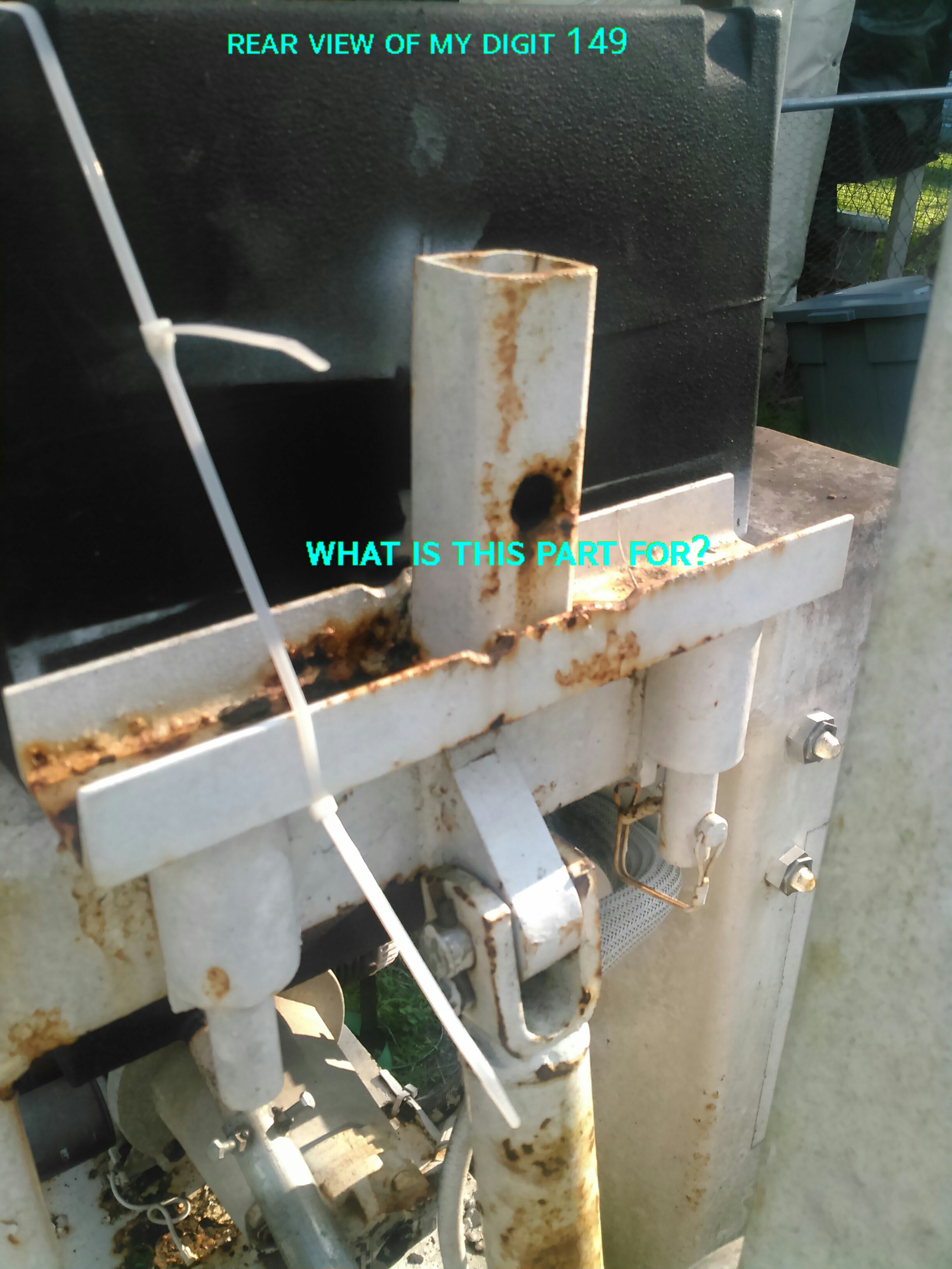

Does any one have this adapter part on their machine? What is it for?

I am having trouble opening your image to see what the adapter you are questioning is.
   / Dig-It towable Backhoe partial restoration #126
   / Dig-It towable Backhoe partial restoration #127
That is a interesting backhoe, never seen those before.
Looks like something slides over it and locks on with a pin due to the hole, maybe a sunshade? If it points up behind the seat.
Jim.
   / Dig-It towable Backhoe partial restoration #128
I think in that position it is being stored for later use. But I have not figured out where is used. The digger has a canopy.
#129
hmm perplexing.. Mine does not have that particular mount on it. I couldnt even guess what it might be used for. I looked through my manual and it does not have anything listed there either.
   / Dig-It towable Backhoe partial restoration #130
Could it have been added on by a previous owner for something specialized?
