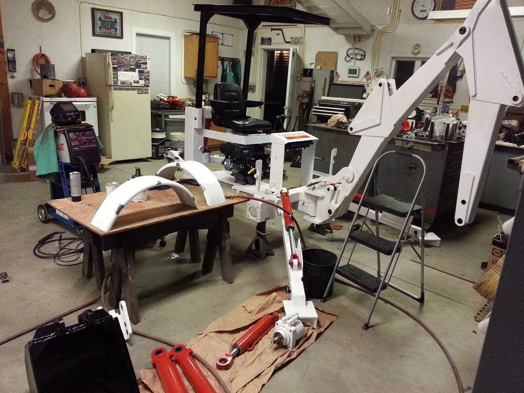

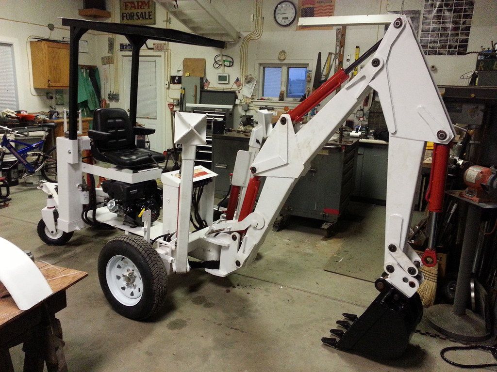

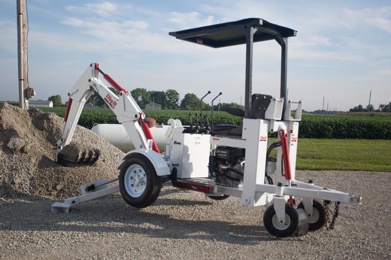

Over the past week we've got it to about 95% done. The mount that connects the bucket to the the cylinder was a little tweaked and my brother would like to replace it, so that'll be the last thing to get it going. Other than that we just need to clean it up, touch up some paint, weld the fenders on, run some lights, and put on the fresh decals.
Now we're interested to see how this little guy digs.
I'll post up some more pictures when it's complete.

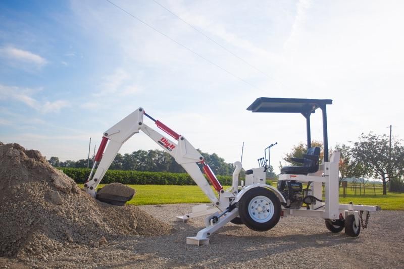

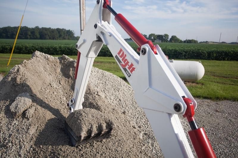

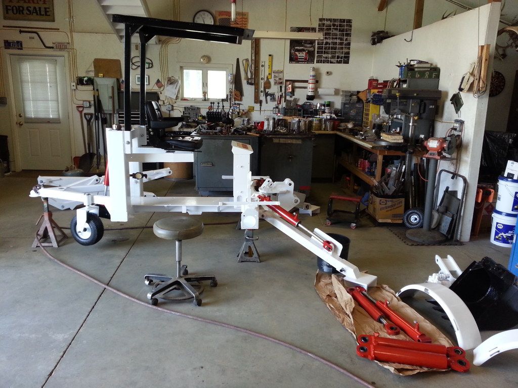

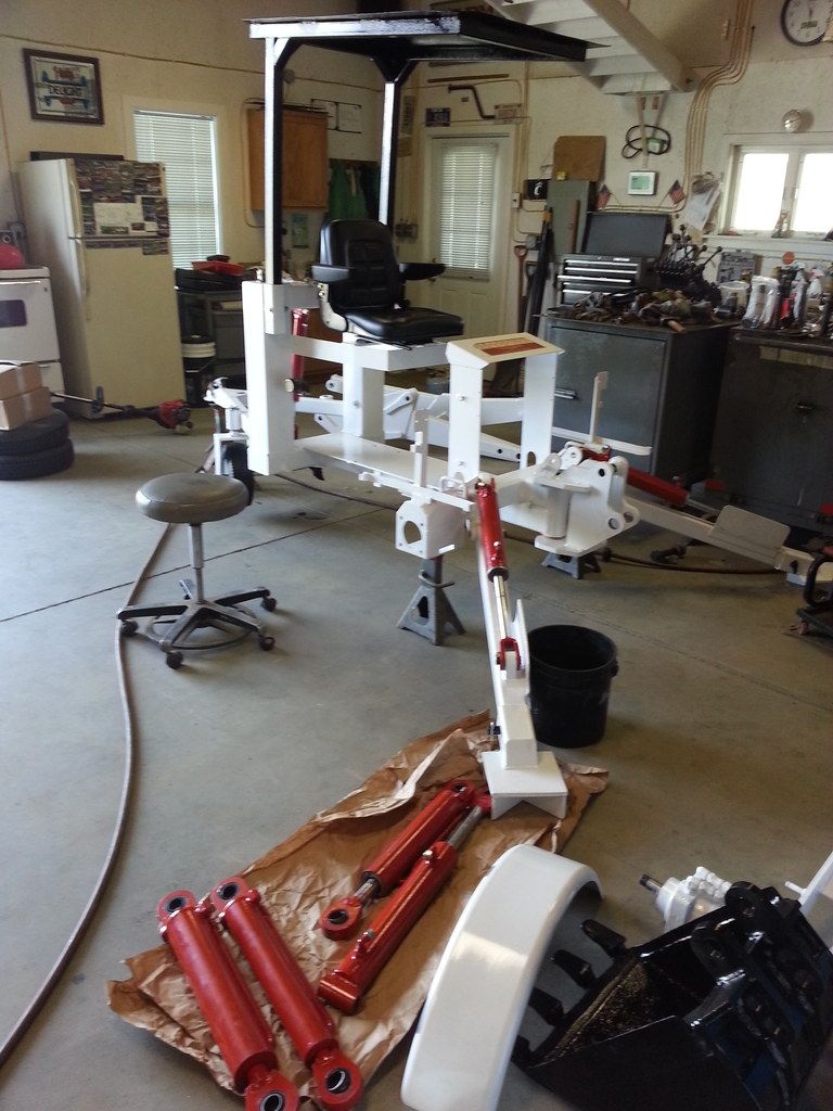

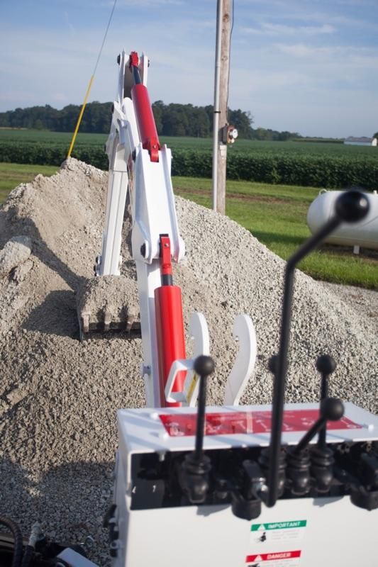

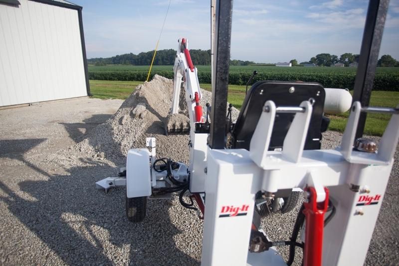

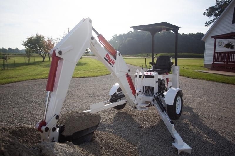

It has tightened up substantially from before, still has a small amount of play but not bad. We've yet to really use this, as we were wanting to get it as close to 100% as possible and it's been raining so we don't want to be digging in the mud.
I'll let you know about the two movements at once.
Attached are some pictures, only things left to do are wire on the led tail lights and put the hour meter on. This thing has been a lot more work than we thought when we bought it. We ended up replacing the front outrigger cylinders as well, they were seeping and we found a standard size one that worked with a little grinding.
