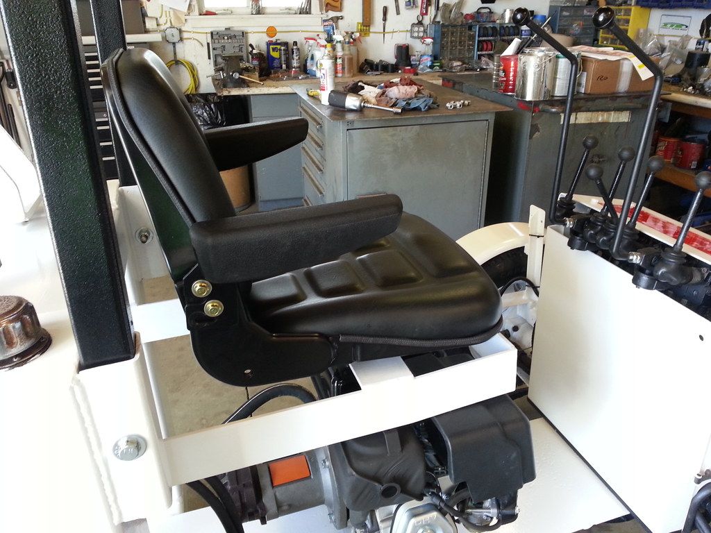

The adapter plate you posted is very similar to the one we bought, my brother actually purchased that part so I can't give exact model numbers just make sure it mounts to the pump and motor but it looked to be almost identical. One other thing is the Lifan 15hp just barely fits under the seat mount. I'm not sure if the 158 is the same in that regard but that's one thing to consider as the 670cc 22hp predator I would assume is a bit taller than the 420cc predator.
Showing the minimal clearance.

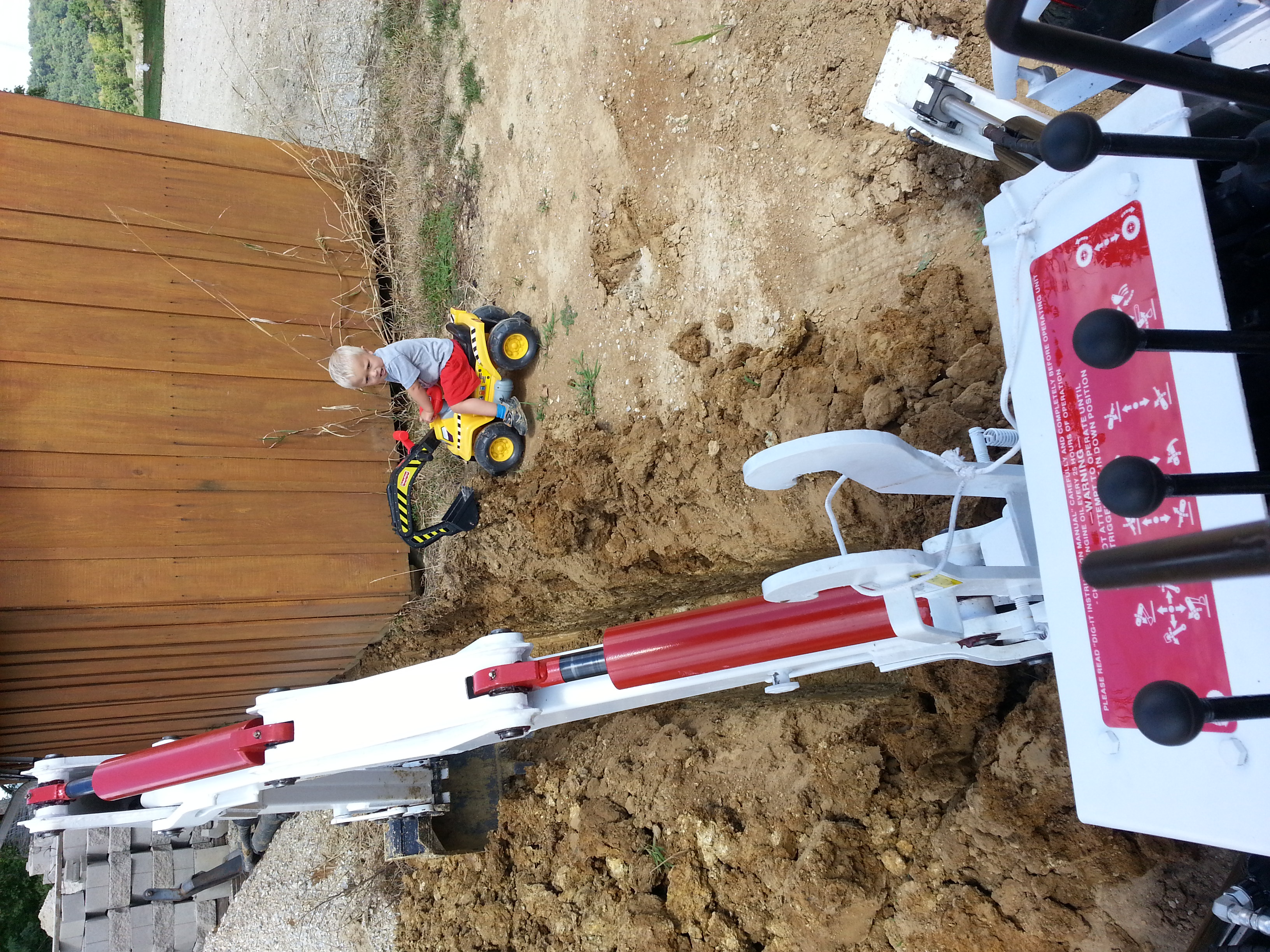

The valve block we just used a wire brush and cleaned up. My brother opted for the multi control, it allows you to dig with just two of the sticks instead of 4. I'm not sure if your's has this but ours didn't and I could see it being very cumbersome to use in that configuration.

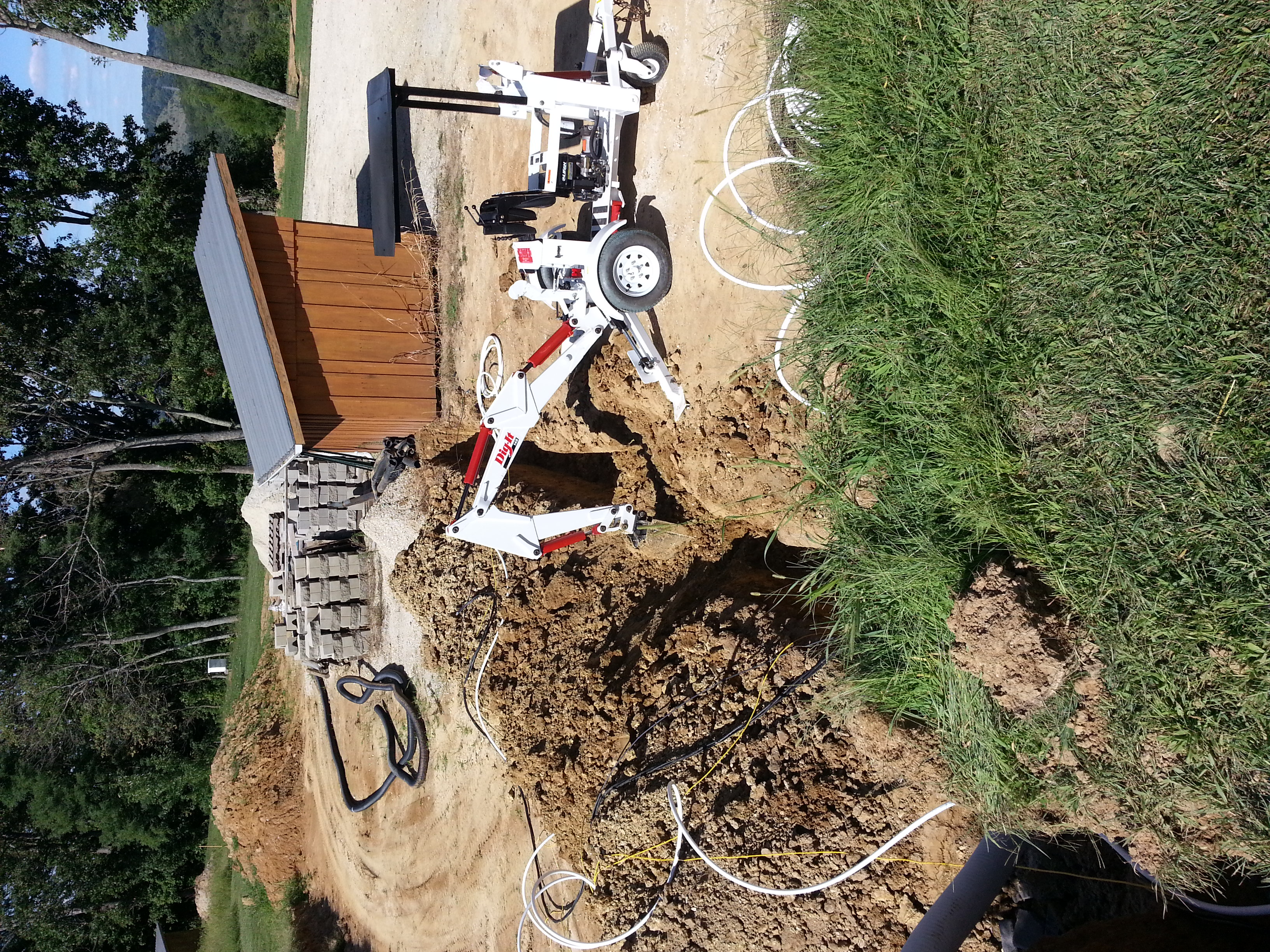

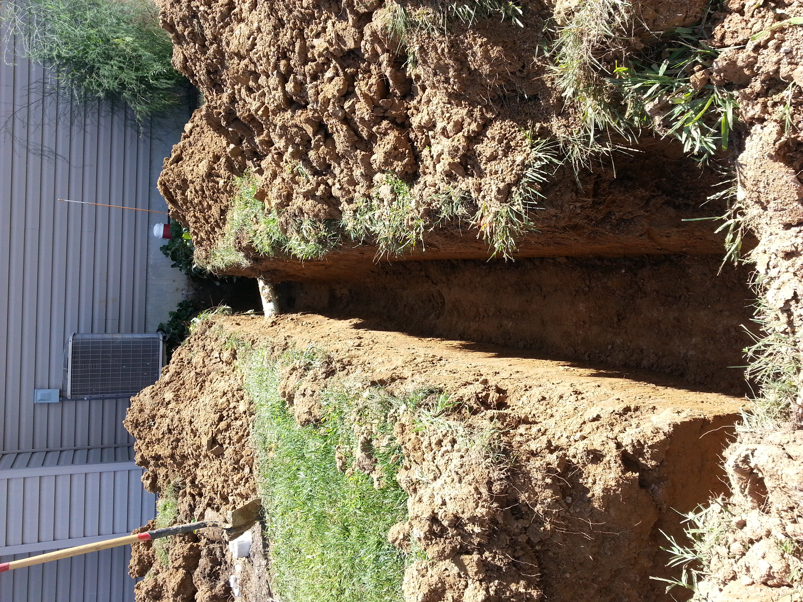

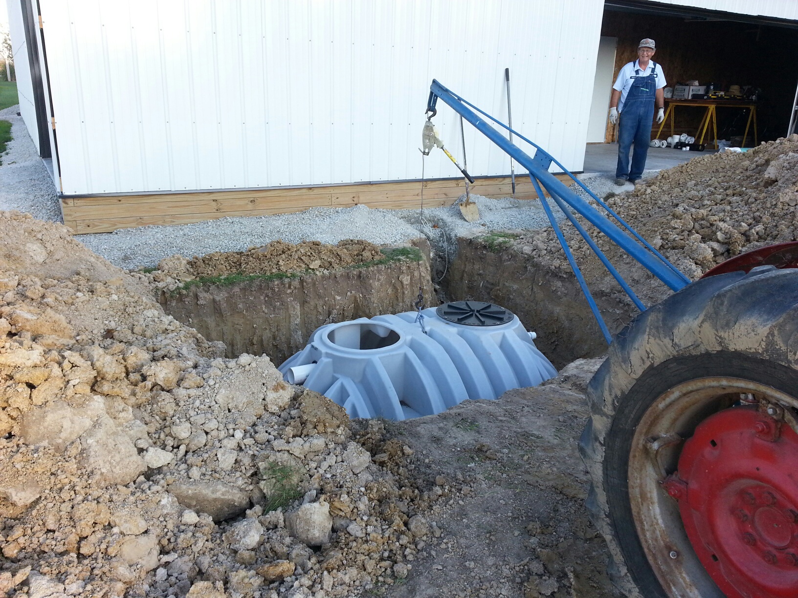

Here are some of the project we've used it for. The cistern was about 7' wide x 10' long x 7' deep hole. It took about 4-5 hours to dig. The hardest part about digging something like that is finding a place to put the spoils. It would have been handy to have another person on a skid steer moving the spoils out of the way.
