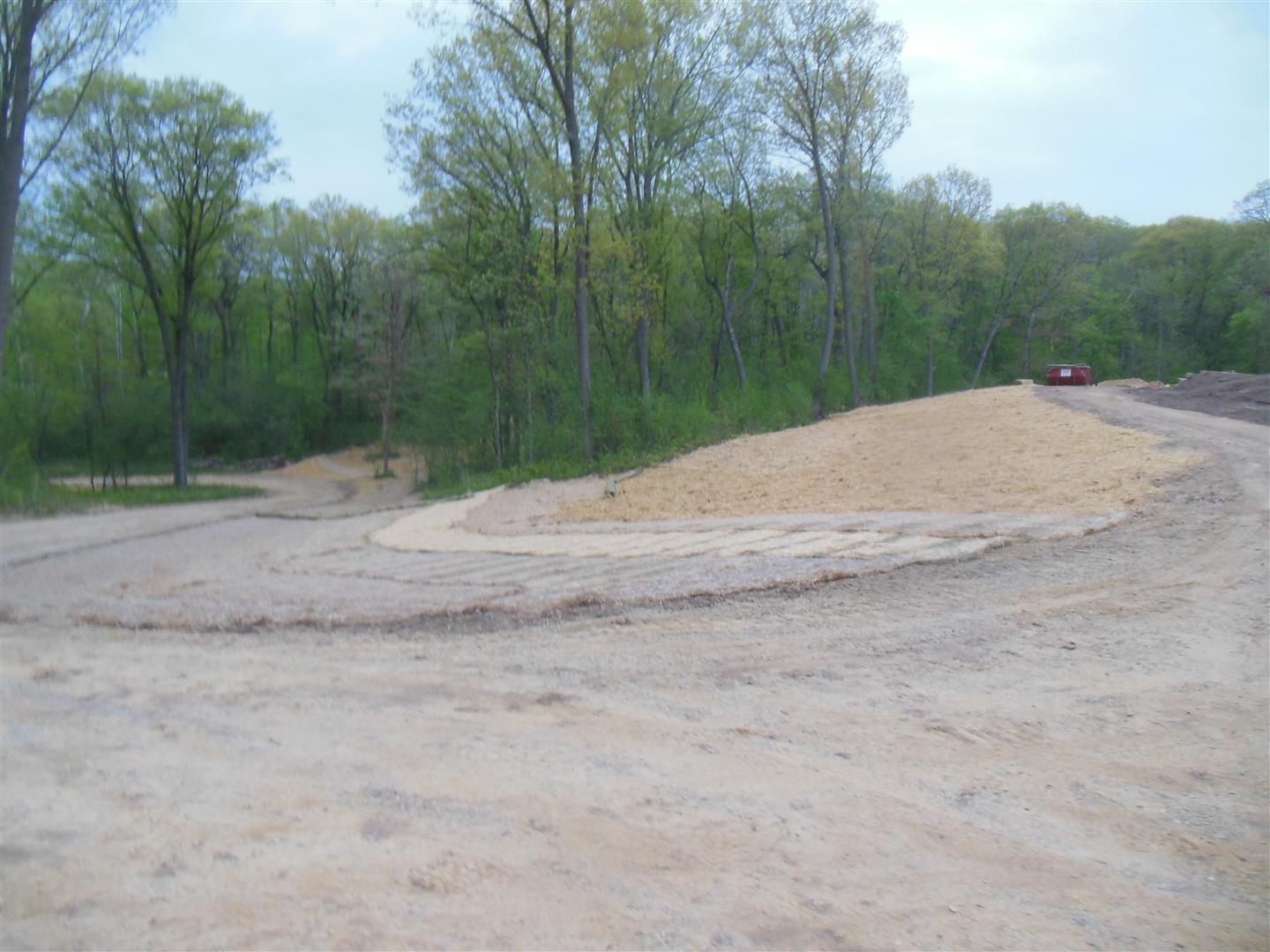

I need a mowing solution for our new place. It is pretty steep and built partly into a hill. The lot rise 60-100' from the street to the building pad area (unevenly, of course), and there are some very steep sections due to grading. Some parts are close to 40 deg, which is not area that I am planning to mow as that is pretty much impossible for anything I would consider getting. The steepest sections to mow are probably in the 20-30 deg slope range (guessing a bit here). Here are a few pics, but remember pics always make things look less steep than they are.
This area is going to need to be mowed. It rises ~10' in a 20'-25' or so run, I would say (the steeper bit is towards the house). This is one of my bigger concerns.

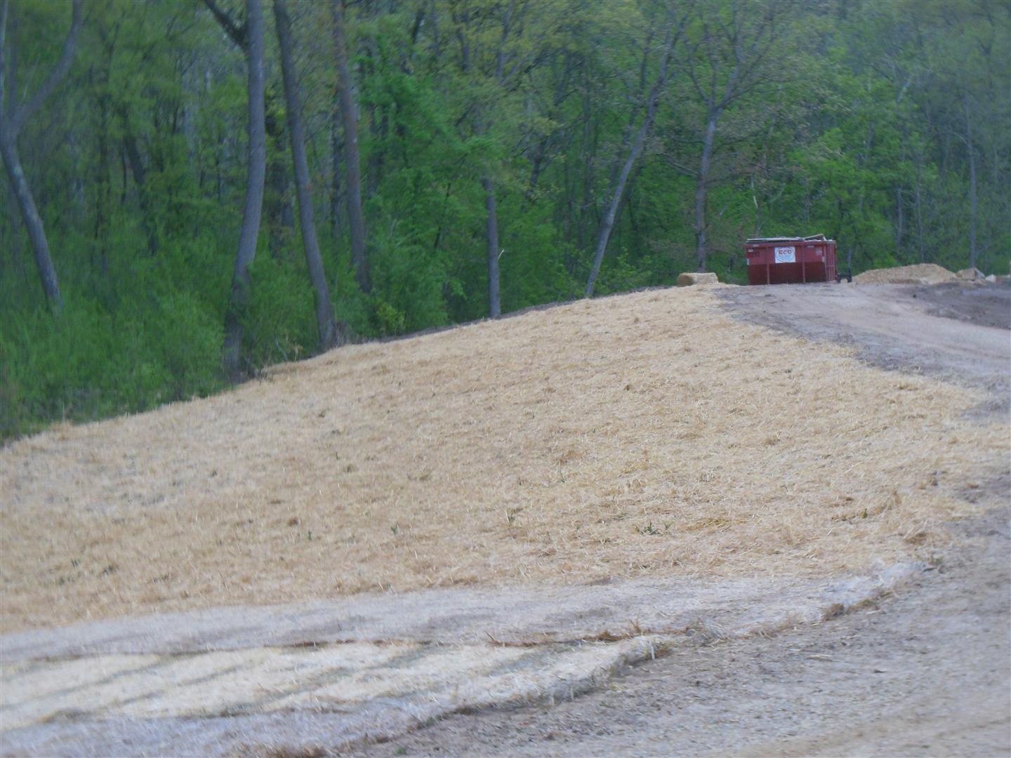

Looking down the driveway to the street. That right side will need some mowing

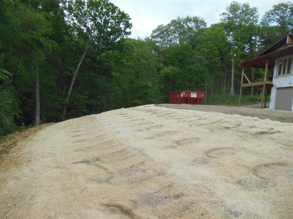

The really steep section. Gets worse the farther back you go. Maybe 1/3 of the way back the pucker factor on my L gets too high for me...
Close up of the steep section, where it starts to get silly.
So what am I looking for? Options. What is clearly not going to work, what is a good idea to try, and what is the bees knees. Most of this is too steep for the L to work on with a RFM or bushhog, and it is also a bit small for anything like that. it is a big lot, but it is 80% wooded, so not a lot to mow, but what there is, is challenging. So would a basic 2wd riding mower do it? How much power? Do I need something with a diff lock (looks like X500 or above?), or is 4wd the only way (and I ain't spending that kind of money, certainly not now...). I am pretty sure I do not want a huge deck - 42-48" max as it will be hard to maneuver with all the hills and cuts and stuff.
JD seems like the only game in town once you get beyond the simple stuff, so lets hear it!

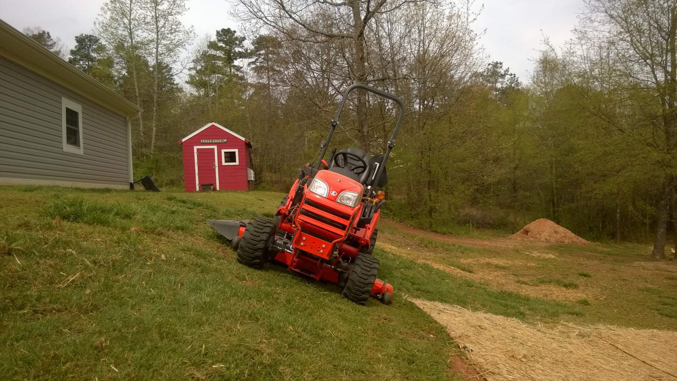

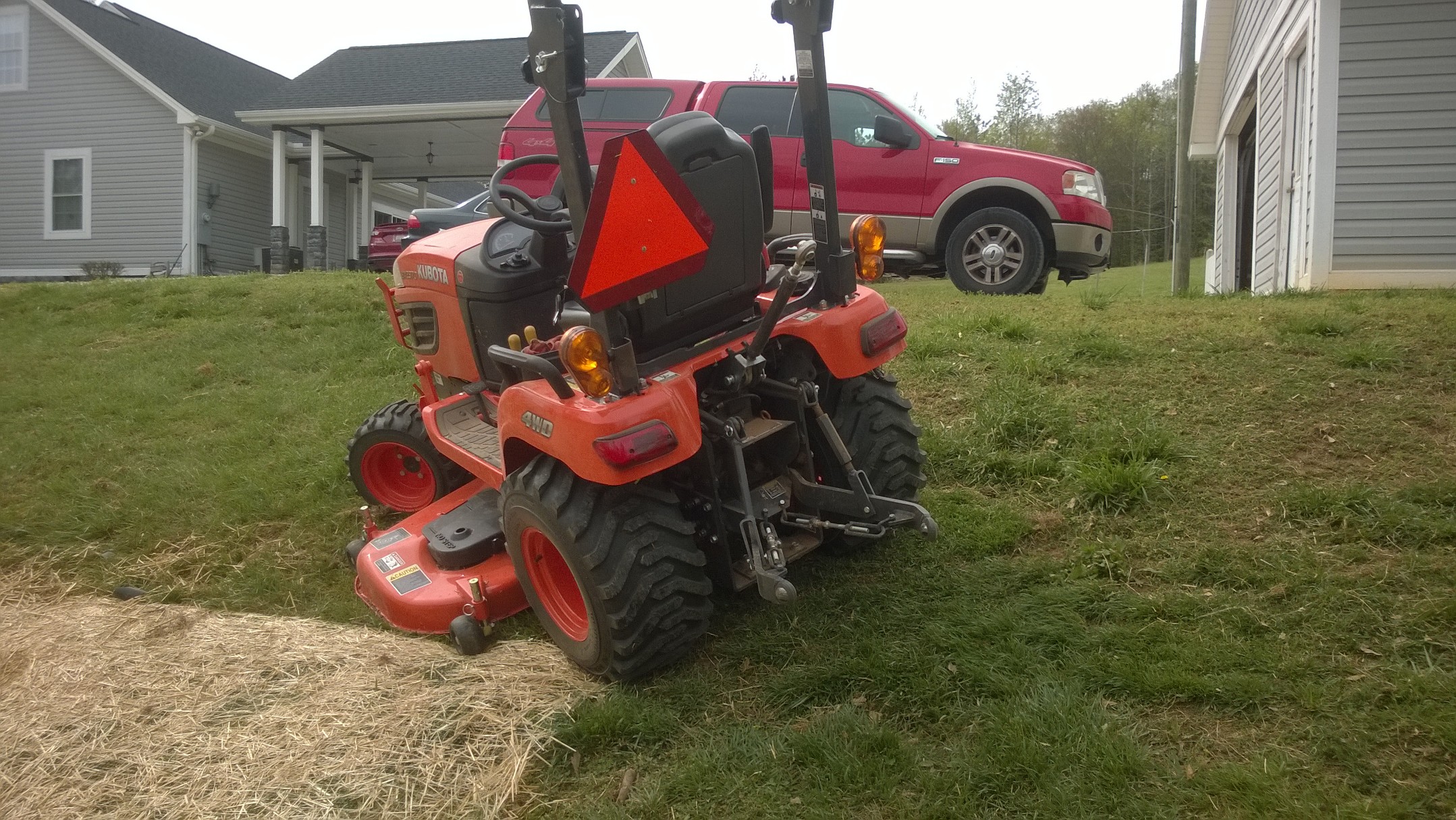

BX-2370 is what I'm currently using. Much more stable than my old lawn tractor.
I can do complete 360 turn on this slope. Don't have to lean uphill. Have rear wheels filled. Have some steeper stuff than this at my other property that I mow. Will take photos one day if I think about it.

Tractorshopper - I think I am a bit steeper than that in the parts I am concerned about. And there is no flat spot at the bottom like you have, so no way out if it starts to go bad. If I tip it on the side there, I am into the woods...
