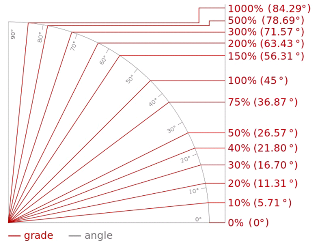

Sometimes grade % and degrees of angle get confused. Here is a chart that shows what is what.
attachment.php
/ Difficult lot - mower suggestions? #36
Yeah its funny when some folks brag about there mower working on 60 degree slopes :)

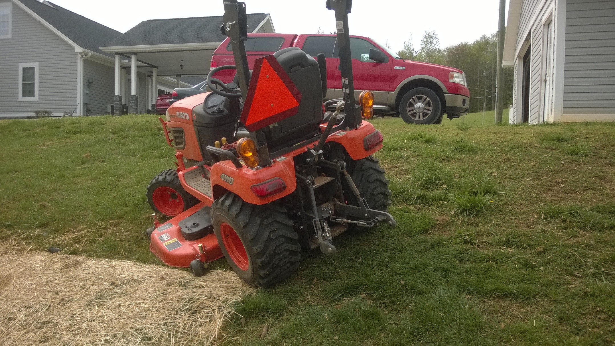

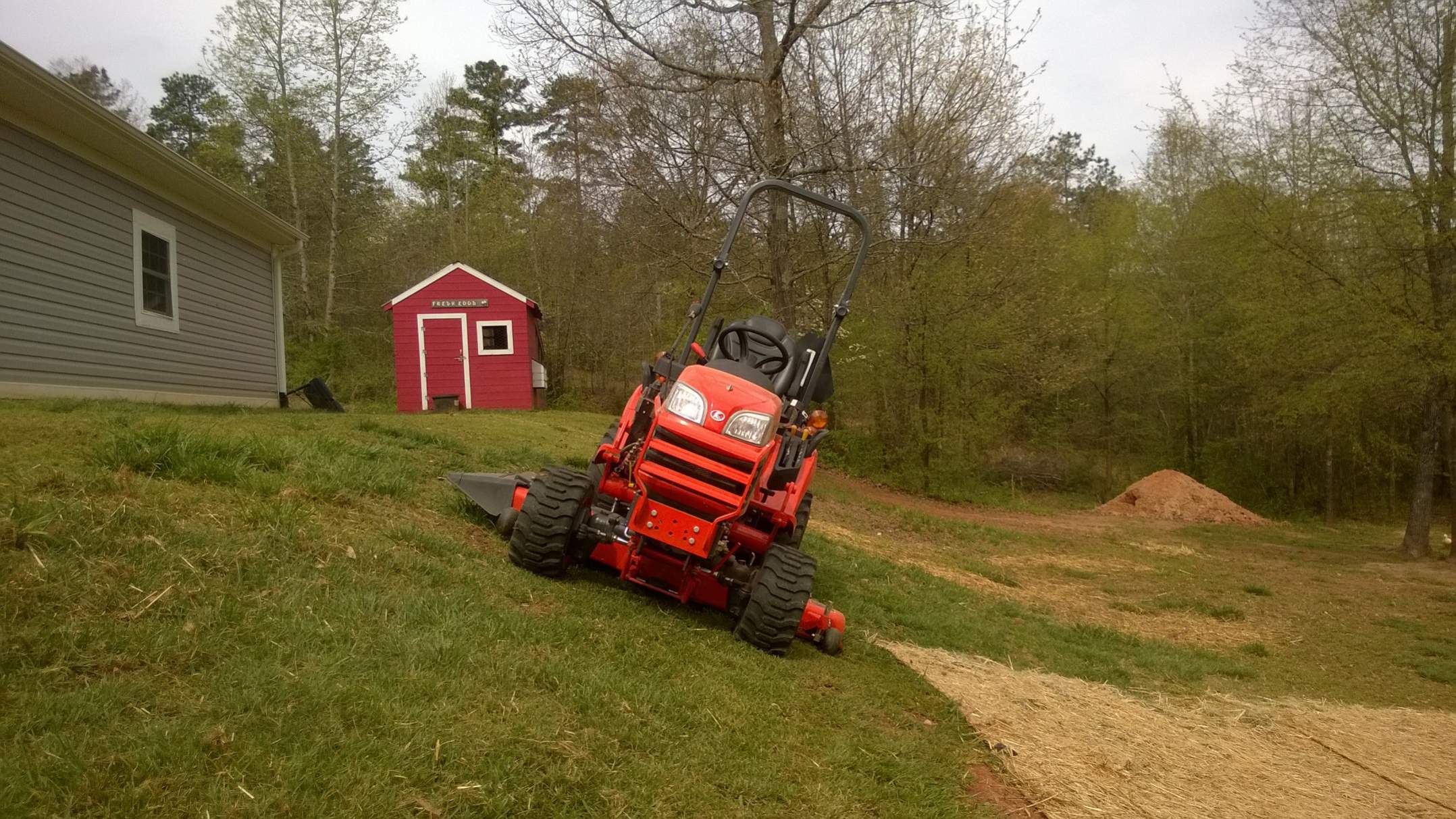

Perhaps the photos are deceiving but it doesn't appear steep. It would be nice to have something in the photos that is true vertical for scale.
I used to have no problem mowing the ditch with my 2210. Until the highway department resurfaced and upgraded the road and left the ditch face that was once 20 to 30 degrees is now 30 to 40 degree slope to the shoulder, that is a bit too steep even for something with a low center of gravity as a 2210/2305 (1023 is the latest version).
