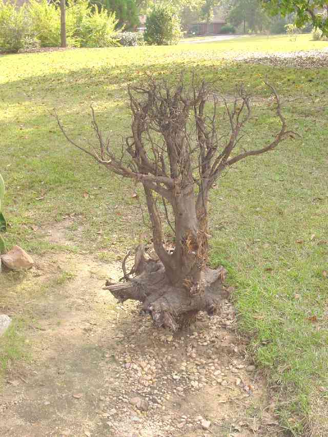

Hello TBN Friends,
I saw this a couple of days ago and since we were removing a black walnut to make way for shed expansion I thought maybe you would like to see a balck walnut uprooted.
It had numerous lateral roots. After we dug and cut some on one side, hooked chain approx 10 feet up the trunk and B2910 pulled until trunk was almost parallel with the ground but looked like stump was not moving. Unhook chain, push opposite direction show some loosening. Took a HEAVY metal box and placed next to trunk to act as fulcrum, hook chain again this time with fulcrum in place it pulled right out. The trunk is 8 inches dia.
Now the next one is a little larger. I'll let you know when/if we get it out.
