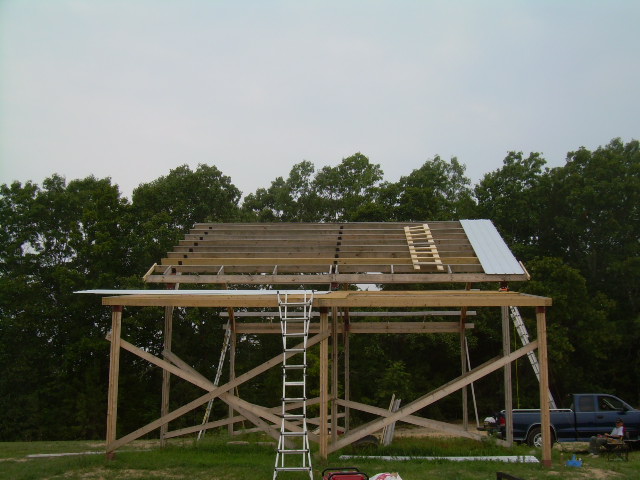

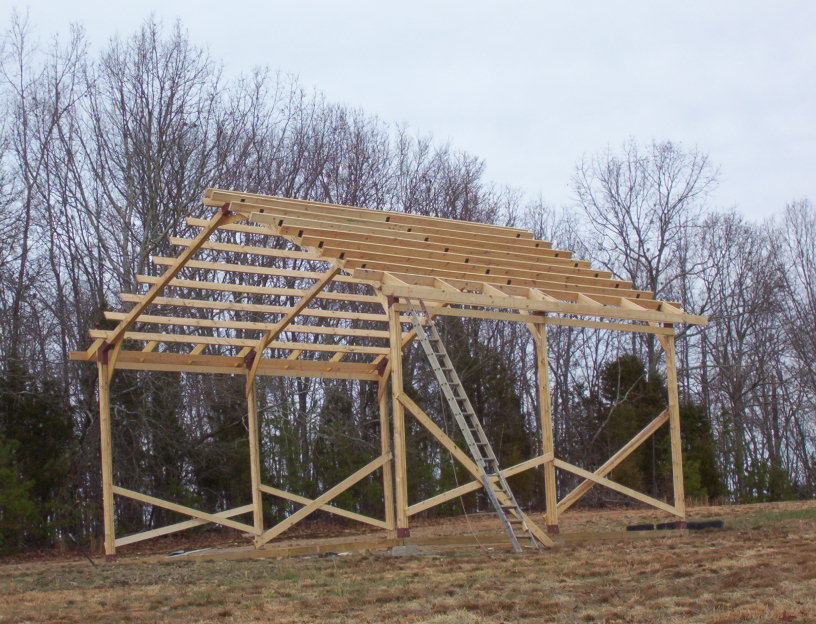

phase 2 is finally complete - roof purlins have been installed. 55 degrees on New Year's eve was helpful. see link below for pics
Barn 4
next steps are installation of support beams for loft floor and installation of metal roof .
was hoping to have a roof over the tractor by Christmas....oh, well, it might be there by spring.
progress reports to follow as progress is made

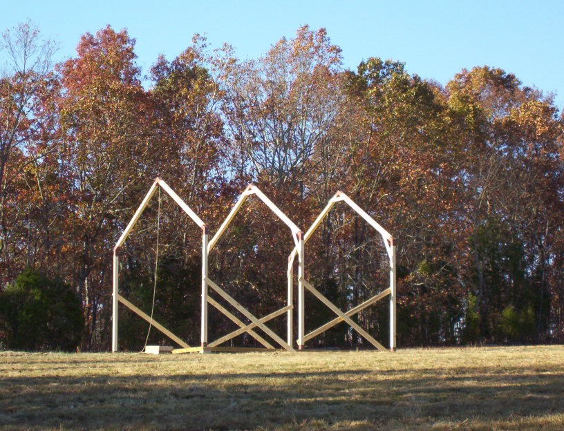

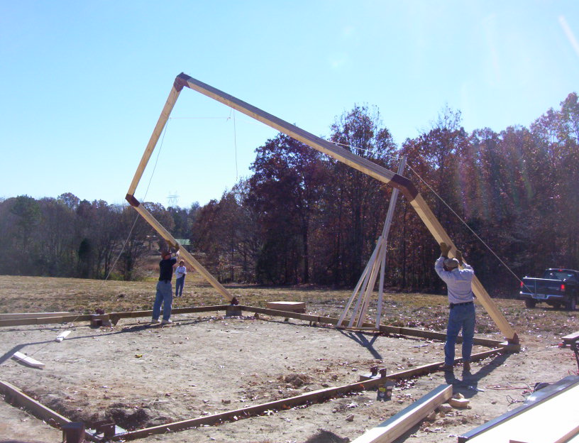

kwTN,
I saw on another post where you've made more progress and added a 12'x24' shed. Any chance we could see additional progression pics (if you have them) to get to the point you are now with the barn?
Also...it appears from the previous pics that you constructed your post by laminating 2"x4"s and 1/2" plywood. True?
Jim H.

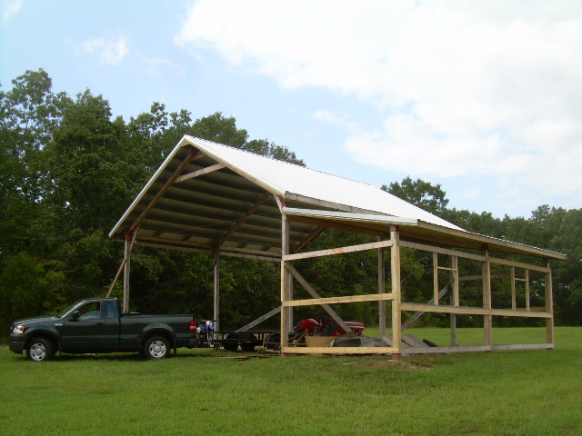

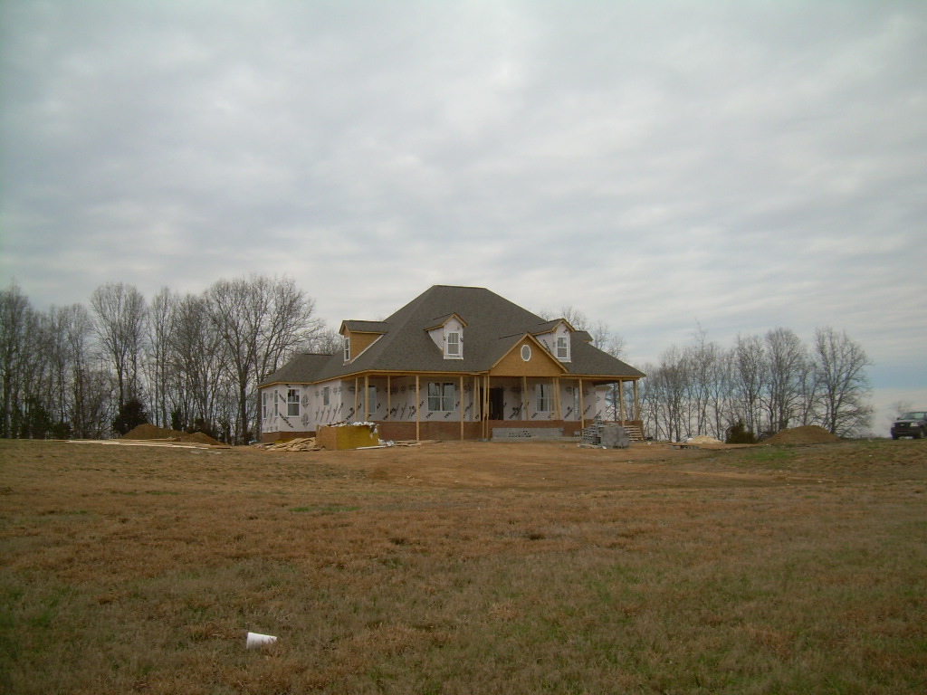

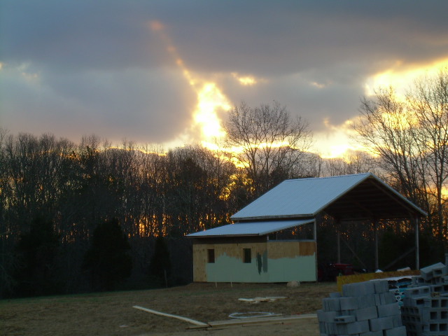

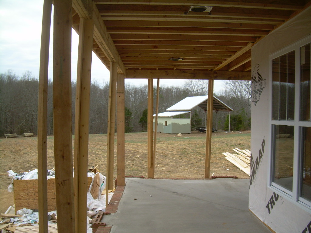

/ Different Pole Barn system? #28
The vertical & diagonal posts consist of (3) 2x6s with 1/2" (don't remember for sure) plywood sandwiched in between. The attached pictures are a quick progression from beginning to now. Right now the exterior is being used as a test pallet for the color of the new house currently under construction. The focus is now on finishing the house, 500' driveway and 2500' of fence.

kwTN - Appreciate the pics. Wow...looks like you've got alot of building projects going on all at one time. House looks good. Nice to have a testing spot to try out different color palettes. Sure beats having to repaint after the Mrs decides she doesn't like it once you've finished! ;)

kwTN,
How do you plan to handle the wind loads on the barn?
Leo
/ Different Pole Barn system? #31
not visible in the pictures, there are steel cables running in an x-pattern and from side to side at the top of the vertical posts. I've been in the barn in some pretty heavy winds and it doesn't move. by the time it is completely sided, there will be laminated beams and floor joists for the loft tieing things together even better. Fortunately, the usual at my place is just breezy and 'high' winds are rare.
