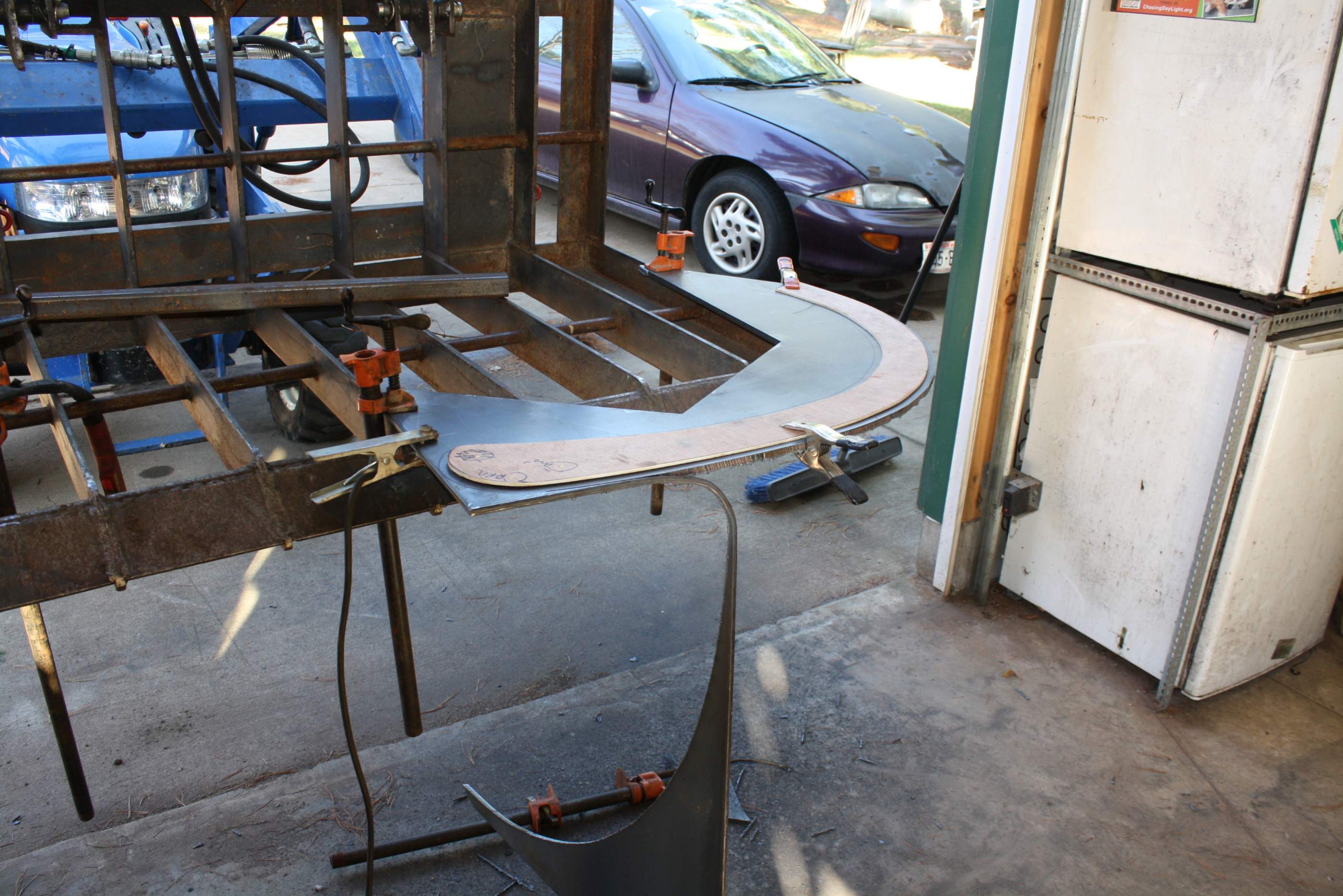

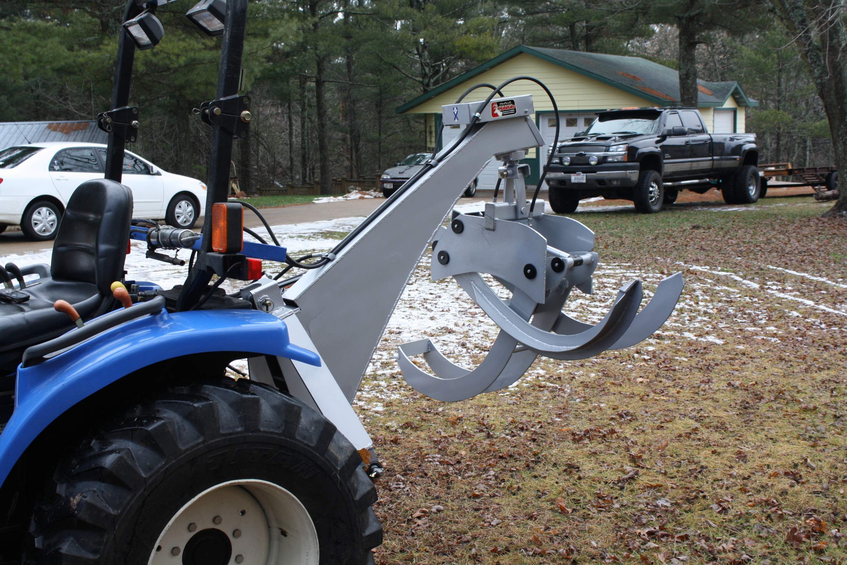

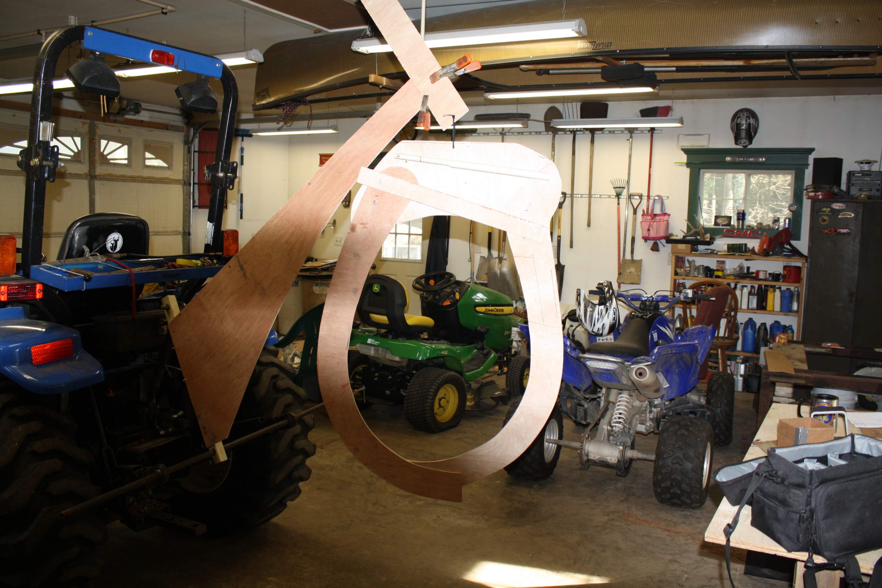

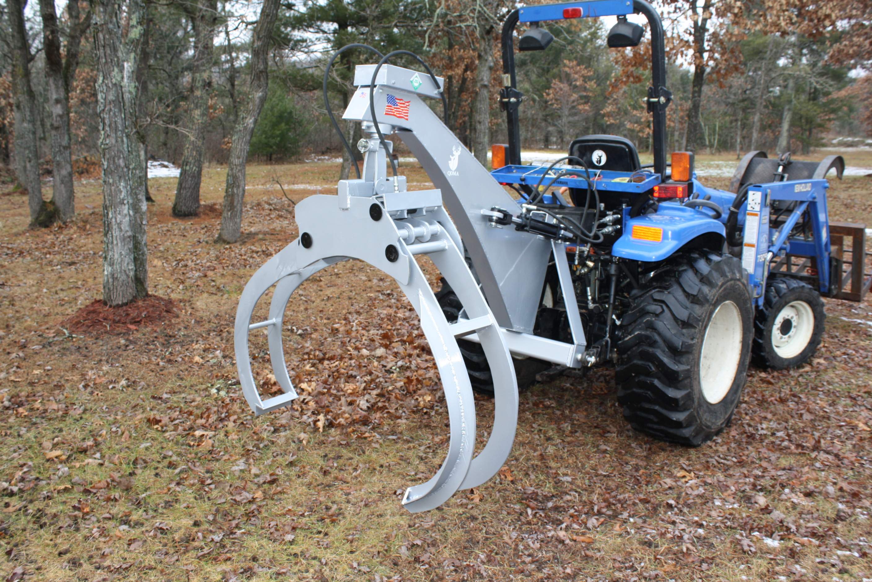

Heres a few pics of a log skidder type grapple I recently finished. I have some red pine plantations that need to be thinned this winter and hope to make good use of it. Fire away with questions or comments. I did a few preliminary pulls with it before painting, but dont have any good pics, Ill try to get some action pics if I think of it.

I see you have a swing cylinder can you also rotate it ?
How much does it weigh and how big a log can you drop it down on ?
Are you running a fixed or hydraulic top link ? (From the picture it looks fixed maybe)

Yes it swings from side to side hydraulicaly (sp?), it does rotate but only if you were pulling a log around corner, then returns to center, via spring. Spring is under the box up on top.
Havent calculated the weight yet, I dont have a scale but have a link to a weight calculator so I will try to get to that.
Point to point opening is 39", widest inside spread is 52".
I'm using an "adjustable" fixed top link. Not sure if there would be an advantage to a hydraulic for this or not. Other than a reason to buy one.:)

THANKS for all the compliments!! I will get some more pics, I needed 3 hydraulic circuits, 1 for the clam, 1 for the swing, and 1 for the front grapple. which I want to be able to use for piling pulp. My tractor only has 2 rear remotes so I had too put in a selector valve, so with the pull of the valve I can switch from the swing circuit to the front grapple. I also put in a couple of needle valves to slow things down a bit. I will shoot some pics of the hyd. tommorrow and post.
