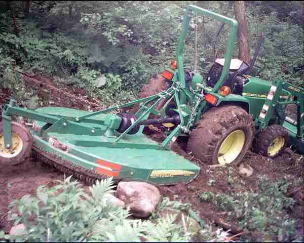

I have used both R1s and R4s in mud before. Yes they were different machines but its strait data that im looking at. My Yanmar has R1 tires in which i have used in muddy conditions quite a bit. This is a US market tractor with the US R1 tire, not rice paddy tire. That little tractor hasnt got stuck once since I owned it but it has come clse a few times. But every time I either put it in a higher gear or Used Differential lock and it would pull right out. They arent the best but here in Oregon our snow is very wet and packs into a thick layer of ice. The narrowness of the R1 takes away ground contact which will reduce traction efforts in the right soils. I have used R4s on the 3720 and the skidsteer and have got both stuck. I usually can use the bucket to push out of the mud but the height makes it a lower stance whicg will bury the axle quicker. The R1s on my Yanmar ride really well on the road, I have ran on the road in high gear for about a mile from my uncles to my grandparents on a back country road. great ride, similar to R3s and R4s on the road.
/ Diff between R1 and R4 tires? #43
I have seen many similar pictures with R1s. If the ground conditions are right, ALL tires will load up and you will have slicks, that is just the way it is. This has been said here and before many times.
Really.??
Post 'em up...them those pictures of Ag's loaded up in mud about as deep as the tread.
Same thing often happens in snow. R4's load up.
First off, I said that I have seen similar pictures, not that I had the pictures, and I don't care to spend the time to find them.
Second, do you think that if that tractor had R1s, that it would not be stuck? It looks as though the mower is the actual cause of the problem in that picture. I suppose that if it had R1s, maybe the extra height from the tires would have prevented the tractor from getting stuck, I can only guess at this point.:confused3:
