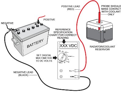

Proper way to check antifreeze condition
I have never checked coolant with a voltmeter, but would like to look into it. Do you have the reference chart referred to in the picture posted?
I do check the concentration with a refractometer, which I find to be much more accurate.

I will generally check for DC and AC voltage ....many things can cause stray currents to flow within an coolant system , dissimilar metals and out of range PH balance , missing block ground ,faulty alternator can induce AC currents. Just to mention a few .....its a simple test used along with test strips and refractometer...cheap Insurance just my humble opinion ...
