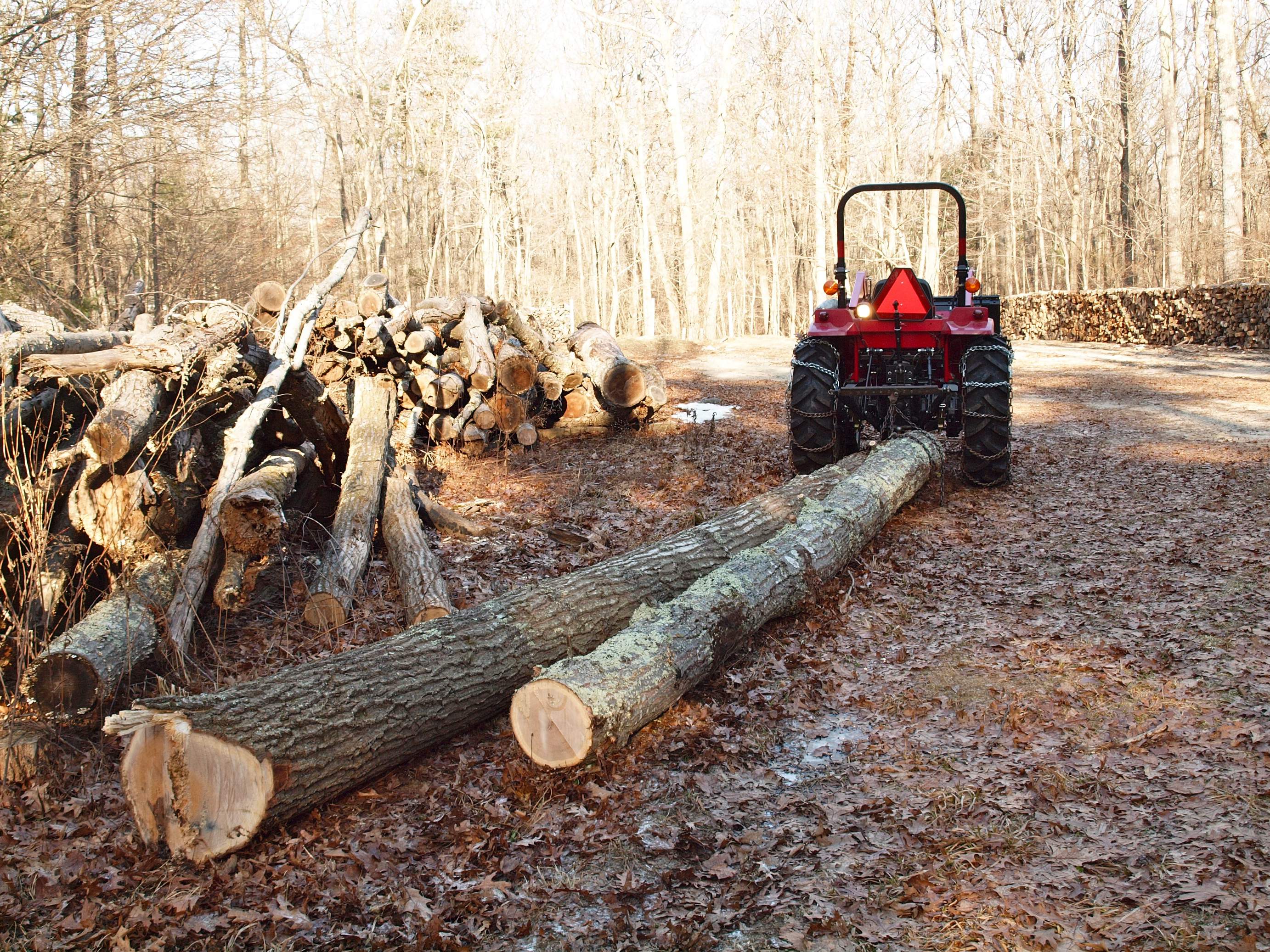

I've logged for 40 years with a 1/4" chain.
