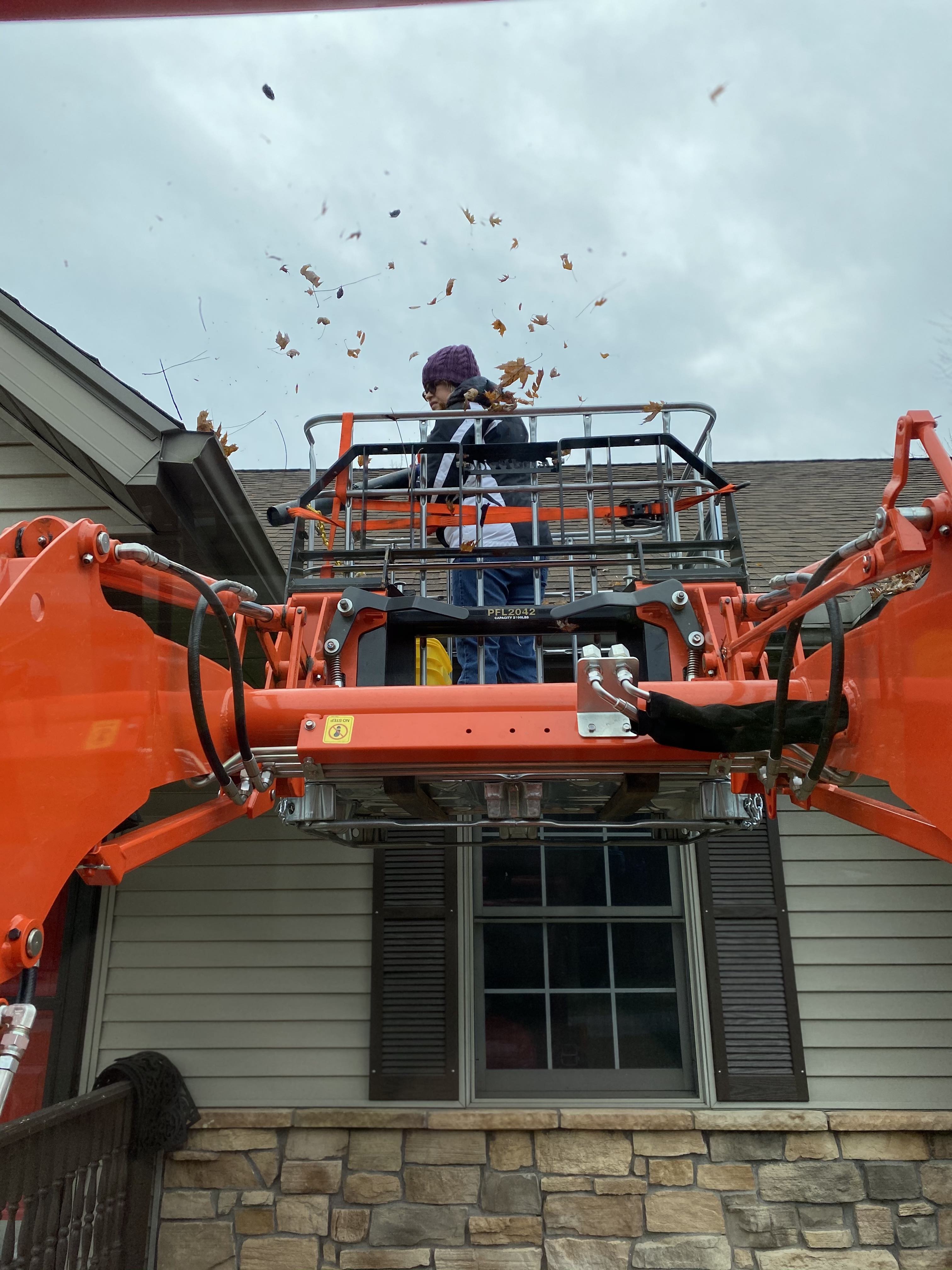

In any hose failure regardless of speed you’re probably going to end up dumped off your platform. But I still stick to my belief this is much safer than a ladder. Add a pressure washer or chainsaw in the mix and the man bucket is by far the safer option.

Yep works great have had the wife up in it many times. I put yellow safety chain on the entry side and I have chains at each corner bottom (visible in the attached photograph) that prevent the tote from sliding off the forks. I used the ratchet strap to tighten everything down.

In 35+ years of tractor operation myself, and adding the experience of several other close friends and family, I do not know of one single 'hose burst/loader or implement fell' incident. Hoses started leaking, yes. Cylinders leak down, slowly drop, yes. Bumped control valves, yes. Not saying it never happens, it does. Just saying the likelyhood is low, and the flipside of overall safer work conditions using this basket, is higher. I have access to the IBC totes mentioned earlier, and would be willing to let my 12yo son climb in that basket with me operating, sooner than I'd let him climb an extension ladder on sketchy footing. I'd do the ladder climbing myself before I'd let him. I understand the risks involved, and as is the case in life, compromise and choices are made daily. Be safe, yes. But you still gotta get the job done in a reasonably efficient manner.
I blew a loader boom hose on my case 580 TLB while carrying a load of gravel in the bucket. Hit the ground in under a second and my windshield was completely coated in hydraulic oil. Just a wee little hole in the hose. I know you have ZERO chance of getting out of the way if something goes wrong, don't kid yourself.
I managed to survive childhood even though my parents had a car without rear seat belts. That doesn't mean a lot of people didn't die in car accidents without seat belts.

If you have a set of pallet forks, buy one of those caged 270 gal totes. You can usually find them on CL for 35-75 bucks. Remove the 4 bolts holding the top bars on and pull the plastic tank out. Strap the cage (I use a 2" ratchet - way overkill) to the forks. You now have a man basket for trimming limbs, cleaning gutters or siding, or I'm my case helping pick apples before they drop. Not OSHA approved I'm sure, but as safe as you want to make it for sure.
