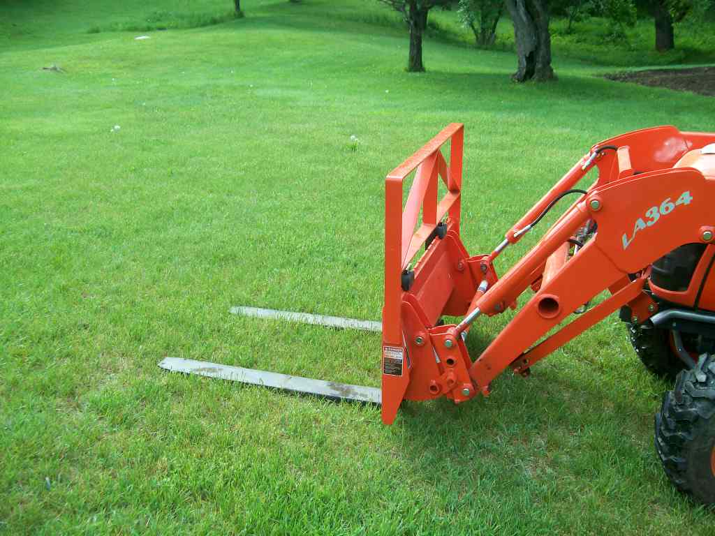

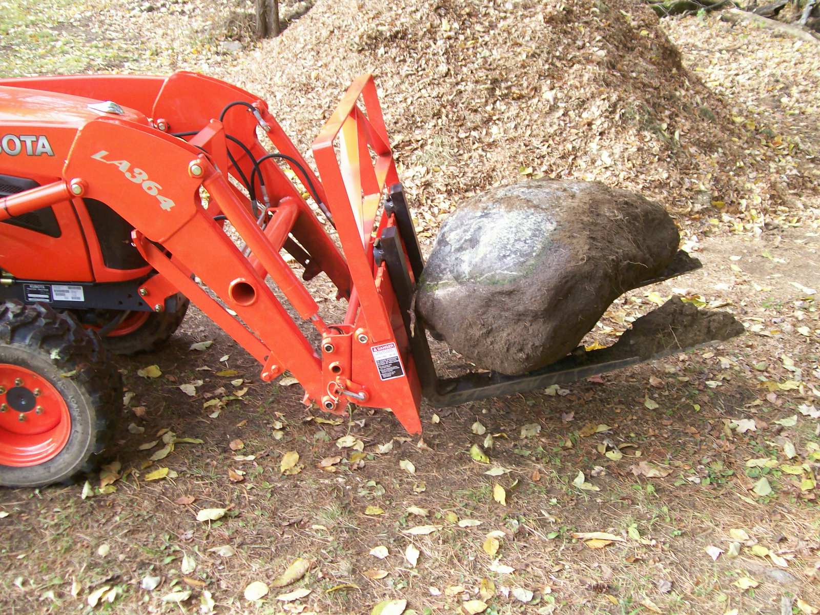

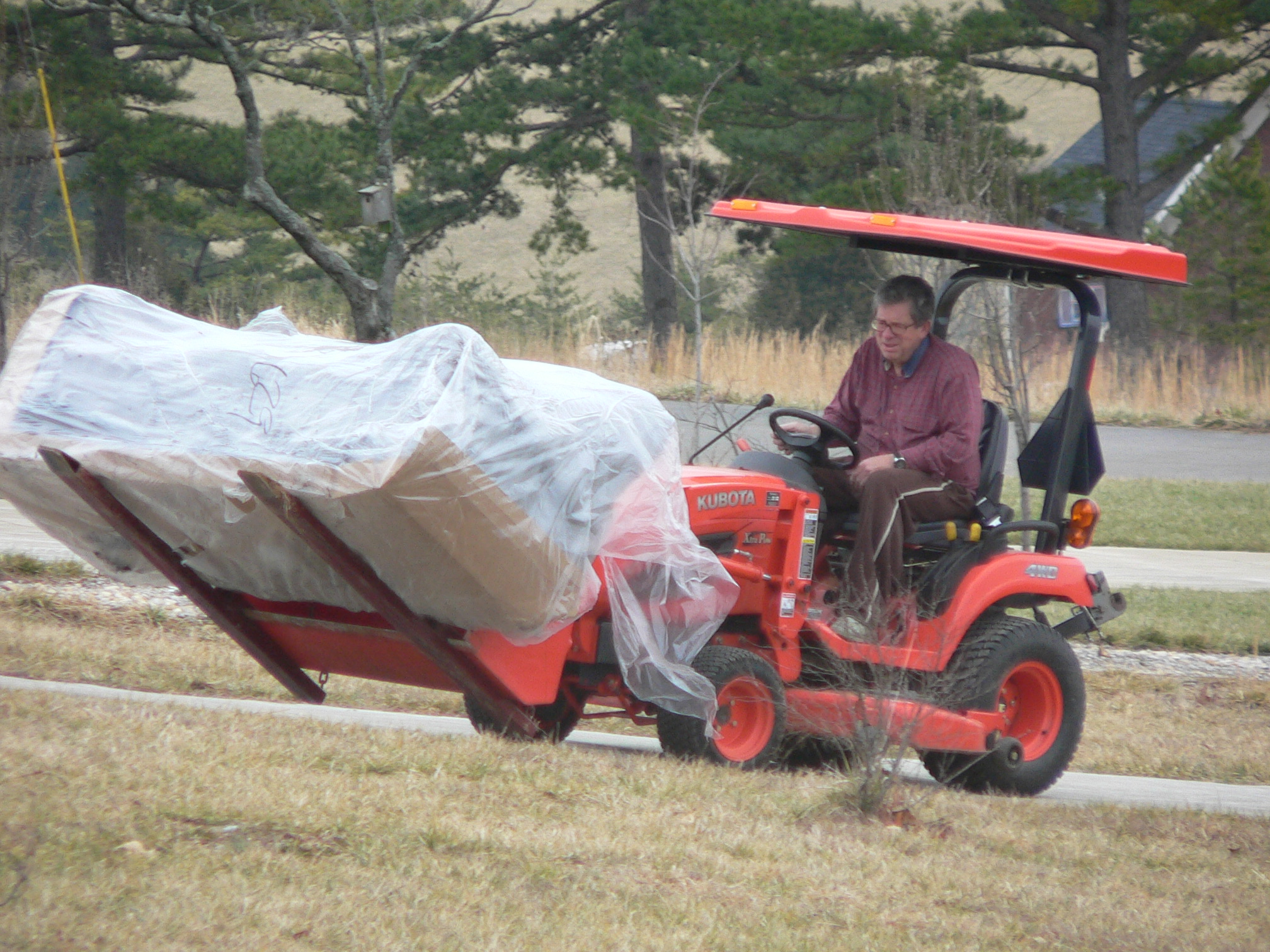

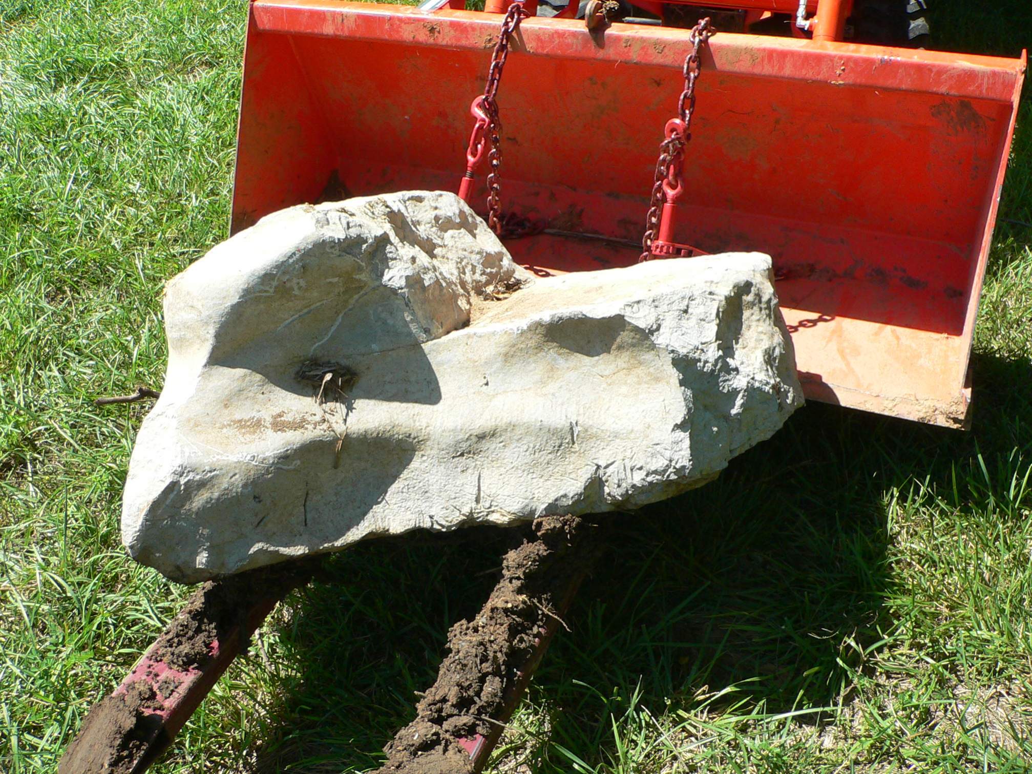

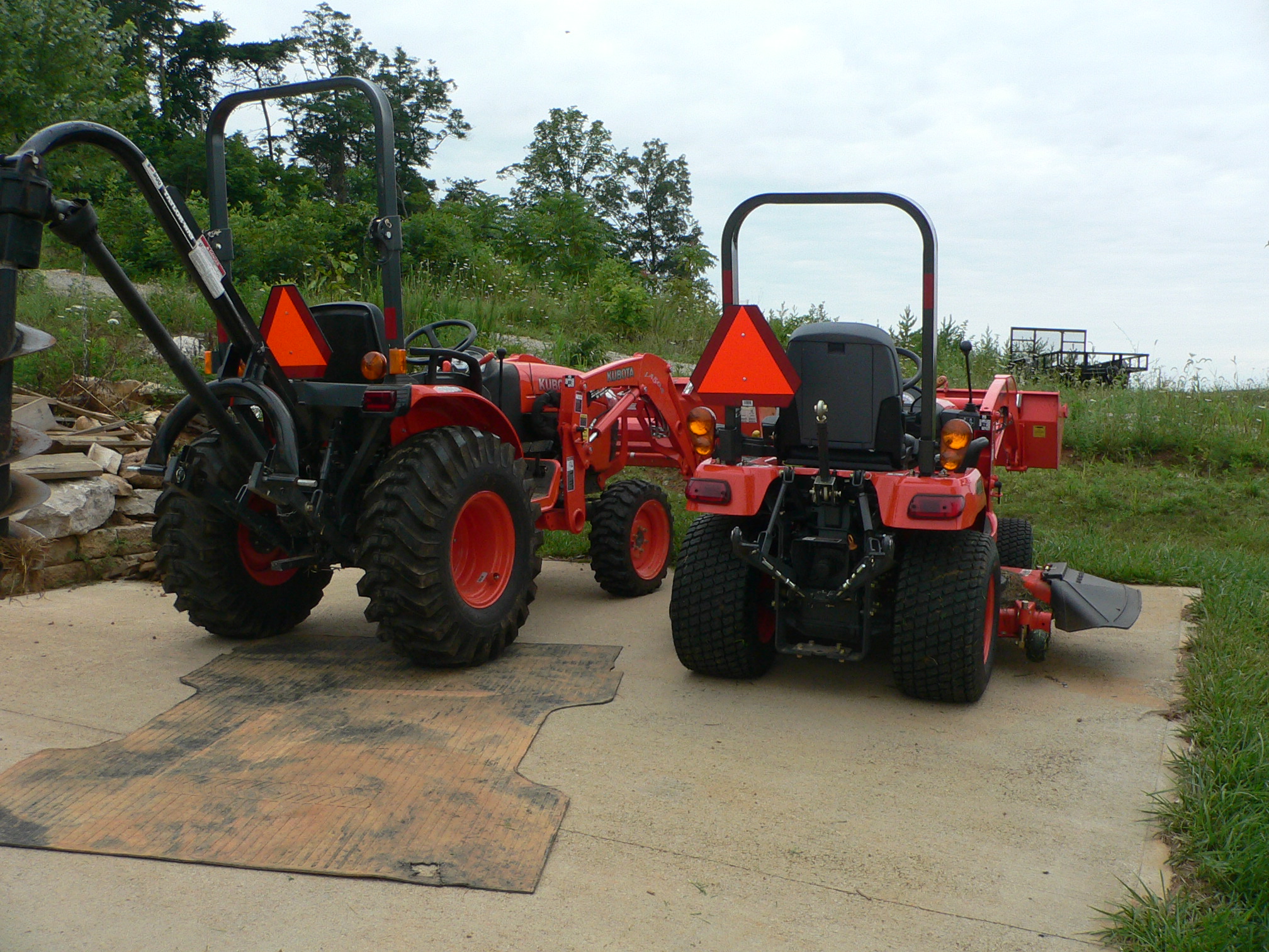

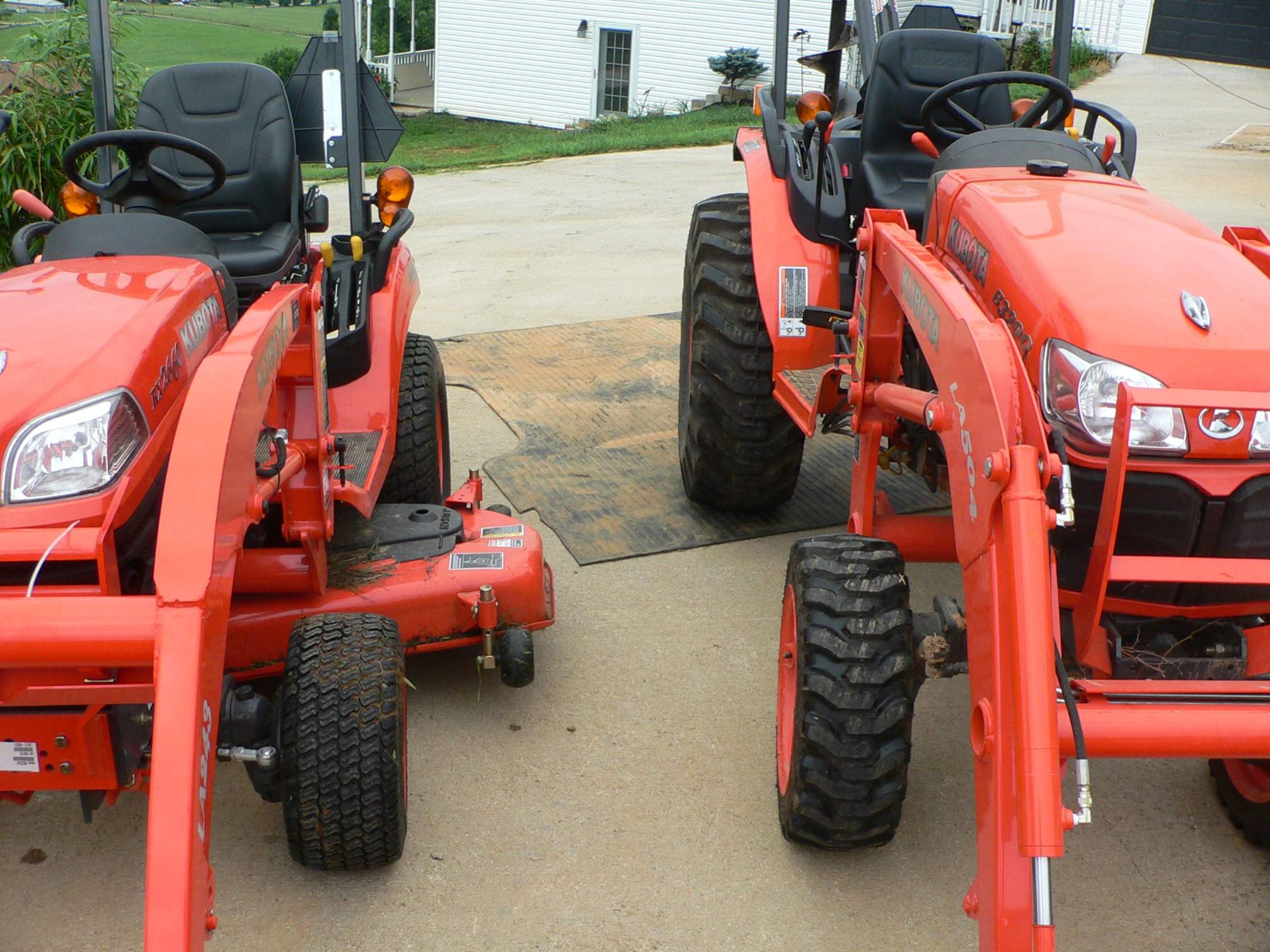

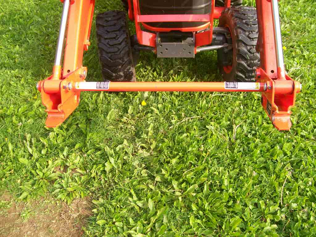

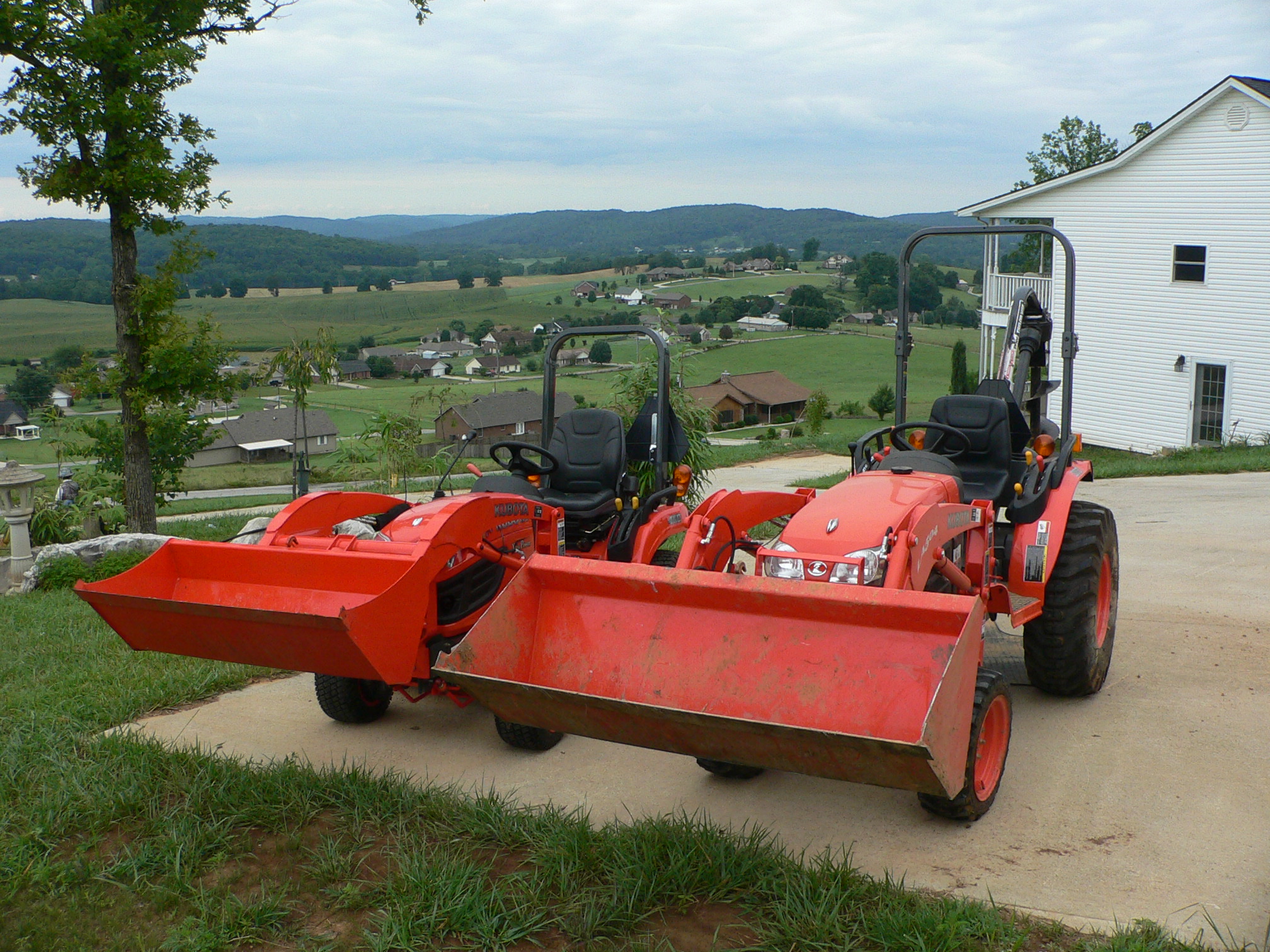

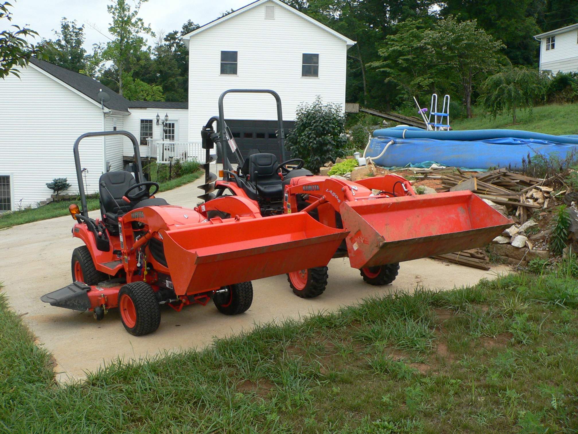

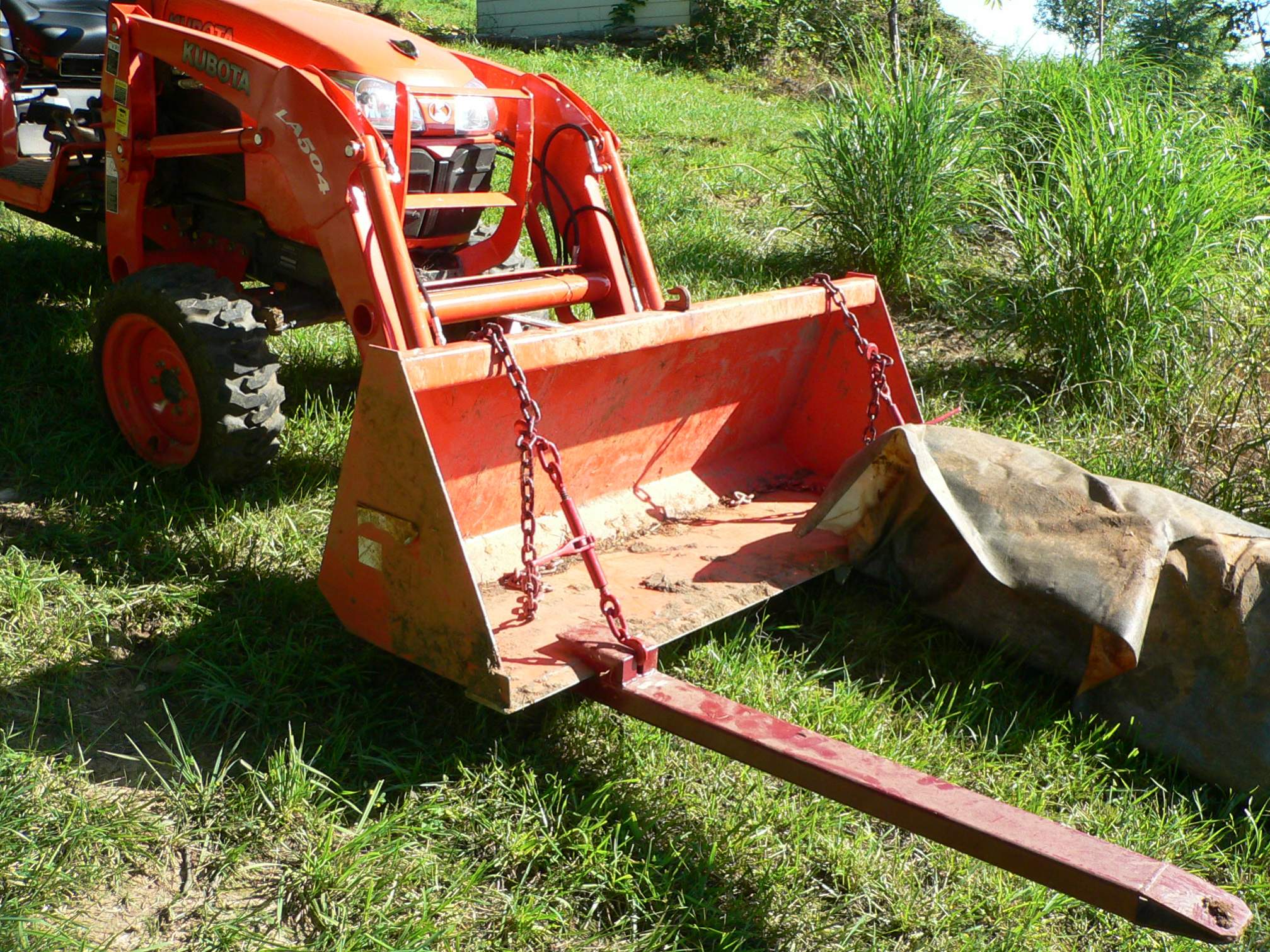

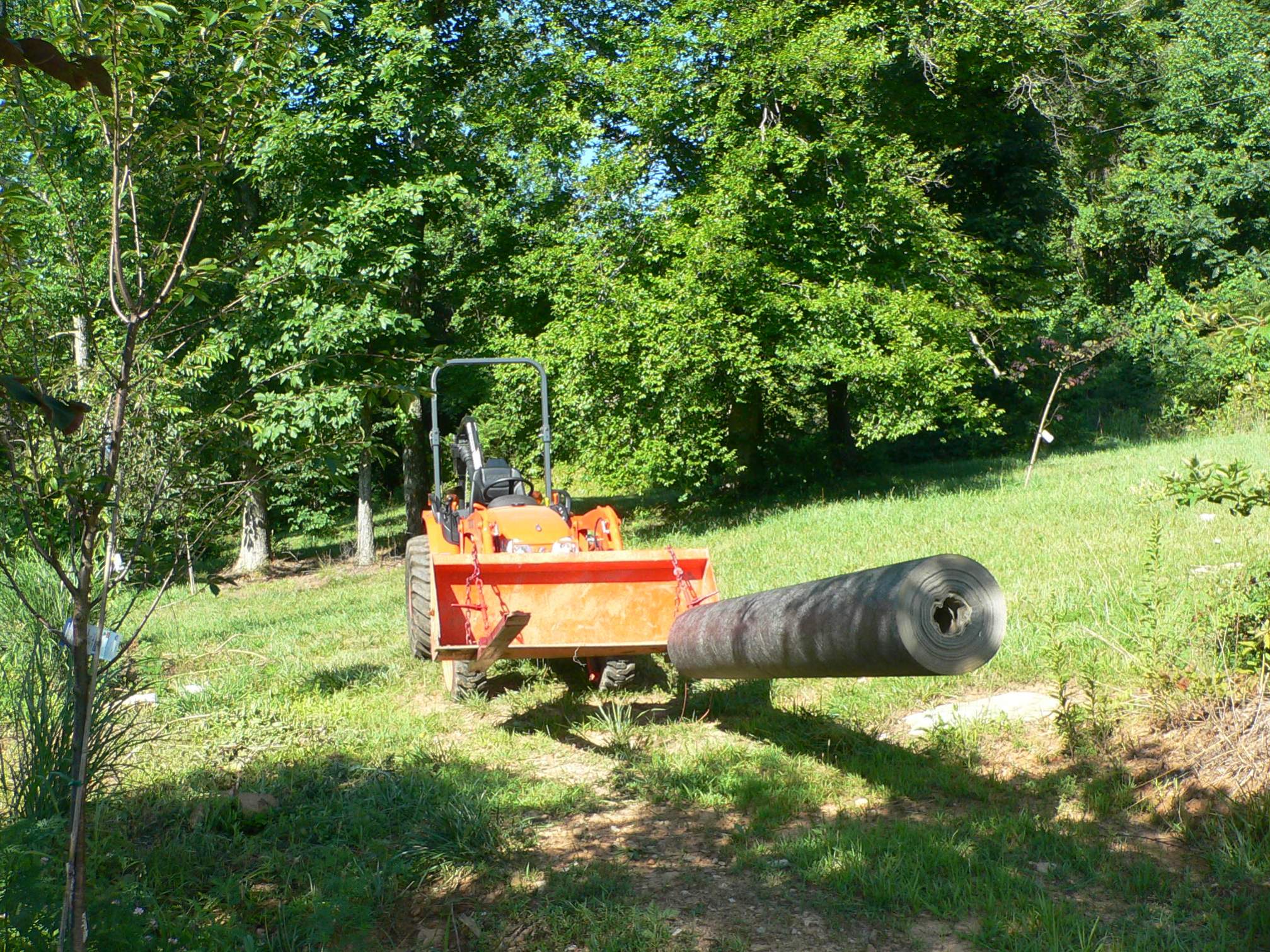

Here are my forks that I have used on BX's and B's. They slide over the top of the bucket with a long arm under the bucket and a chain wraps around and ratchet them tight. Easy and quick to install and remove. Biggest problem is they will spread out or in at the tips if you hit the tips on the side edge.
Also sending pictures of a BX2660 side by side with a B3200 for comparison. The weight between some B's and BX's will not be great. Biggest difference is ground clearance and BX's have the plastic fan that has to be protected. This BX has the mid mount mower but with it removed there isn't a hugh difference but a small difference can make the difference on some jobs.

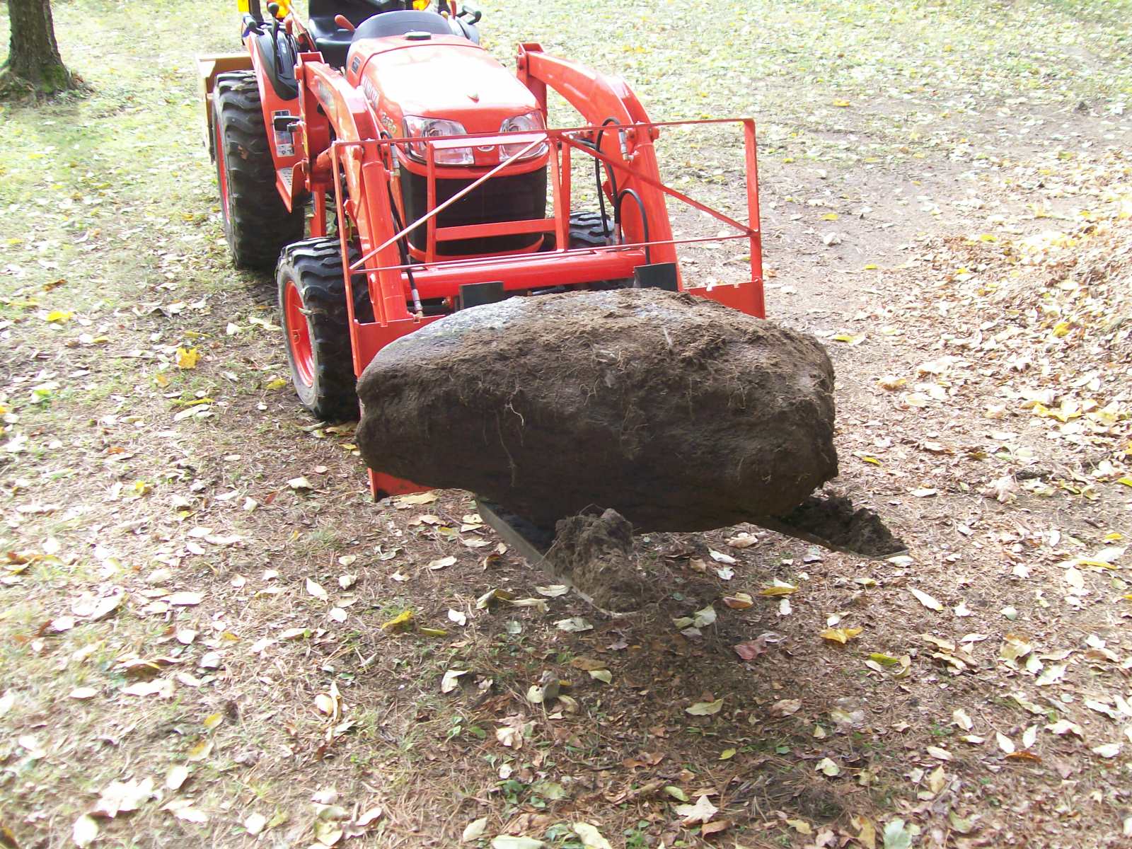

This is what I use on my B2620, and find them very well matched, and useful for a number of different jobs.
