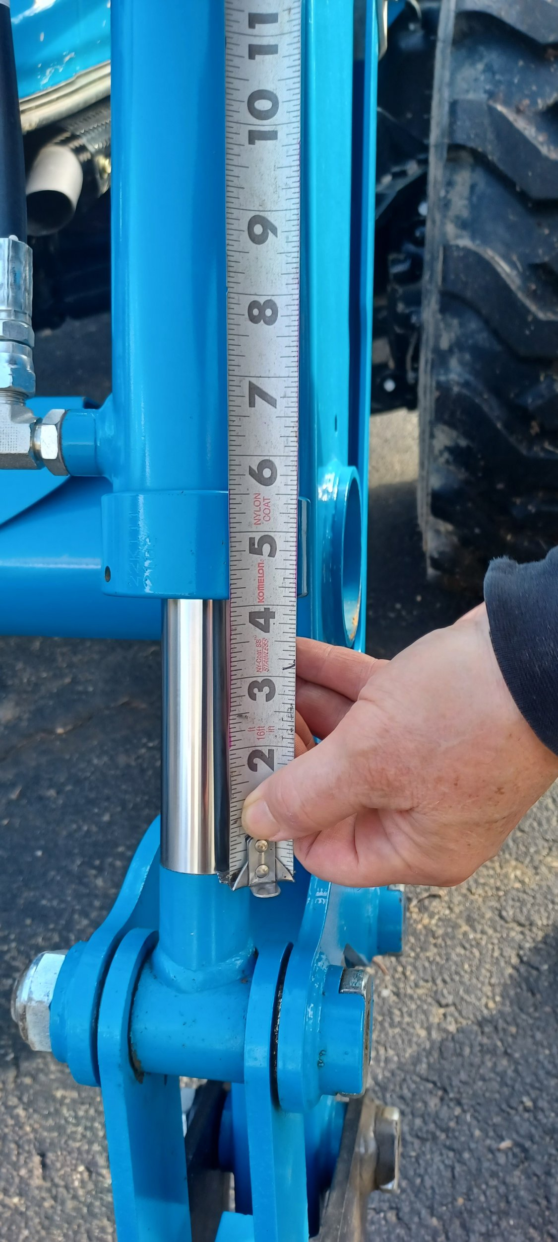

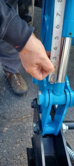

Was this ever resolved?? I have the same issue with a very similar tractor MT352.

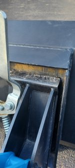

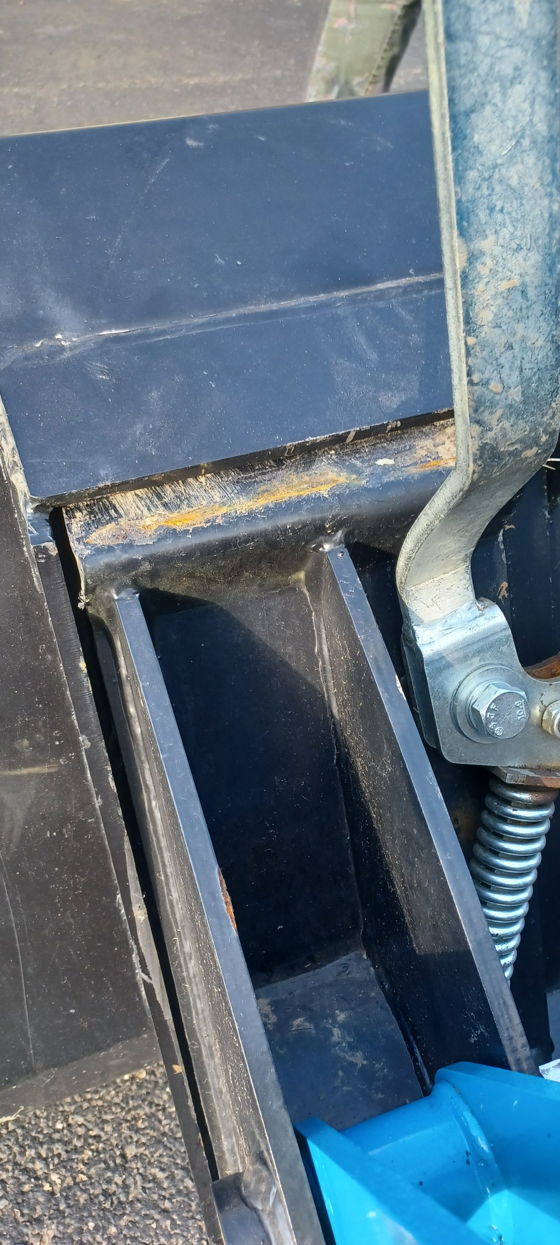

Curl cyliders
Trying to line up the QA
Close up of the QA points each side this is a PITA trying to attach an implement specially a heavy one like a snow pusher. I dont store the implements on flat ground either so getting the QA attach points level is gonna make my work a little more fun.

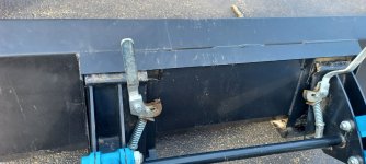

This is what it looks like on a flat surface
Across the lift arms, and the garage floor is level as checked prior with this same level and direction.

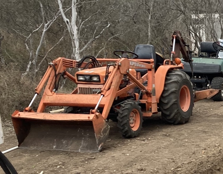

Dealer changed the saddles (rear mounts for loader) on my Kioti to address unlevelness. I cannot recall whether that actually did resolve the issue; I just know that it's out of whack now/still- I just live with it (nothing is level around me anyway; only when doing fork work does it tend to be an issue. I'll note that I did discover that my front brush "guard" isn't level (looking out over the hood and seeing the top of it and the front loader cross bar) and that tends to overstate the unlevelness of the loader itself.
I've pushed my B7800 to insane levels (some would say I was purposely trying to break it- think of EA Ted) and everything on it is still level as can be. If only everything was built like the B7800!
