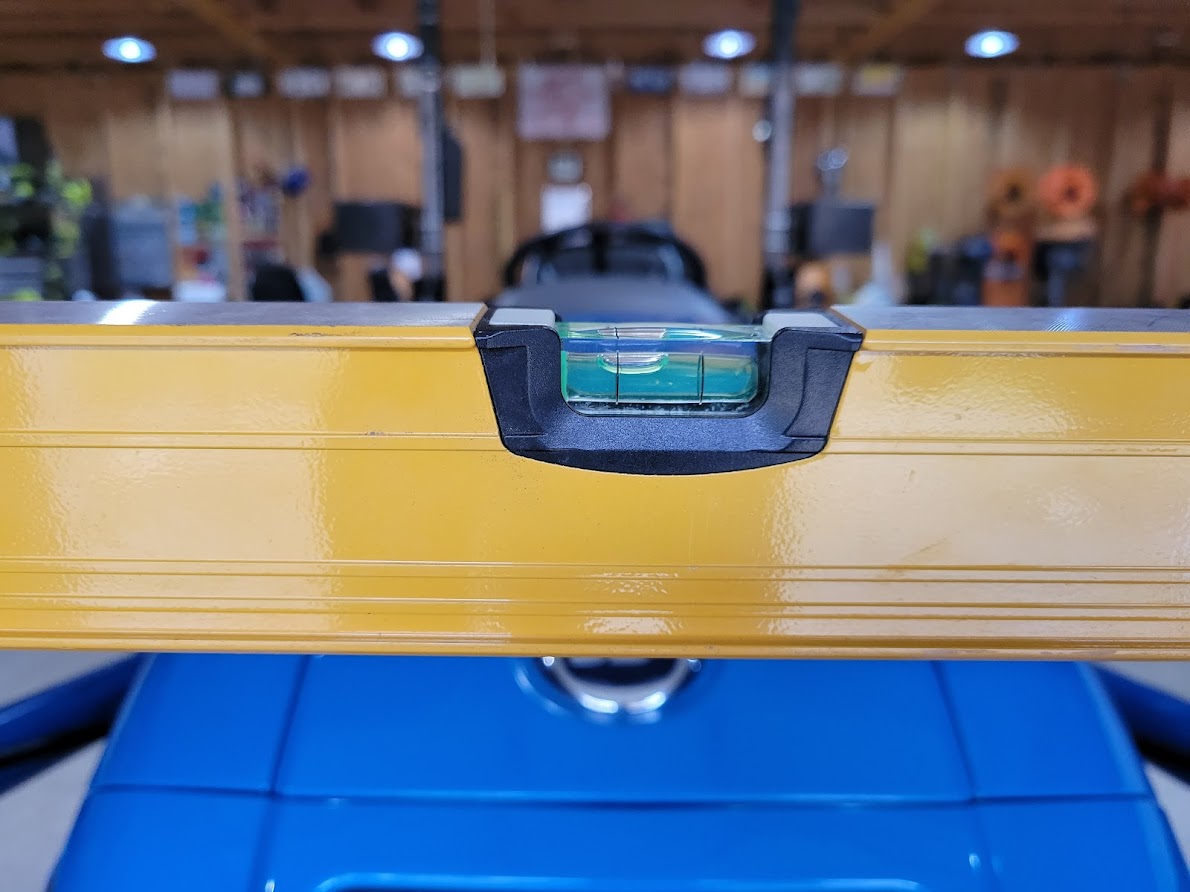

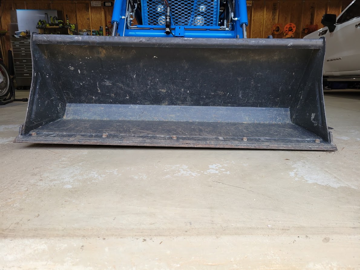

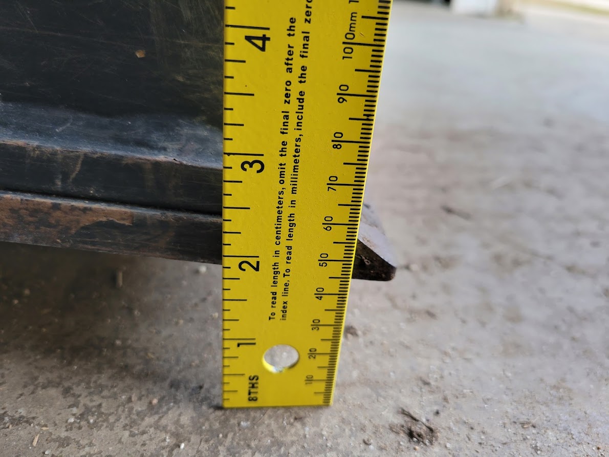

   / Did I bust something on the loader hydraulics?
#58
This is what it looks like on a flat surface
Across the lift arms, and the garage floor is level as checked prior with this same level and direction.

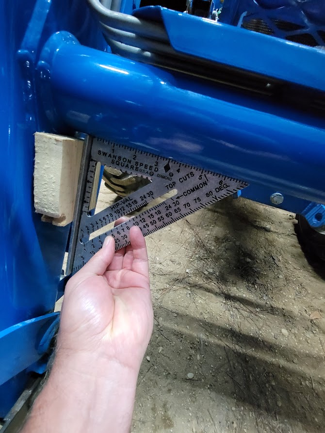

#60
Maybe carpenter's square on the boom arm to torque tube will show if you bent the loader?
had to use a block as a spacer due to the welds and braces, but it is square on both sides, and there is no visual sign of stress on the torque tube, not on the paint, tube or welds, not on any welds, paint or metal on the FEL for that matter.
