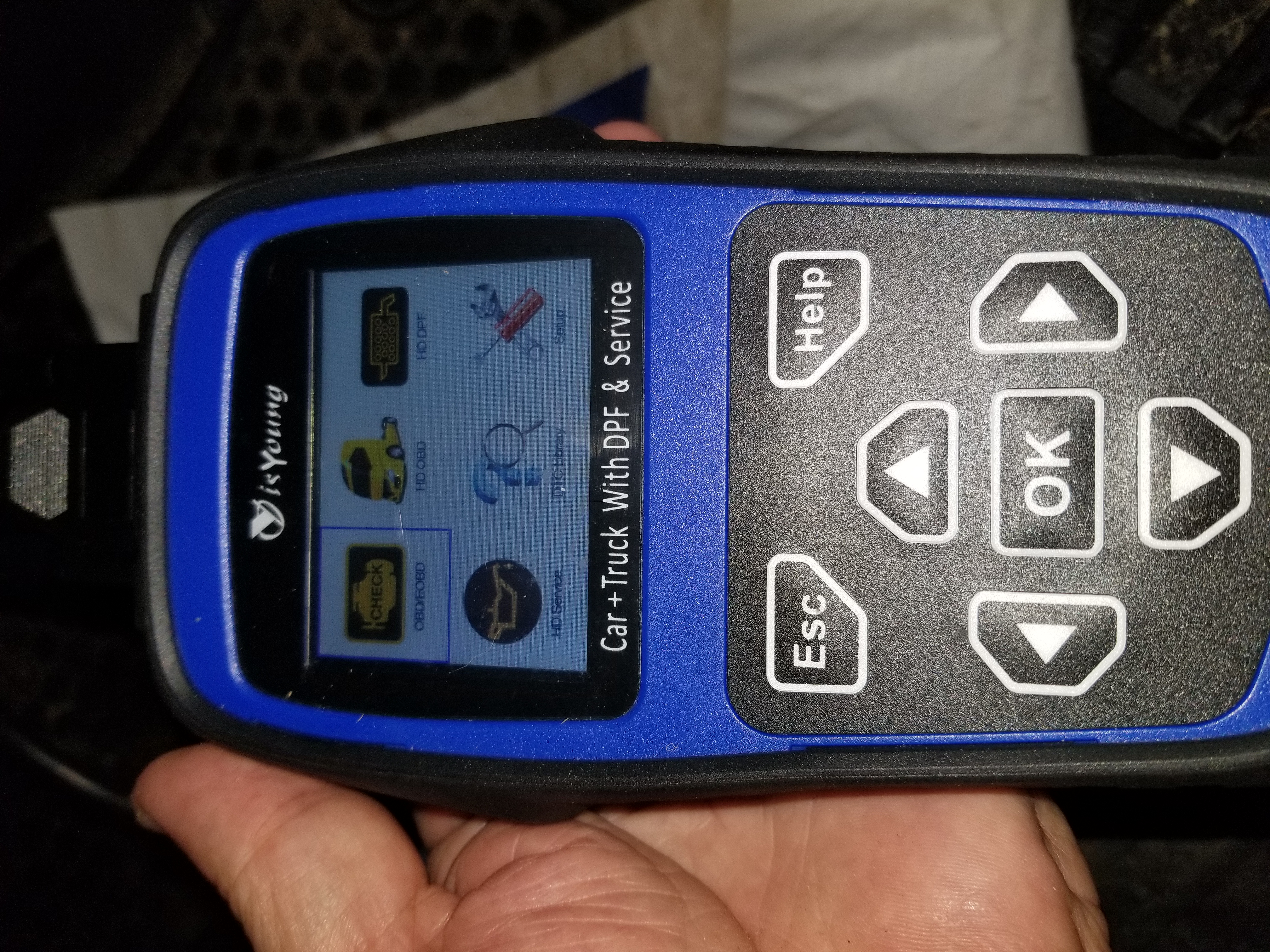

Another fine day at work , same diagnostic plug as LS tractor
/ Diagnostic code reader
#70
Unkeyed 9 pin same as LS Tractor J1939
#71
20180226_165057.jpge
Checked adapter on some CAT engines with the NL102 scanner ...worked well could reset/read as well as view live data ...
/ Diagnostic code reader #72
Now if the NL102 will do the same on your LS we'll have something.
If it works I see the NL102 isn't too expensive and would buy one.

I did not need to do any work with pin out's or anything of such sort. I just plugged in the reader with the OEM OBDII cord and it worked fine. I'm out of town until Sunday but when I get home I can take a picture of the reader I have and post it so you can see which one it is. it was really incredibly simple to use.
/ Diagnostic code reader #78
thanks mines the nexlink nl 102 it should work
