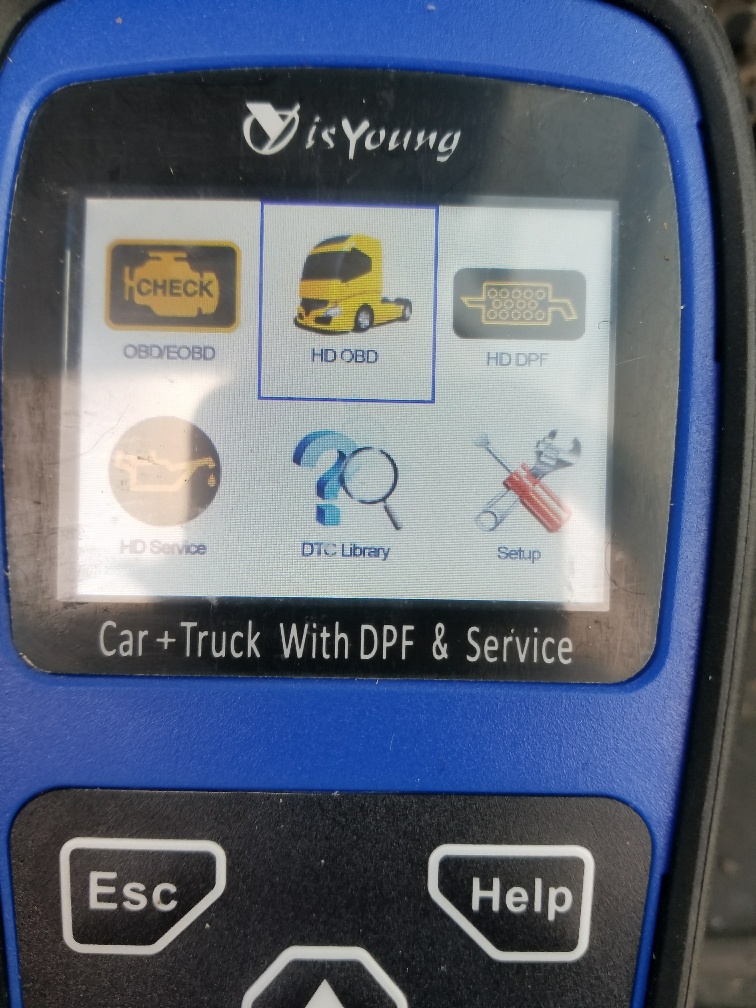

Replaced phone , haven't recovered data yet ( if I even Can )no big deal just six or so picture of ha truck scanner didn't even have it set up for sae..it's was getting cold and really check a lot of the scanner functions ...know it will read live data ,coolant temp , rpm , and such. ...

20180212_170721_resized.jpg20180212_170721_resized.jpg20180212_171249_resized.jpg20180212_170055_resized.jpg20180212_170055_resized.jpg20180212_170055_resized.jpg
just a snapshot of my hd truck scanner

ELM324 scanner wouldn't read live data on my tractor , May be able to reset trouble code but that seems to be about all , recommend an HD truck scanner that can read J1939 protocol
Use the HD OBD for the XR4000 Models LS Tractor
