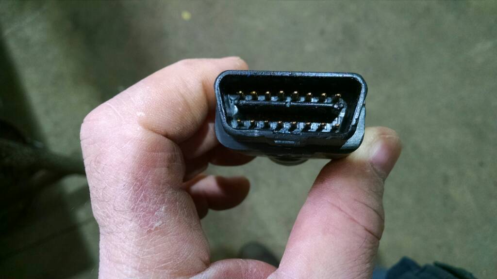

Anybody happen to know what diagnostic adaptor Kioti uses on their NXs? I have a bad injector and want to see if the computer happens to know which one using a Launch Pro Touch.
FWIW, the connector on the tractor looks like a Molex 33472-1201 MX150 12-Pin, female, without the two notch tabs on the outer connector.

Yes it's a standard obd2 connector for the ECM on top of the radiator, the dealer uses the FT4 program on the laptop to read the codes.
Been there , done that with the injectors just a few months ago had to have them replace, also each injector has a unique code on them and the ecm must be programmed with that code for the injector to each cylinder location.

Hillwood and Country, Thank you. In the shop manual they show a weird connecter that supports OBD in the fuse box, but I had forgotten that there is an OBD connecter under the hood. Thank you. Disappointingly, my brand new Launch Touch Pro can talk to just about anything but Kioti or Daedong and worse, Kioti wants $817.00 for one diesel injector. Hopefully I can cross-reference it with something from my NAPA.

Cross referencing should work as the injector is a Delphi injector (p/n 28320793, 28387256) with a Delphi engine management system. In fact, looking at the application chart, it looks like the engine management system is shared across Kioti's entire tractor line. Injector coding is covered in sections 3.5.7-8, pages 3-166-7 in the service manual and requires a scanner that can talk to the ECU.
Daedong CD21 2.4 TD 12/212-6/214 New Delphi Diesel Injector 2832793
It also looks like there is a rebuild kit available (which will still need to calibrated)
Delphi New Injector Repair Parts Nozzle Valve Kit 7135-612
A cross reference chart I found online. DELPHI 28387256 Injector regardless, I need to confirm my engine code (located on top of the valve cover).
Anyway, I do need to find a scanner that can talk to the ECU. I tried looking for FT4 and found nothing on the web.
