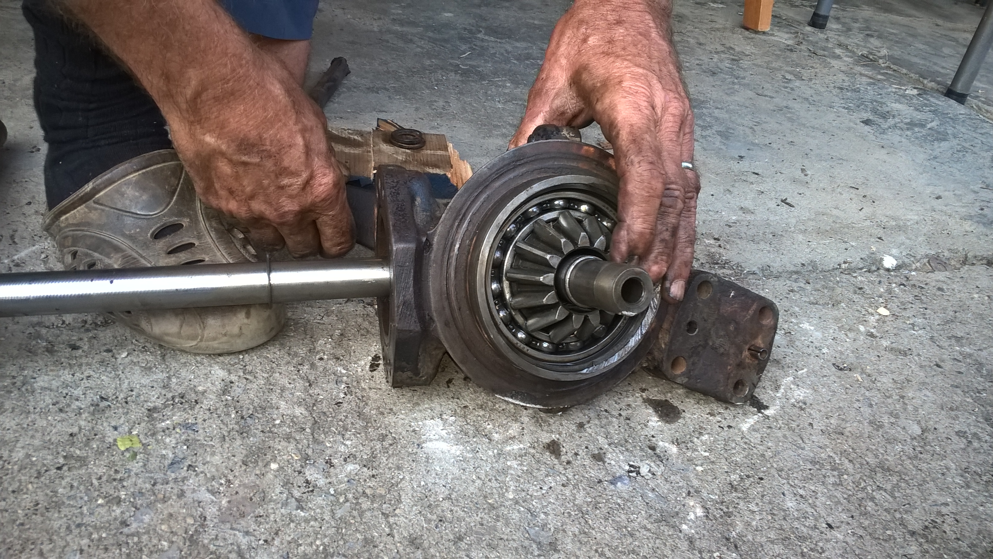

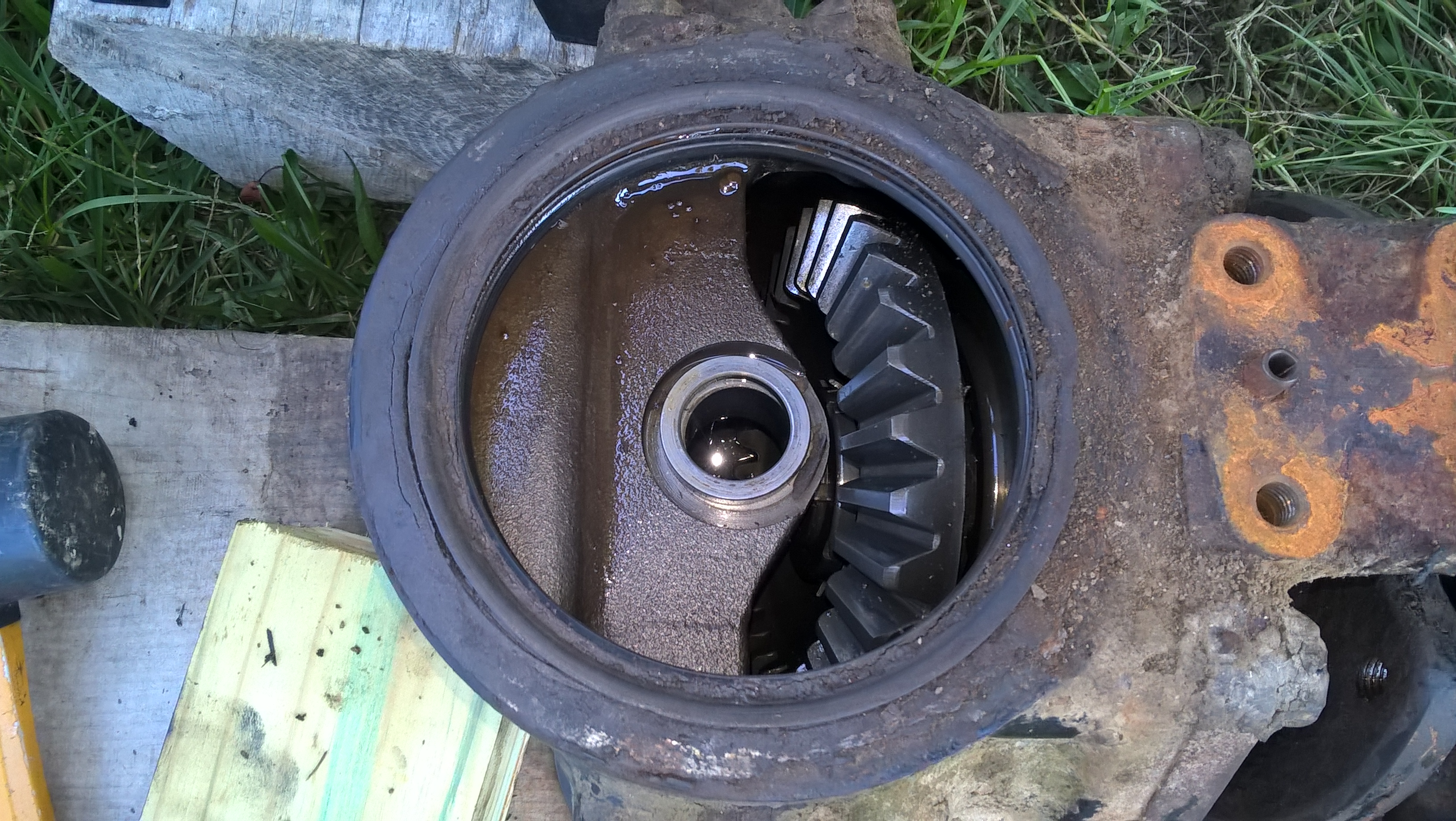

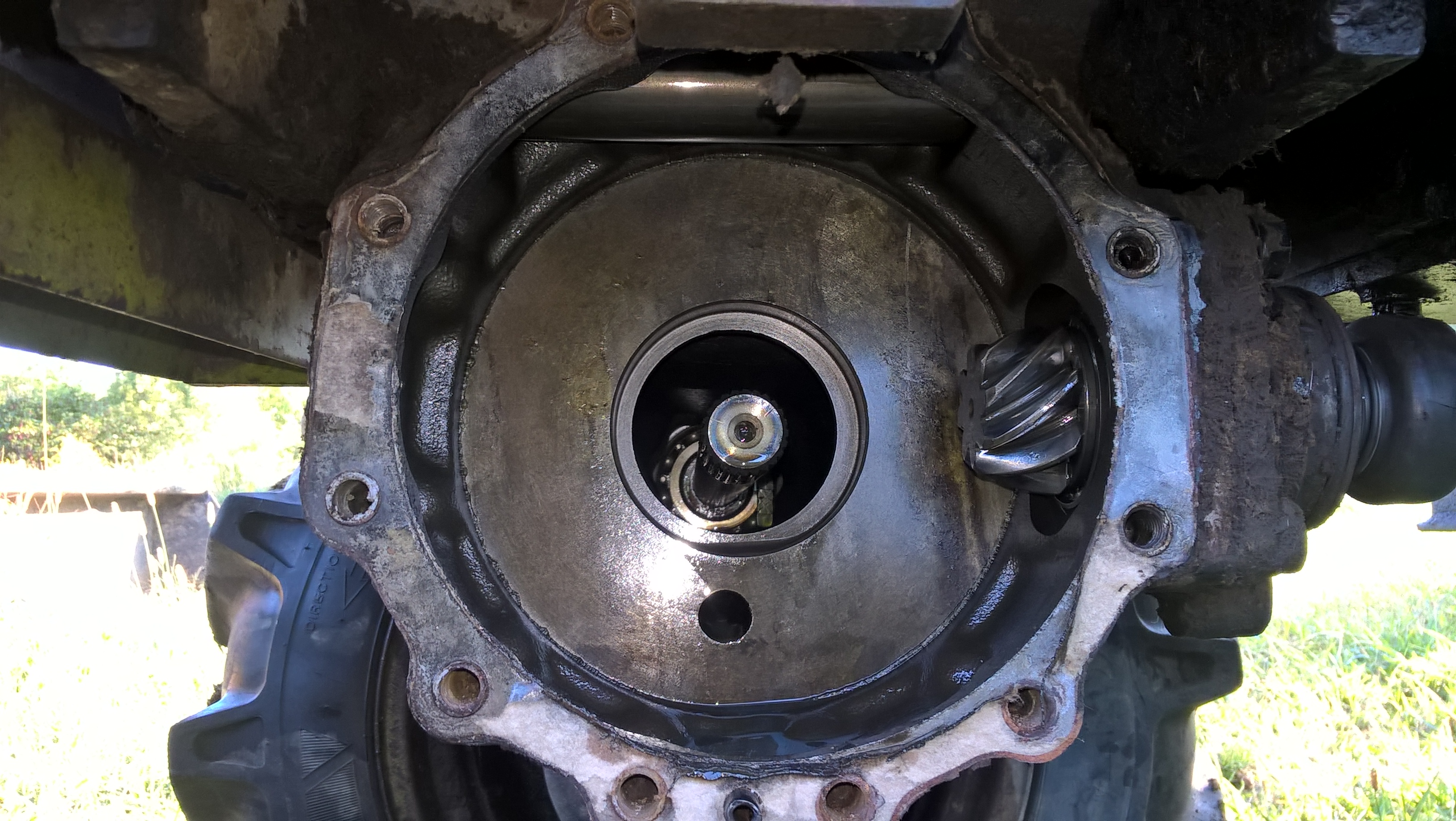

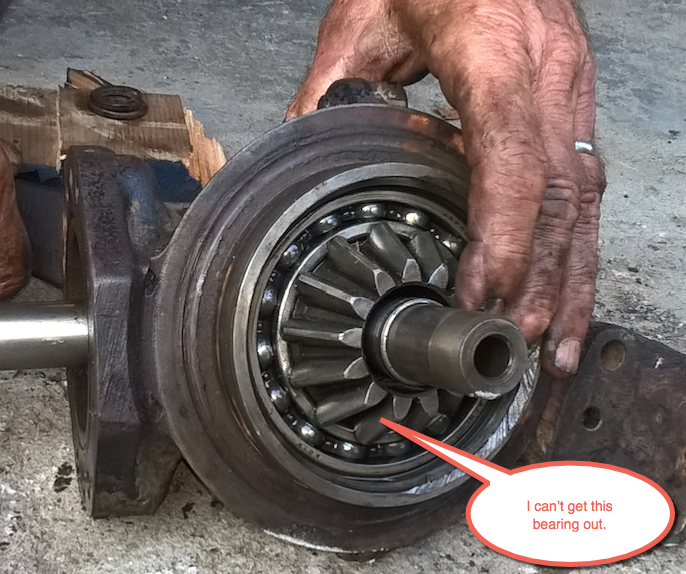

I've pulled everything to the driver's side of the front differential off (in pieces). I think I know that the problem is but still don't have a solution for it. Here are some photos of the progress. Referring to Hoye's parts page..
I managed to get to get the 4WD spindle (#44) but I cannot get the bottom spindle gear (#53), the Bearing (#58) or the top spindle gear (52) to come down out of there.
Now that the spindle is out of there, I can reach in from 'above' and tap it downward, which is what I started doing but it really seems stiff and I'm afraid of what I might damage trying to drive that spindle-bearing-spindle assembly downward. The snap ring (#28) is out, as are parts 47, 48, 49, 50, 51. The spindle (44) and associated parts came out the top.
At this point I know I need to replace the top seal and bearing (59 and 28). They got damaged on removal. I'm hoping the bottom and top spindle gears are okay, but they are absolutely frozen. I can not rotate the bottom spindle. No way, no how. Which is why I'm trying to get those out.
Any ideas on getting those down out of the housing?

The first photo (the one of the spindle bearing and greasy fingers) was taken before I got the spindle etc removed.
/ Diagnosing 4WD problems YM240D #11
The bottom gear #53 has outer splines that go through top gear #52. There is a snap ring #54 that holds the two gears sandwitched on the bearing #58. Can you remove the snap ring #54 and allow the two gears to come out? This will allow you to tap better on the bearings.

Hi Winston-
Thanks for your response. I wish I had a photo but I don't at the moment. I don't think I can get to the snap ring (54). The whole assembly is still stuck inside the housing and I don't think I can reach through the top (where the spindle (44) has been removed). But I will have a look. I'll try to get a photo to explain this.
It seems to me the whole assembly (52; 58; and 53) should all slide out the bottom of the "housing". Based on the diagram, that's all that's left in there.

Alright. Here are some photos to show where things stand. The only path forward that I can see is to continue tapping the top gear-spindle-bottom gear assembly downward. I can fit a large socket into the top opening and hold the whole thing in a vice, but movement this way is very slow and I fear I'm bumping up against something and might break something. But I do believe this whole thing should 'slide' out (with some convincing). Is that correct?
Thanks,
/ Diagnosing 4WD problems YM240D #14
I do not know, is the top gear diameter smaller or larger than the bottom bearing? If diameter is smaller it should go down through the bearing opening. If not, that snap ring that holds the two gears together will have to come off. I really don't understand why I can't see that snap ring in your second picture. Seems to me it should be visible. You can see the groove here that it should be in. SPINDLE GEAR (BOTTOM) _: Yanmar Tractor Parts

Both the top and bottom gears are smaller than the bearing. Unfortunately the photo doesn't show it but the snap-ring on the top gear is there, but I don't think I can remove it. The only access is through the top (where the spindle exited this assembly) and it's probably 4" down in there which is beyond my reach. It sure seems like the two gears are the bread and the bearing is the meat in this sandwich. I should point out that this whole thing is frozen. The gears won't turn and the bearing appears to be seized. This was the case before I started tapping on it and I believe this has been my problem from the beginning. The picture of the top gear does show the general condition- not great in there. I don't know if the top seal was leaking, or the fluid level was low somewhere in the past, but none of this will turn.

If the bearing is locked up it is possible the outer race has turned in the housing causing it to be much more difficult to remove. Just from where I am sitting I would consider a large piece of hardwood that would barely fit through that top opening and a large hammer.
Ideally would be to separate the two gears but if the snap ring cannot be removed then I don't see any other choices.

@winston1- that's the situation I think I'm in. A bit of elbow grease is really the only practical way forward. I'll be as gentle as I can because those two gears are pretty expensive, but I can't put it back together the way it is....
