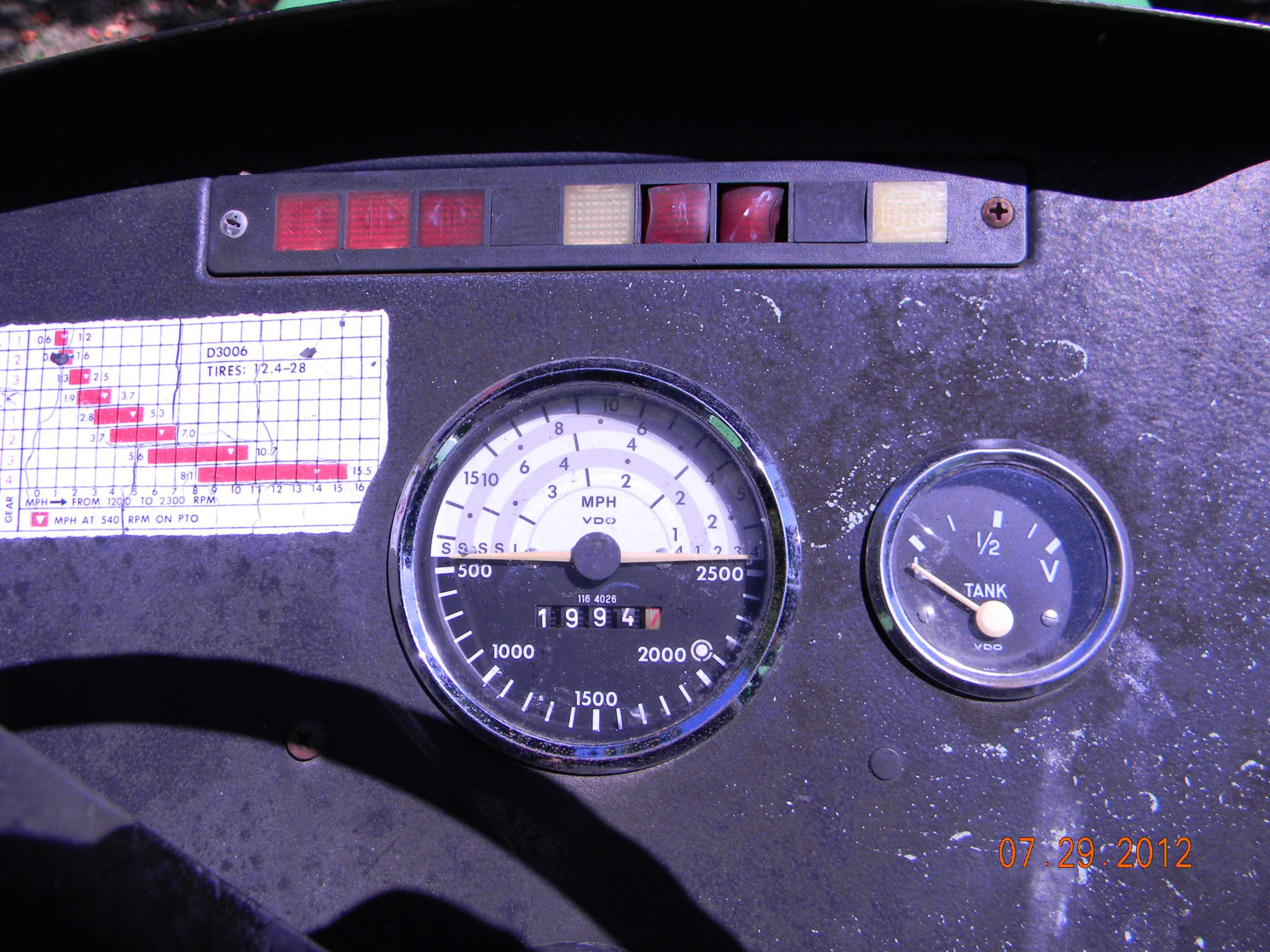

/ Deutz 3006 #4
Dave, Rick
Just got a very good condition D3006 with 1994 hours. Has bad starter
solnoid so am jumpering battery to stater lug. Hope to be able to repair
or replace the solnoid. Would like to keep this thread going with D3006
pictures and 'good to know info'.
Jim

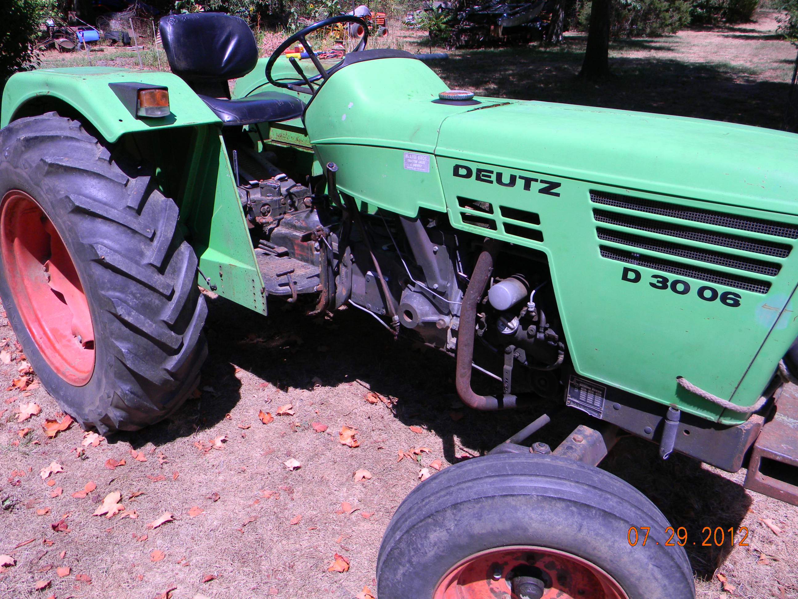

/ Deutz 3006 #5
Update--was able to get starter rebuilt and now starts via just jumpering 12v into solinoid. Have to find where circuit is open from key, starter switch and all interlocking switches. Have to find wiring diagram and get into dash for verification of all wiring.
Jim

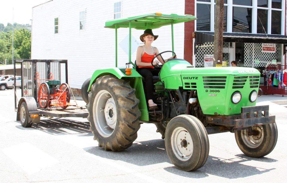

/ Deutz 3006 #11
This is my 30-06. My daughter is driving it in a parade pulling the Bachtold mower that I ran when I was a kid in the 70's I just found another that has a loader and has been abandoned in western Oklahoma. I tracked down the owner and have made a deal to purchase it for $1000. It is rough but I believe I can make it as nice as my other one.
