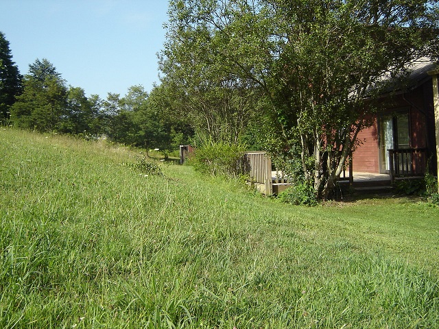

Pardon the length. Thanks to all your feedback, you guys are amazing. I postponed the French drain I was going to dig on Monday. Seems I should get a better feel for what痴 going on. Here痴 some pictures and a description that might help you guys.
The deck photo shows the grade leading down to the deck. On the far right edge of the photo is a GUTTER going into the ground at that corner of the house, you can't really see it in the photo but it's there. That closest corner of the house is the corner that leaks in the basement.
I checked that gutter out today the gutter does not appear tied into the foundation drains. It turns away from the house within about a foot of the surface using black corrugated pipe 3 in diameter is my guess from memory.
** This is the same corner that is leaking in the basement. Although the gutter is on the side and the leaking tends to be along the back wall, not the side wall where the gutter is but same corner, clear as mud?

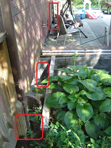

This close up picture has 3 red boxes in it is the side of the house. This is the side adjacent to the deck, that youæ±*e facing in the é›»eck photo. This first, closest GUTTER is the same one in caps referred to in the last post/photo.
The lower red box shows the GUTTER going into the ground it turns 途ight as seen in that picture about 1 foot under the surface.
The middle box is the concrete stairs going down to the basement. Thereç—´ a drain cover going into plastic PVC piping at the bottom of the stairs just before you enter the basement.
The top box is the front gutter which goes right into the concrete. The concrete is actually holding it in place so I couldn稚 remove it, but I would assume it痴 going away from the house like the other one, but who knows. I only know of one drainage into the creek so I知 not sure where those gutters drain too finally. Maybe they have drains in the creek I値l try and check, I致e never looked closely before.
