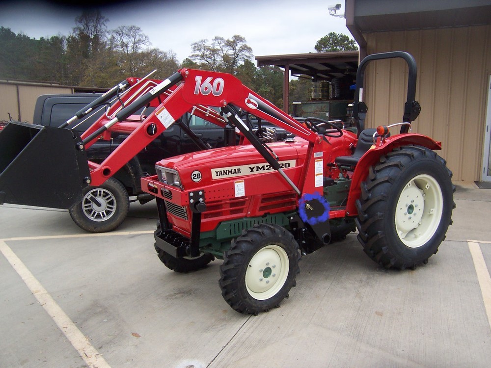

I have a Yanmar 3810D with a Koyker 160 loader without quick attach. I would like to be able to detach the bucket only when I am doing work that doesn't require the loader such as bush hogging or scrape blade work to relieve some of the weight on the front end. It looks like I should be able to remove the 2 thru pins on each side and remove the bucket. Has anyone ever done this and any other advice will be appreciated.

that is interesting, must be more than one option on the 160 loader. The one shown here is quick attach. You can click on the picture to make it larger. YM282� [RARE] Fredricks Outdoor

I understand both of your statements. Does your loader have the quick remove pin that I have circled here?

Yes , Winston, my loader has the pins that are circled in your post. However, my obstacle to "Quick Attach" is not the loader itself but the hydraulic fluid line. My hydraulic fluid line from pump to rear end has been interrupted by a loop in the line going to the joystick box. One end of loop goes to top of joystick box and other end of loop goes to bottom of joystick box. I do not see a valve or anything of that nature that would allow me to detour by the loop and direct fluid straight to rear end as it was before loader was added. If you have a pic of what that valve should look like , please post. To sum it all up, it appears to me that the loader with bucket still attached is indeed the quick attach type, but the hydraulic fluid line is not equipped with the quick attach couplers for attaching and unattaching. The hydraulic line seems to be hardwired. Does that make sense to you?

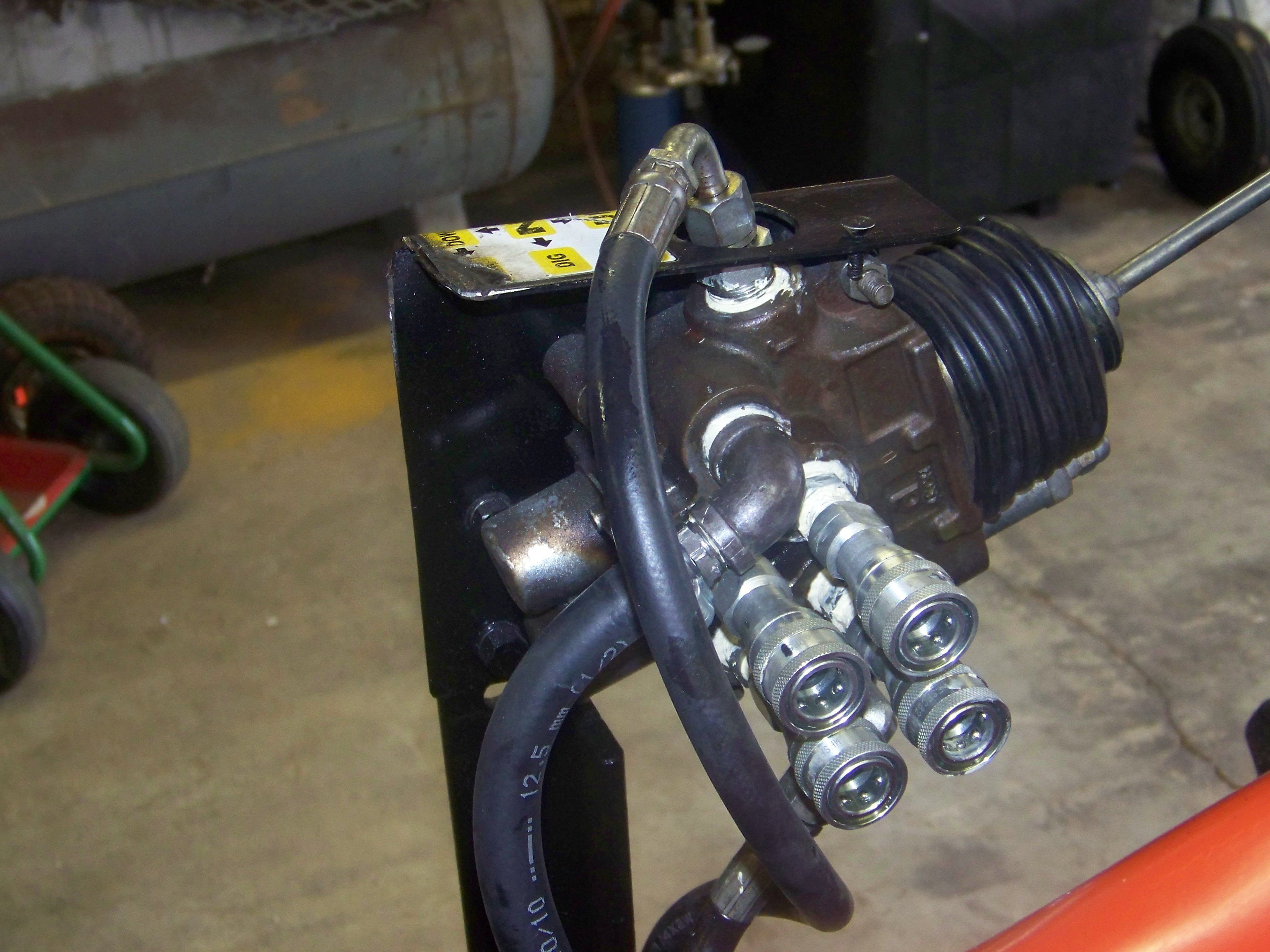

Yes, sure makes sense. The line from your pump goes through the loader valve in route to your 3 point. If done correctly the loader valve will be mounted on the tractor. That way the loader valve stays on the tractor when the loader is removed. Also correct way is to have quick couplings on the 4 loader lines right at the loader valve. They are then disconnected when the loader is removed but your hydraulic flow continues to go to your 3 point. Hope I am making sense. Couple of pictures showing how my old 2002D was plumbed. You will see 3 lines + the 4 loader cylinder lines with quick couplings. Your valve probably has only 2 lines + the 4 loader cylinder lines. My 3rd line is power beyond but if your loader is working fine just ignore that 3rd line.

if he has the koyker loader valve. It will be mounted to the loader arm, not to the tractor.

... If done correctly the loader valve will be mounted on the tractor. That way the loader valve stays on the tractor when the loader is removed. Also correct way is to have quick couplings on the 4 loader lines right at the loader valve. They are then disconnected when the loader is removed but your hydraulic flow continues to go to your 3 point. Couple of pictures showing how my old 2002D was plumbed.
My YM186 has the original Yanmar loader and it is plumbed as you described, the control stays with the tractor if the loader is removed. (Photo). And the loader is set up to be removed easily, including a 'foot' to hold it up ready for re-use.

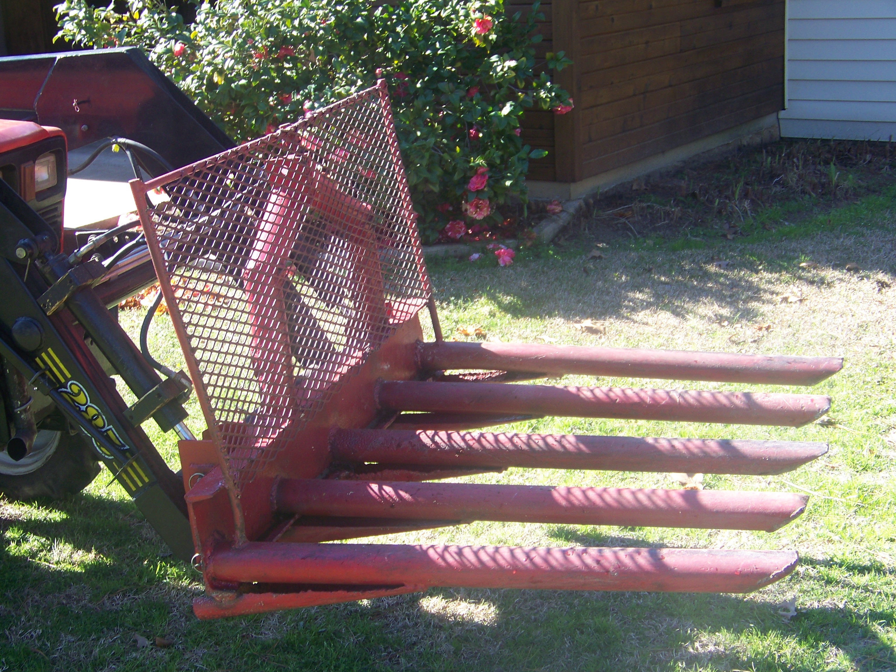

I could take my old bulldog loader off or on in 10 minutes or less. Same with my current Bobcat. I remove and install mine several times a year. It gets in my way when mowing in tight quarters. I have an old home made brush stacker that I occasionally do put in place of my bucket. Doesn't take that long to do it but not as fast as taking the loader off.
