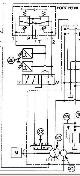

Dwolf: What are your symptoms ? What happens when you push the hydro pedal forward or backwards ? Does the engine bog down, or does it appear that nothing is happening at all ? In the attached picture if you follow the pilot signals from the foot pedal downwards you will see that it stops at a 2 position solenoid valve. This valve in its "inactive" position simply blocks the pilot signals from getting to the servo cylinder that moves the pump swash plate from its neutral position. When the safety circuit is working properly, when you push the green button on the dash, power is applied to the 2 way valve, which puts the pilot signals in communication with the pump swash plate.
I'm not certain if your larger machine works the same way (I heard you might have an electronic instead of a hydraulic pedal assembly), but I'm pretty sure that you will also have a safety circuit that needs to be worked through carefully. If you too have a solenoid valve to isolate the pump, try temporarily disconnecting the solenoid from the wiring harness and applying 12V directly to the solenoid coil. If you hydro system then works, the problem is isolated to the safety circuit.

EF 2
