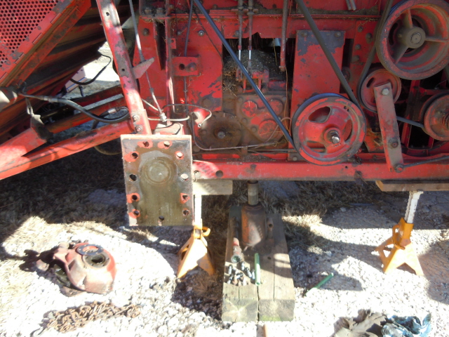

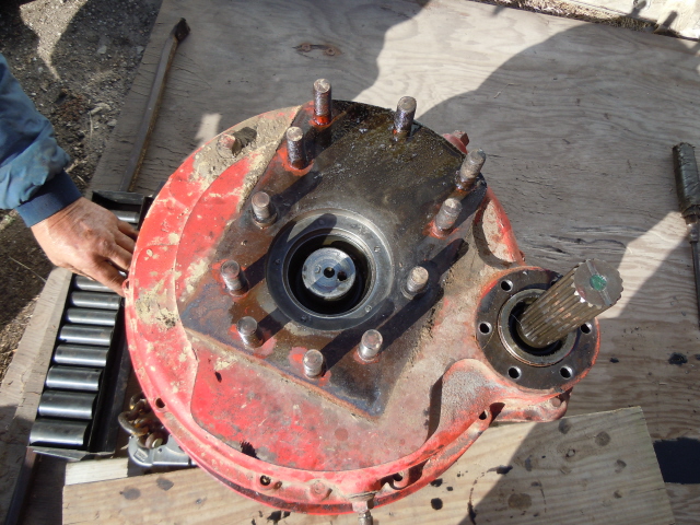

Tractors use single pump and single hydraulic motor because they use also gearbox with two or three ranges. Reason being that the maximum torque and rpm of the motor are not infinite.
I forgot to mention that for effective usage of the hydrostatic propulsion you have to have a speed governor on the engine. The hydraulic system will vary load on the engine in great range. You have to maintain constant rpm not only for life of the engine but mainly for proper function of the driven implements. Also consider mass of the tractor. Looking at specks of the tractors on the market you need in average about 100 lb/HP for effective pulling power.
I would like to add, as someone already suggested, that you should look for used tractor with a bad engine or cheap Chinese tractor and replace the engine with Corvair. That is if you need a tractor. If you enjoy the process of building it (and have money to blow) go for the full build. Possible source of pumps, hydraulic controls and motors are also combines. I was just involved in repair of a combine few weeks ago. The reduction gear, brake and wheel hub come in one unit easily removable from the frame. Motor stays bolted in the frame and connects to the reduction gear by short shaft.
