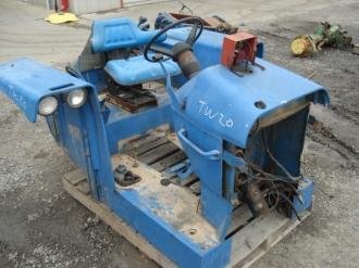

I'm looking into purchasing this New Holland TW20 Cab in the picture.
However, I like to see the size of the full tractor, with this platform, before I fully comit to the purchase.
Doing searches for used TW20 for sale; I have not been able to find anything like the one in the picture below. The ones I see have curved rear fenders and not flat ones.
Is this a TW20? (or did they mark it wrong)
Does anyone have a picture of this tractor?
Do you know what year it might be?
Also do you have any idea what something like this is worth? (they want $1,500)
EDIT - I forgot to mention I also put this post, about the cab platform, in the New Holland thread.
Thanks, Tony
