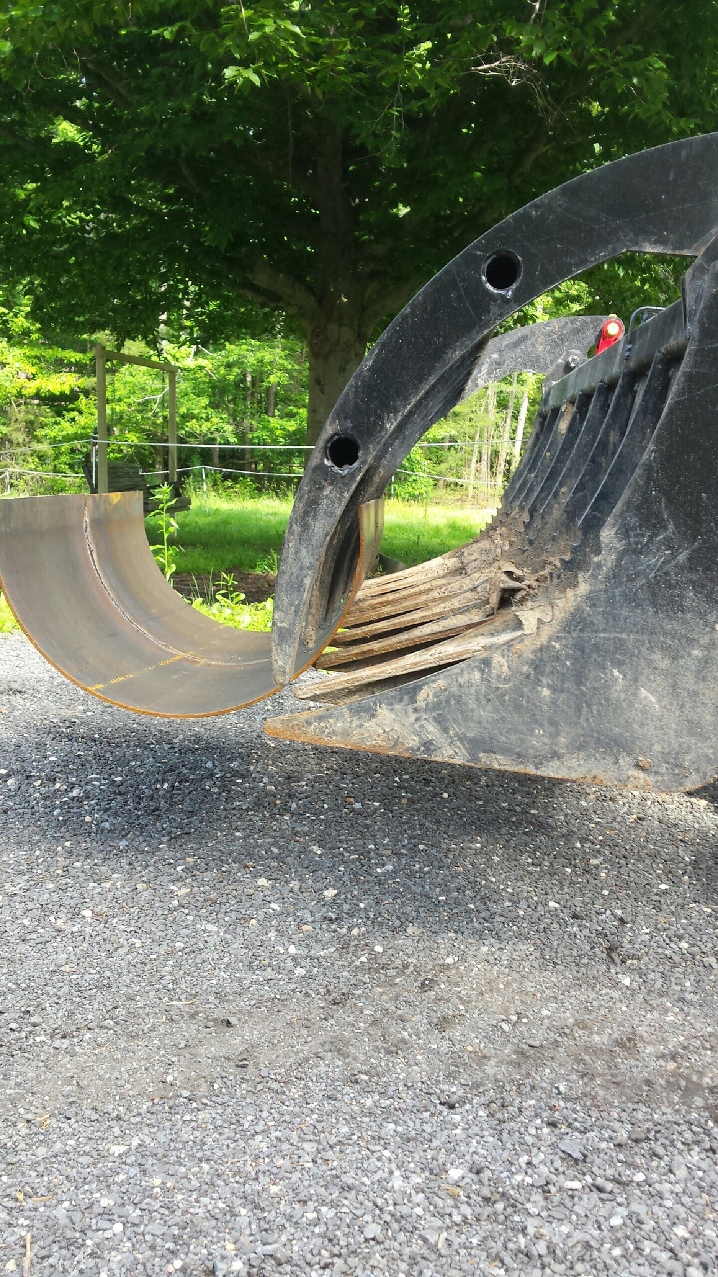

Almost like they used the wrong cylinder with not enough stroke. (except for the play) He doesn't still have air in the line's & cyl does he?
no air pockets, ran it on his and mine. originally thought it was a cylinder/stroke issue but have since ruled that out. took it apart and the pivot points are almost 1" with 3/4" bolts. the cylinders have 1" pins and the holes are almost 1 1/4". Have not heard back from wgaequipment or wildkat after numerous attempts. I have a fix in the works but was hoping they would step up.

It sounds like some brass bushings might be a good fix. Too bad you have to do instead of the vendor.

Now that's just plain sloppy! A new guy in "asembley" & no q/c? A couple of emailed pics of that to them should fix things. (hopefully)

spent part of today boring holes and pressing in sleeve bearings. The rake can now pick up and hold 1/4" stock. will have to add a picture later, dont see that option from mobile and my regular internet is down.

Well that is not the case here. Hopefully, you get to rely on gravity for your needs (or eat more wheaties :) ). Notice in the picture that the hoses are disconnected. The cylinders were fully extended. There is 5+ inches of play at the tips. Pivot points need some attention :thumbdown:. For reference, the tire in the background is 16".
Otherwise, the grapple rake is rather well built for the price. I tried it on my 86 hp skidsteer. dropped the teeth 4-5" into the dirt and pushed. Nothing broke, so......:thumbsup:
That is a clamshell grapple so gravity is your enemy not friend. Looks to me like they must have used the wrong cylinder size so the upper jaw just doesn't move far enough.
