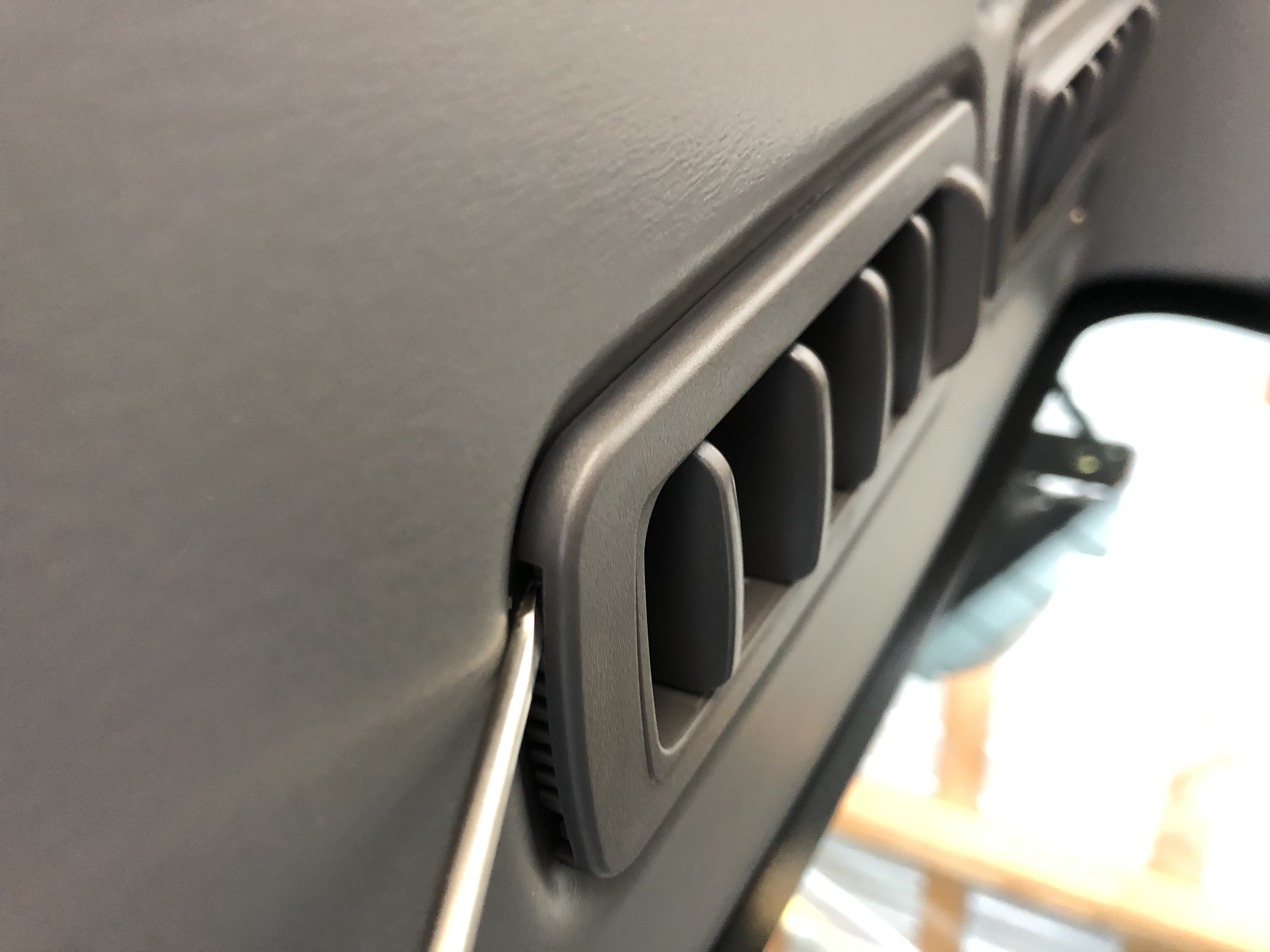

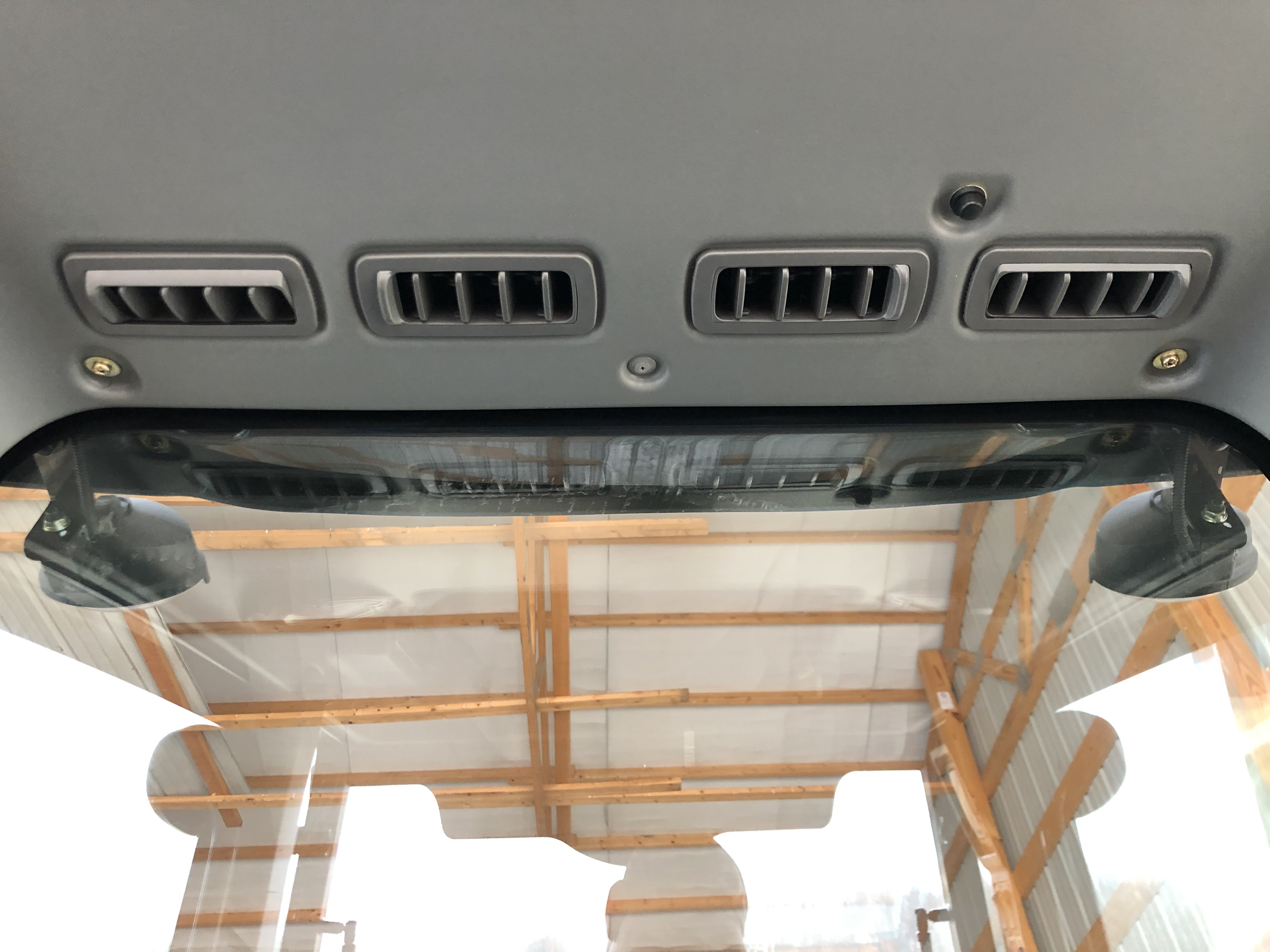

I always wondered why the left and right defrost vents are installed with the louvers adjusting to the middle of the cab verses being able to point them at the door glass.
Those have to be able to be removed and turned 180 so the louvers point the other way.
   / Defroster in Cab #22
I was coming here to say exactly that. I popped out 2 of the vents in the front, spun them 180 and snapped them back in. Also doing all the interior of the glass with anti fog helps a little.

Was there any trick to popping them out?

Any method or trick to doing this? I would hate to break flimsy plastic and no control where the air goes.
I think just gently with a slotted screw driver. There should be tabs holding them up. I did the outer two in the front and it only took a minute.

Very simple fix. There are two tabs on each side. Use a small flathead screw driver and push them inward. Then pull the vents straight out. Flip them around and reinstall.
   / Defroster in Cab
#29
Thank you for the replies! When I get a minute, I will certainly do this. I do believe this will fix my issues. When the tractor I mean. :)
