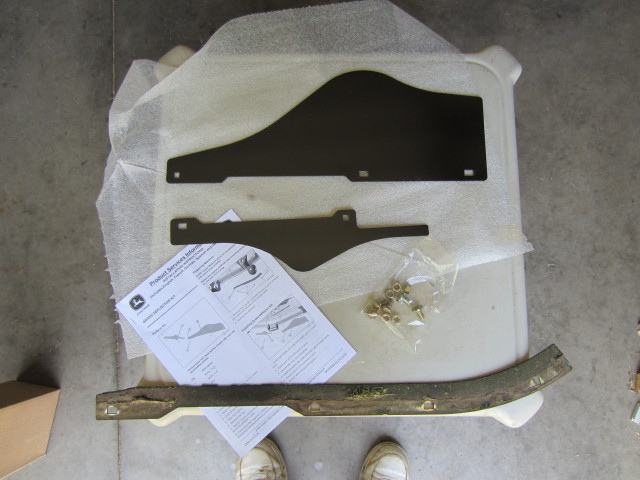

I have installed the "anti blow out kit" mentioned above. The picture shows what is installed and what is removed. It limits the light fluffy clippings blowing out from under the deck (mostly the left front). It has helped the amount of debris stuck in the screens and what I breathe.

what size mower deck is that kit for. I had to make my own last year because nothing was available from deere for my 54 inch deck.
   / Deere site reviews indicate the X754 has overheating issues. Why not X750 or X758? #27
My kit for the 62" deck was #AM133766. The above link for the #AM133765 kit shows it is for the 54" C and X decks.

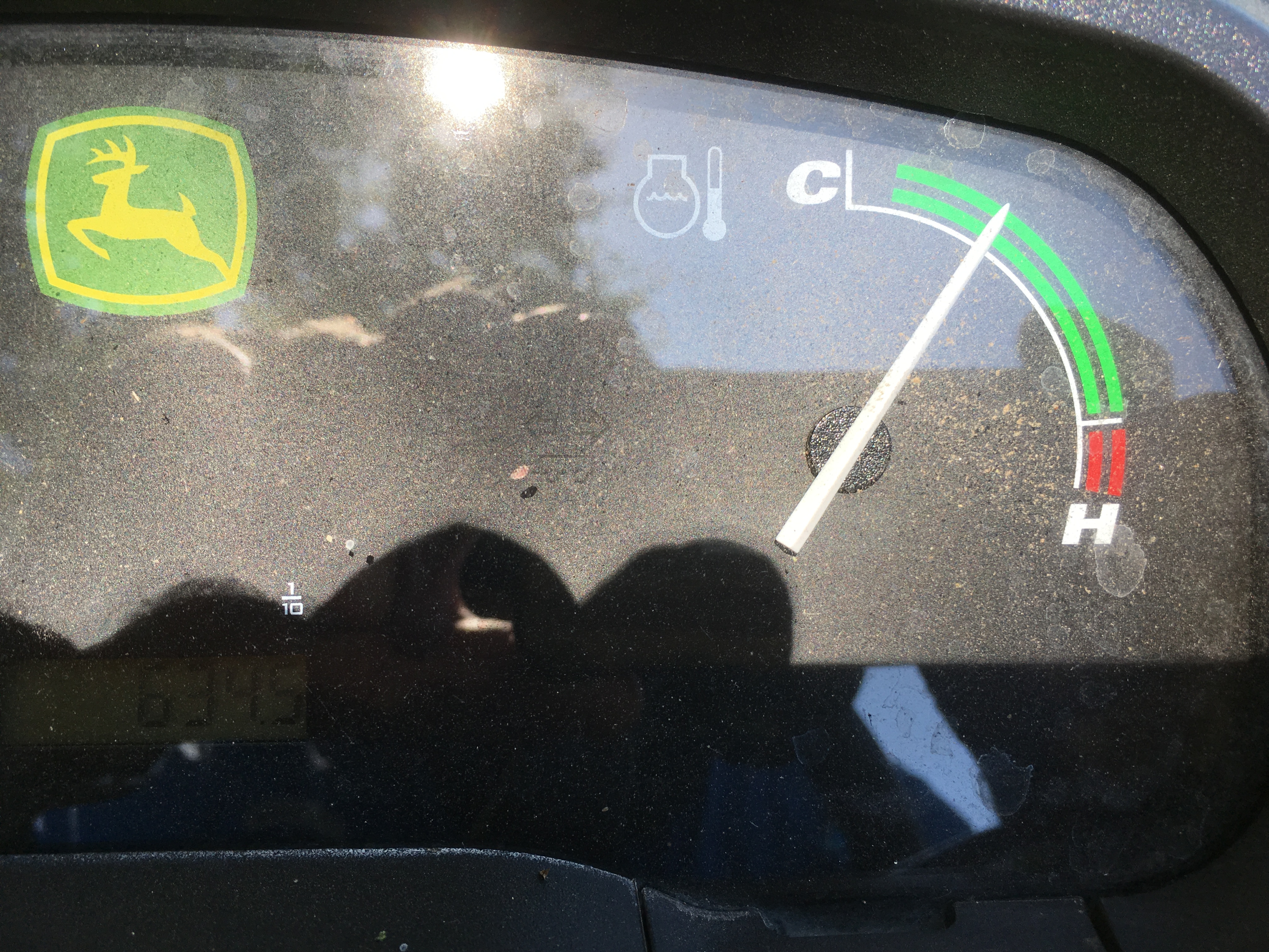

I finally remembered to do this.
Here is where my X750 temp gauge sits, doesn't move for anything,
not once in five years has it gotten any higher than this, mowing hours on end in 90+ weather.
Is this what the rest of you are seeing?
