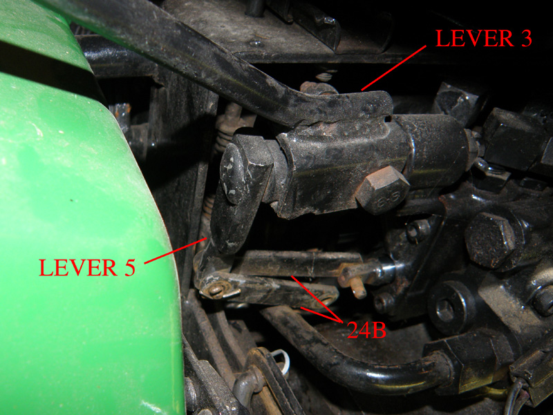

is my eyes deceiving me? is there a weld crack on the lever?
Good eye! It does appear to be such, but it's just the photo. It may just be where the welder went a little deep with the heat, or perhaps it has been eaten away by rust. This tractor had sat outside from 1986 - 2009'ish. The previous owner removed all the sheetmetal, blasted everything, repainted, and reassembled with new or reworked sheetmetal. Evidence of its former condition is everywhere, but he did a pretty good job with it.

I have an older JD755 with a JD70 FEL and was having problems with raising the loader boom (controls for curling the bucket and lowering the boom were OK). The problem began about two years ago when raising the boom became intermittently sluggish, and then recently it became nearly impossible to raise the boom. I first thought the hydraulic quik-connect was the problem (it turned out to be OK) and then I thought the SCV need to be rebuilt. I then came across this discussion and discovered that I had the same problem as described by WinterDeere (the lever (part 5) that is supposed to pivot in the control arm block (part 3) was frozen/corroded). As suggested, I used a generous amount of Liquid Wrench and vise-grips to un-freeze these parts. I did not disassemble the linkages or try to rebuild or replace any of the linkage parts, but I did lubricate all other parts of the SCV mechanical linkages as shown in WinterDeere's attached diagram. All boom/bucket functions now operate perfectly! Thanks to all for this very helpful discussion!
