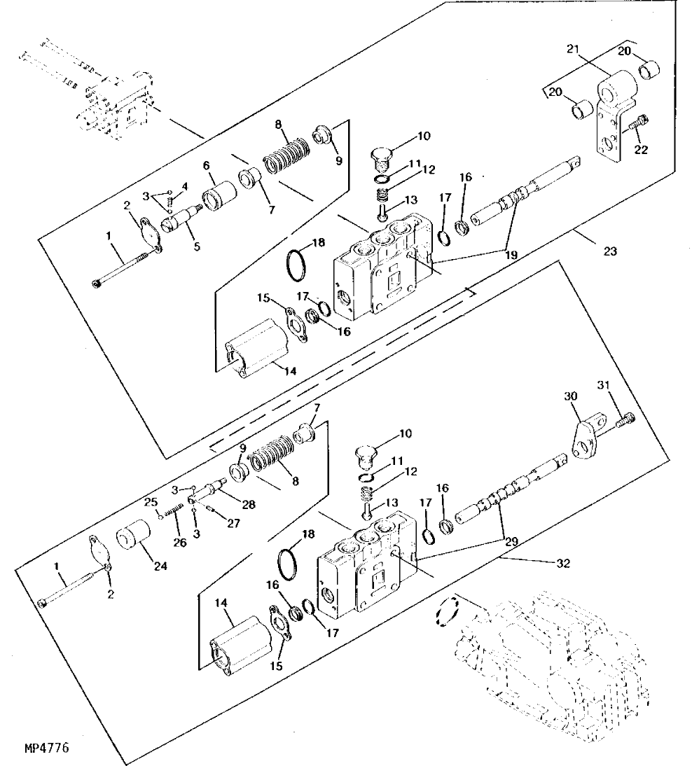

The detents are attached to the rear of the valve, opposite the linkage:
SELECTIVE CONTROL VALVES (FLOAT AND REGENERATIVE) (55 SERIES ONLY)
SELECTIVE CONTROL VALVES (FLOAT AND REGENERATIVE) (55 SERIES ONLY) (CONTINUED)

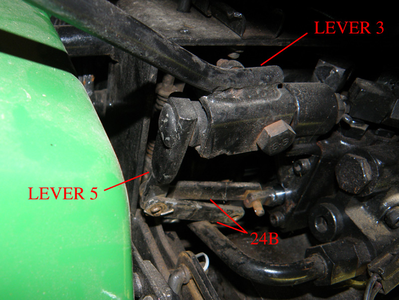

Okay... found a few minutes to pull the sheetmetal and inspect this evening. Problem appears to be simple. Referencing the diagram I posted above, lever item 5 is not pivoting wihtin the block at the bottom of control lever item 3. So, when I have the tie straps item 24 connected, I'm unable to push the control lever far enough forward to float the bucket. If I disconnect tie straps item 24, the float works just fine. Unfortunately, trying to force it over the last several months has likely put a lot of undue stress on the actual valve piston, but being a Deere... it took the abuse.
Can someone with a working control lever please confirm that lever item 5 should indeed pivot in the main block at the bottom of the control lever item 3? Mine seems frozen, such that lever 5 always moves fore/aft, when you push the control lever fore/aft.
Getting at this was not difficult. You crank up the mower deck height control, remove the four screws from the plate that holds the mower deck control, and lift that panel out. Then you remove (unscrew) the knobs from the hi/lo range and pto selector levers, and reach under the fenders to remove the four screws holding that panel in place. A little finagling, and that panel comes out, then you can get at this linkage pretty easy.
   / Deere 855 bucket float
Just to make things clearer, here's a photo of what I was discussing above. Here, I have one of the tie links (24B) disconnected, and all works well. When I connect both tie straps, things are over-constrained, and I can't get the lever into the float position. It seems to me that if lever 5 was able to pivot in that block at the bottom of lever 3, all would be good. Mine seems frozen, but I'm guessing it should pivot.
