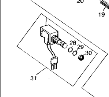

My knowledge of JD ind tractors is very limited but I do understand closed center hyd's. I don't understand the need for a steering charge pump on closed center hyd system. Turning steering wheel back & forth during starting process relieves pressure buildup and to my knowledge was originated by a JD representative not a farmer. What indicates destroker valve is operating correctly? Have you checked voltage to it? How did you check it's operation? It sounds to me that the de-stroking valve is inoperable.

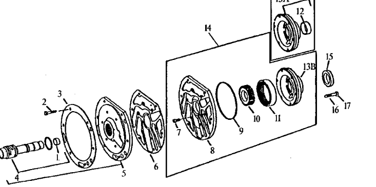

Below is parts schematic of for 710C trans pump

Thanks, TxJim, as I said, I am not up on the Industrials, especially the one that did not "morph" from AG tractors.
