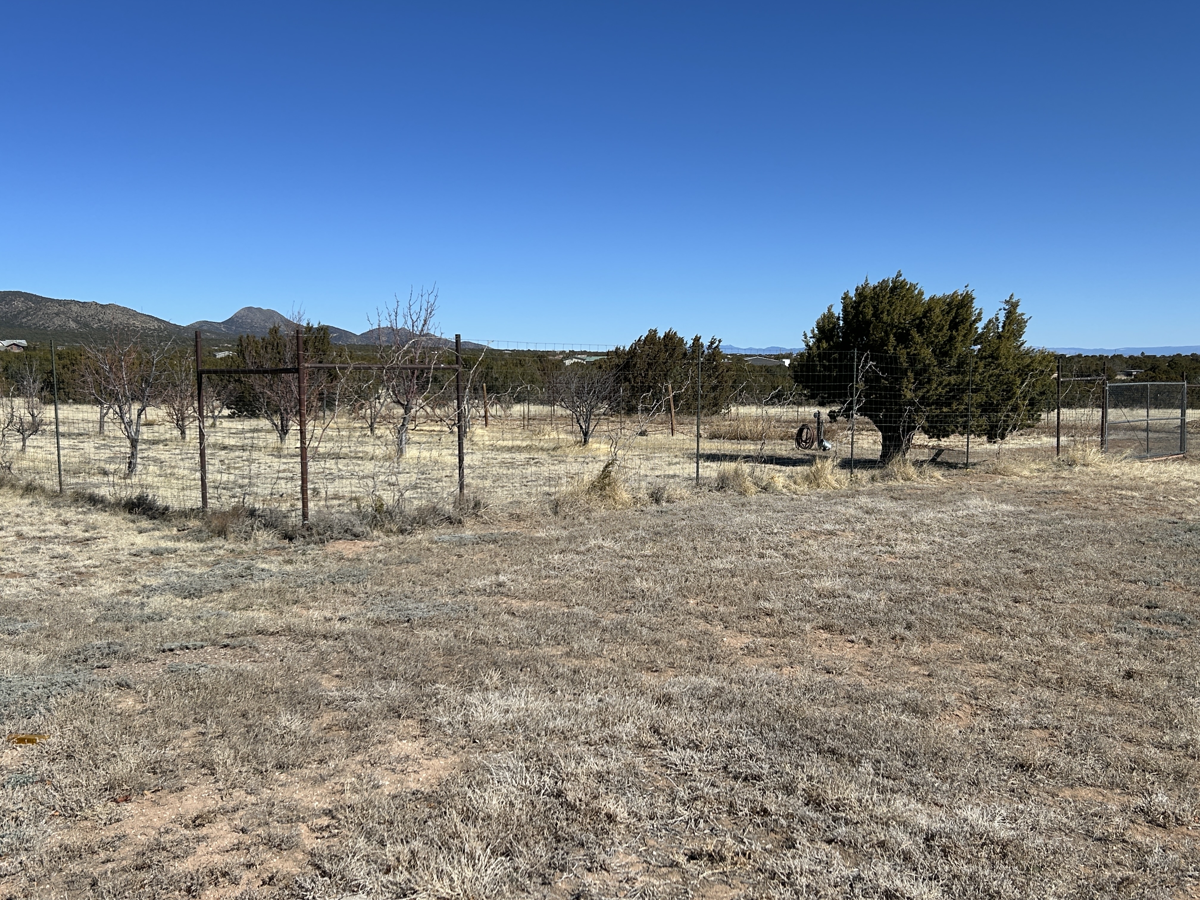

My solution wasn’t easy, but it absolutely works to keep deer away. I constructed a one acre field fence 8.5’ high around my orchard and garden. It was a bit of work, but it’s been working perfectly for about 8 years now. The big gate has a wheel to support it because it’s 12’ wide and 8’ tall.
