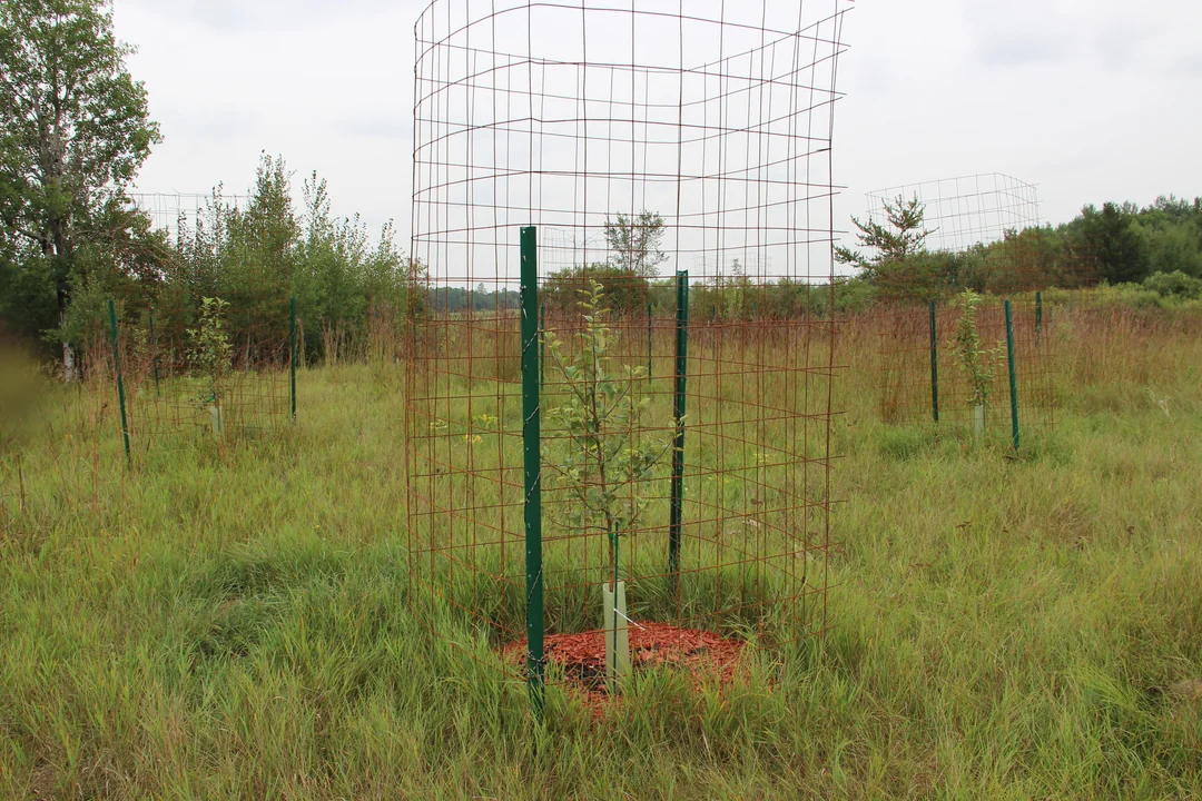

If the fence is so close to the trees, it has to be taller; I've seen larger fencing schemes for gardens and orchards which don't require super high fences but instead two fences one outside the other, both short enough that the deer could jump either, but it can't jump both and they don't want to jump into a small space between. If you have too big a space underneath, deer can also go under...
So, similar with your tree rings - if close enough to the tree to nibble, must be tall enough to keep them off; but put it a few feet from the tree and a 5' fence would probably manage! I went with 6' rings when I had the deer issue, used cheap 2x4 welded wire.
Not my pic:
If you use a wire with a bit more structure, and stake the wire down to the ground in a few spots, you can do without the fence posts, though the fence posts may come in handy to keep the tree growing straight (I usually don't bother; my trees come up straight enough). I use a 2' piece of #3-4 rebar which I bend the last few inches over into a fairly tight hook - stick the end of the rebar into the pin hole of the truck receiver hitch and then pull - and then you can use the rebar as a stake and hook the top over some of the fence, not the very bottom or you'll have a hard time finding & getting it out later. Three such stakes for a smaller circle, four for a bigger one, don't need a fence post unless the fencing is super wobbly (like chicken wire).
A few years later, I ended up putting a good perimeter fence around the whole property and took the tree rings down and sold them on CL, recouped a bit of the cost, plus I had no use for a big stack of 20' sections of fence...
