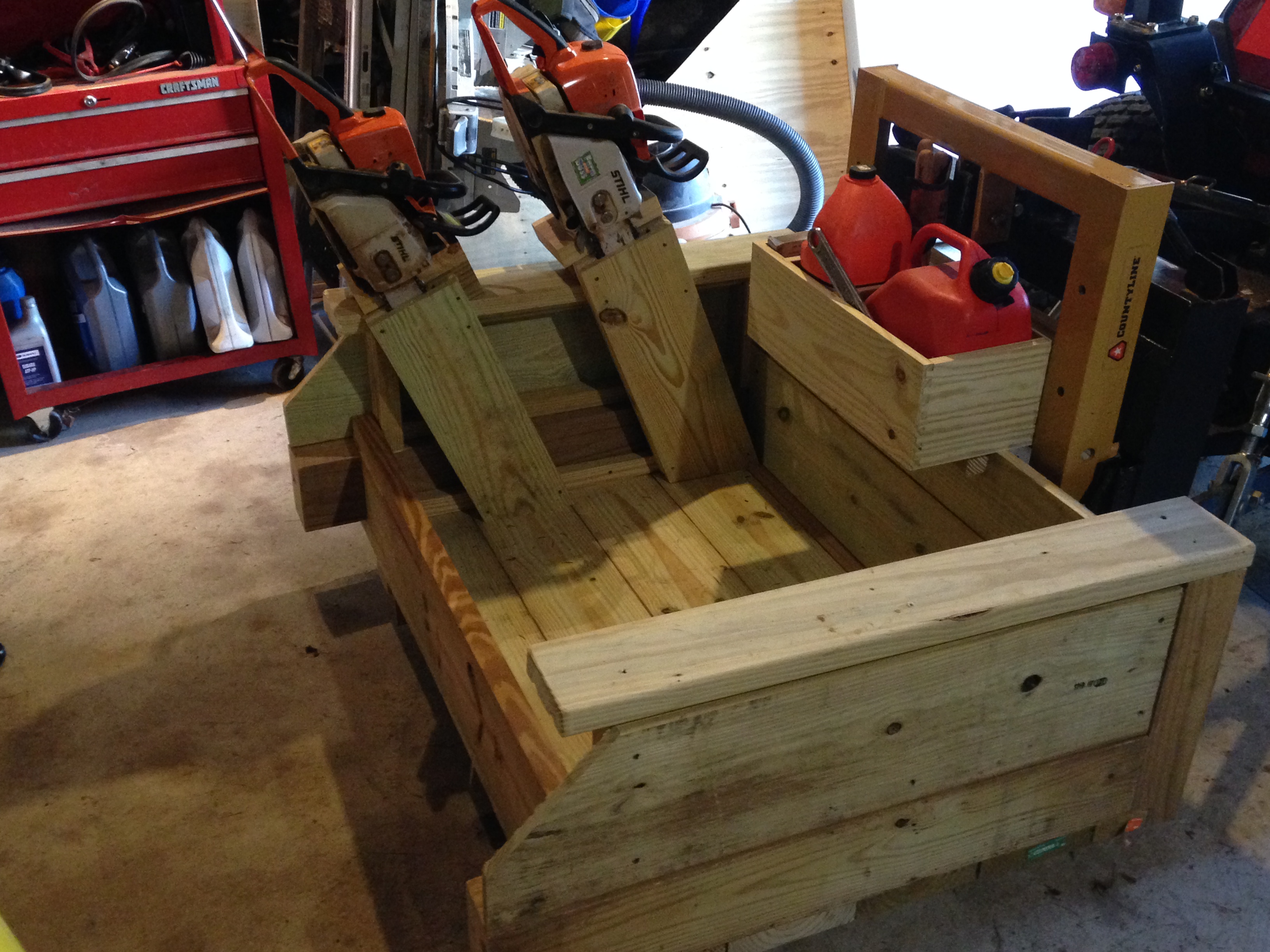

Here's mine, don't have any thoughts on the unrolled but I've incorporated the chainsaws and a tool box. I also added casters to the bottom. The casters are great for shuffling the carry all around the garage IMG_0011.JPG
/ Dedicated Carry-All setup for fencing?
Here's mine, don't have any thoughts on the unrolled but I've incorporated the chainsaws and a tool box. I also added casters to the bottom. The casters are great for shuffling the carry all around the garageView attachment 505888
Thanks a lot for the pic. That's kinda what I had in mind. I really like the saw scabbards.:thumbsup:
