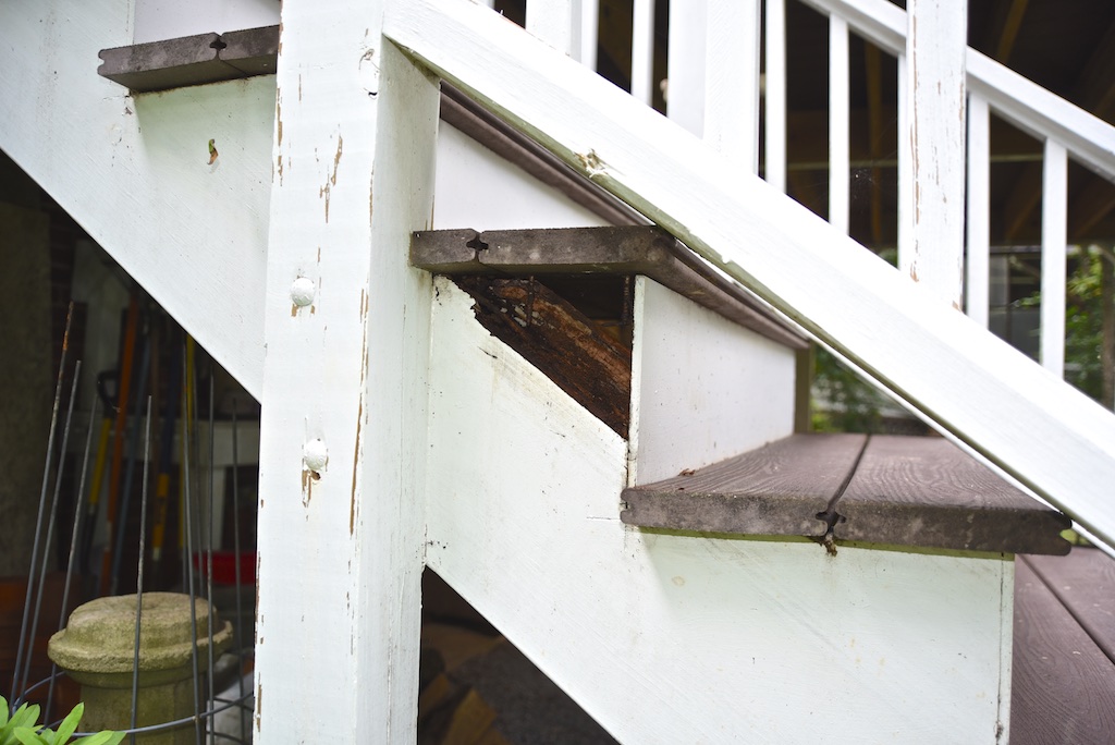

I had my grandmother's house remodeled about 4 years ago. We added a screen porch on the back with stairs leading down to the back yard. The stairs have 4 treated lumber stringers. The treads are made of Trex. The risers are faced with Hardi-plank. I noticed the other day that the outside stringer had three places that were totally rotten. I mean black and falling apart. Each of these spots was the triangle shaped area of the riser/tread. No termites. The outside edge of the stringer is painted.
The other stringers are fine. The entire stairway is uncovered.
Now this seems strange to me. The outside stairs on my cabin that I built 11 years ago are still okay. They don't look great and will need replacing but that is ten years verses four for these stairs at home.
The only thing I can see that might be a clue is that the carpenter that cut the stringer made the cuts where the riser and the tread meet with a circular saw (which is normal) but rather than finishing the cut with a hand saw he extended the cut into the stringer in both directions with the circular saw. To me, that's just lazy and sloppy but I'm not sure if that is why this stringer rotted so fast. Maybe this extended cut was a site for water to get into the wood? Any thoughts on this?
I can fix this but it is going to be time consuming. I'll have to remove all of the Trex treads as well as the Hardi-plank riser facing. The Hardi-plank is nailed in to it will crack and shatter when I remove it and it will all have to be replaced. This will not be an easy job.
Our contractor was VERY expensive. I wanted the best workmanship. Granted, it has been four years and there is no written guarantee on his work four years out but this does not speak well for his work. I'm wondering if I should call him?

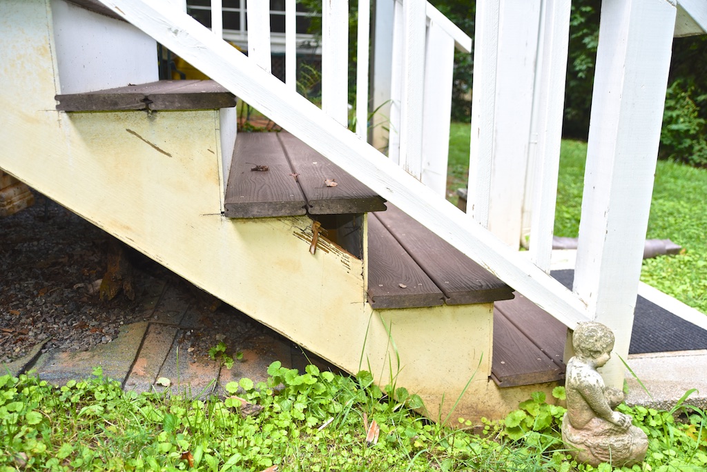

A few answers to questions. Air circulation is good. The Hardi-plank riser fronts are cosmetic to match the rest of the screen porch. Only the outside part of the wood is painted. Exposure to water is from rain only. Gutters in good shape. I have provided no care, paint, washing or stain for the stairs other than a light pressure washing just before I discovered these rotted areas. But as mentioned the other four stringers are in perfect shape. Yes, all four stringers are treated. Yes, they do contact the bare ground at the bottom. Areas of rot are up high. Most of the rest of the affected stringer is fine, including where it contacts the ground. All three areas of rot are the "step" area. And when I say rot, I'm talking poke a hole in it with my finger and it disintegrates.
There are scraps of treated lumber from my cabin that have been lying in the woods for ten years that have not rotted this bad.
If it isn't the extended cuts (which weaken the stringer even if they are not an entry point for water) then the only other conclusion is that it was just a bad piece of lumber. And I would agree that treated lumber is not what it used to be.
I'll provide some pictures when I get a chance. I think the bottom line is that I've got some work to do.
I did see one of those tree house shows where the guy building the tree house used sticky sided water impervious membrane on every tread side of the stringer before he put the actual tread on it. This was in Seattle or somewhere like that and we don't get that much rain here (not much rain at all this summer) but the humidity is commonly 80-90%.

While I wouldn't have thought it possible, I'm pretty sure the problem is caused by the Hardie blocking air flow under the steps. I think you have created a pocket under your treads that never dries out.

Could be Eddie. Maybe I'll leave the Hardi-plank off. It will be easier and cheaper. Looking at the picture and the actual steps I'm quite sure it wasn't the cuts made in the corners. I still don't approve of that technique but don't think it caused my problems.
