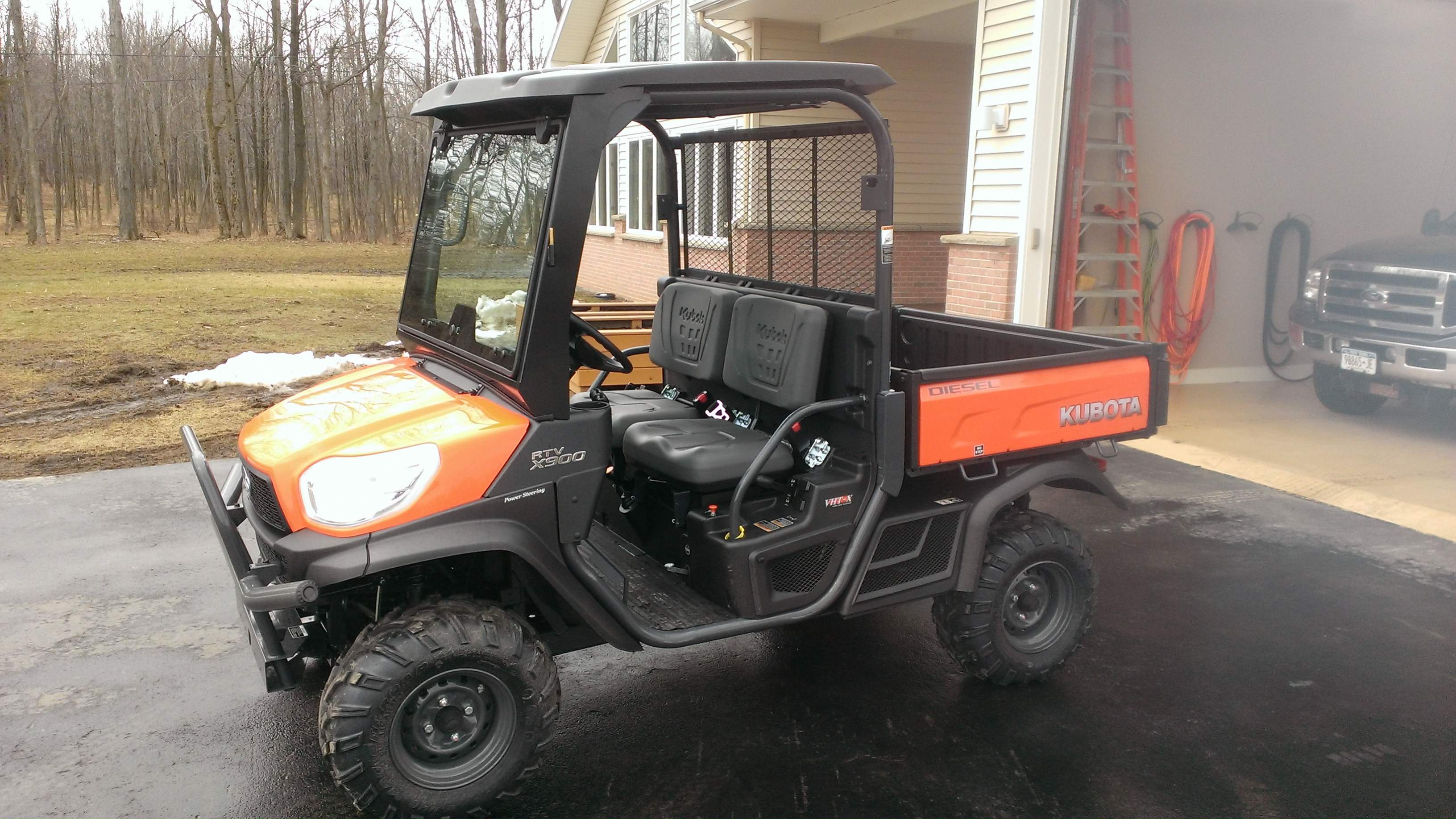

$15,000 got me a brand new 2014 RTV-X900-W-A, factory sprayed on bed liner, Plastic bed insert (V5229), Glass (VC5025) (not poly) wind shield, Hard (VC5011) (plastic) roof & delivery.
Nice machine overall except the stuck shifter problem, which is getting picked up today. With the 2014, they fixed the de-accelerate problem of letting off the gas too fast causing your face to hit windshield. There are some aftermarket solutions to this for earlier models. The radiator was moved upfront under the hood. Previous models had radiator below the seat susceptible to getting covered with mud and causing engine overheat & failure.

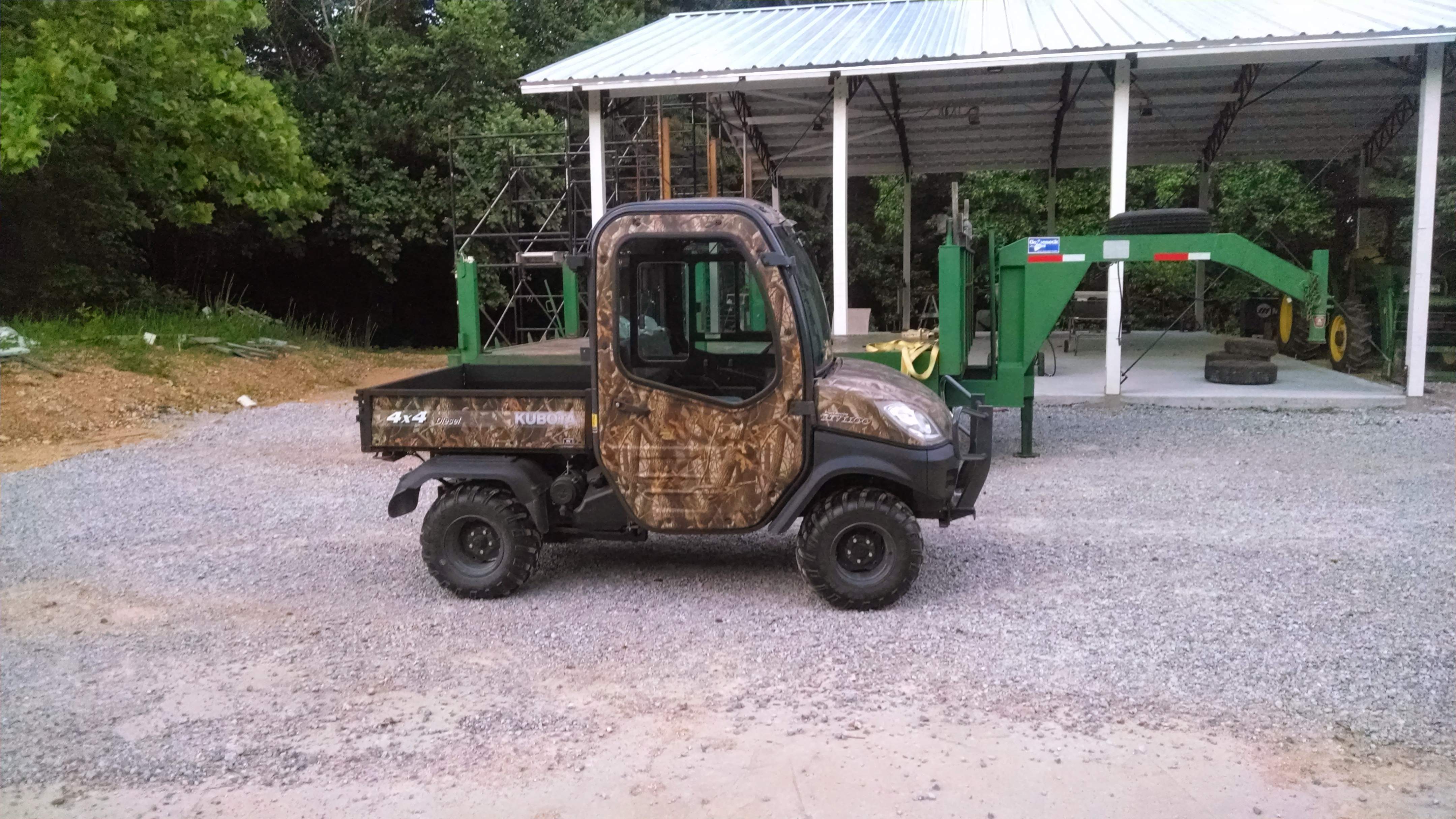

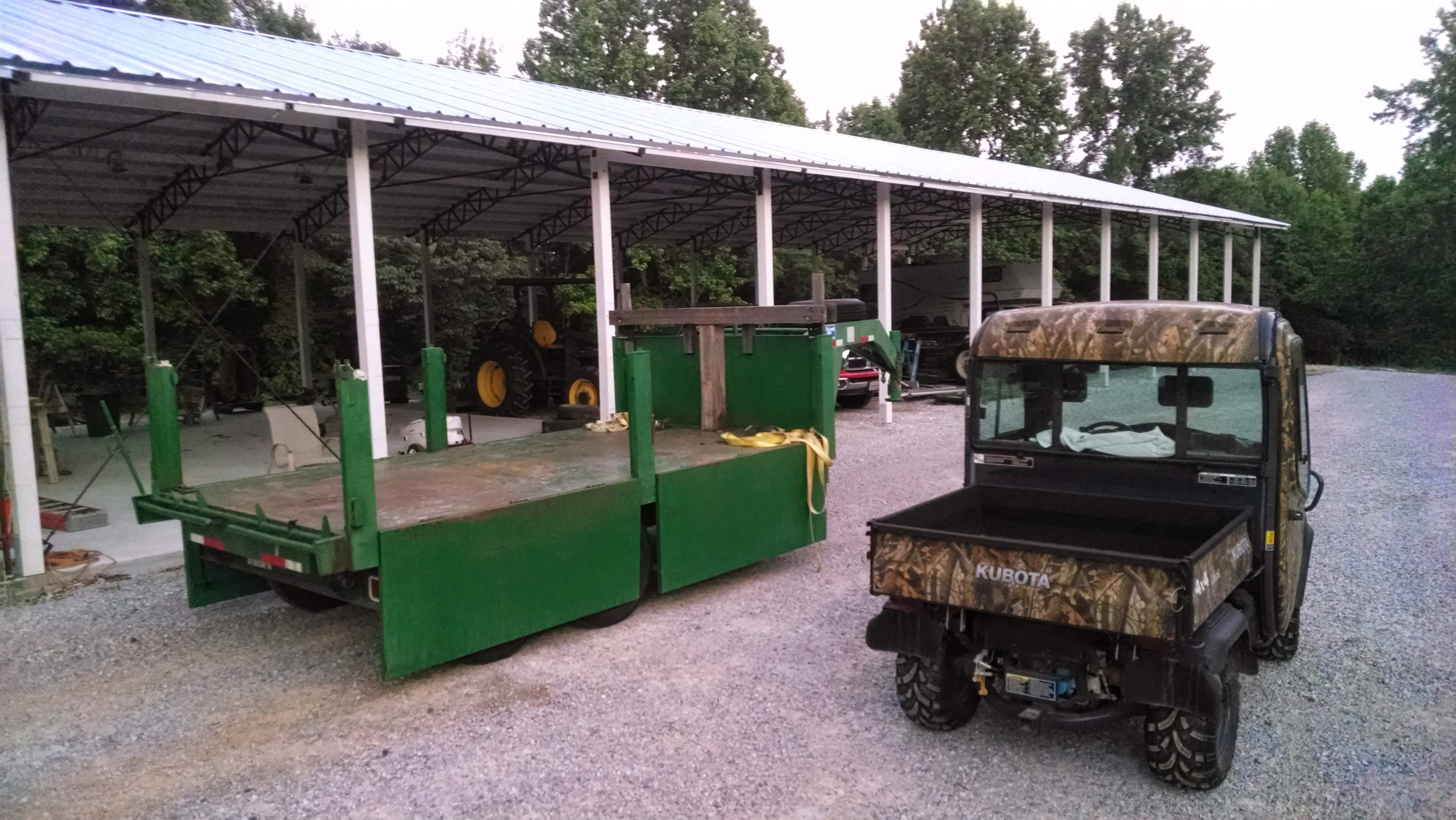

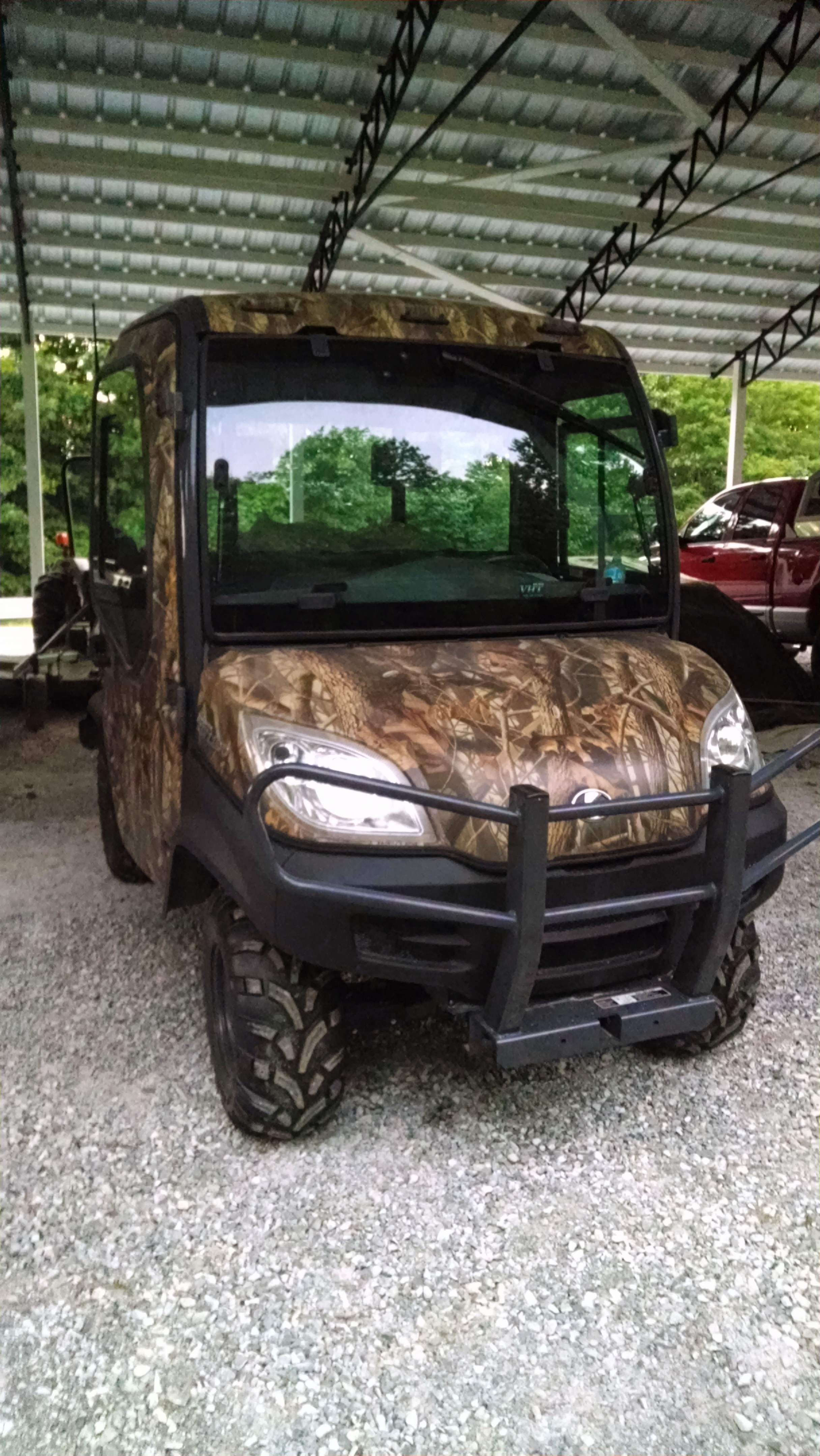

Well,
we made our way to Arkansas to pick up the new 'bota. I am going to try to post some pictures. I fabricated some steps to make it easier for my wife to access. I had a stainless stair tread left over from a project so I cut it in half and welded some 2" square tubing to it to fit into a 2" receiver tube at each side. I bolted them to a channel on the frame. I can post pictures if anyone is interested. Seat covers come in today!
